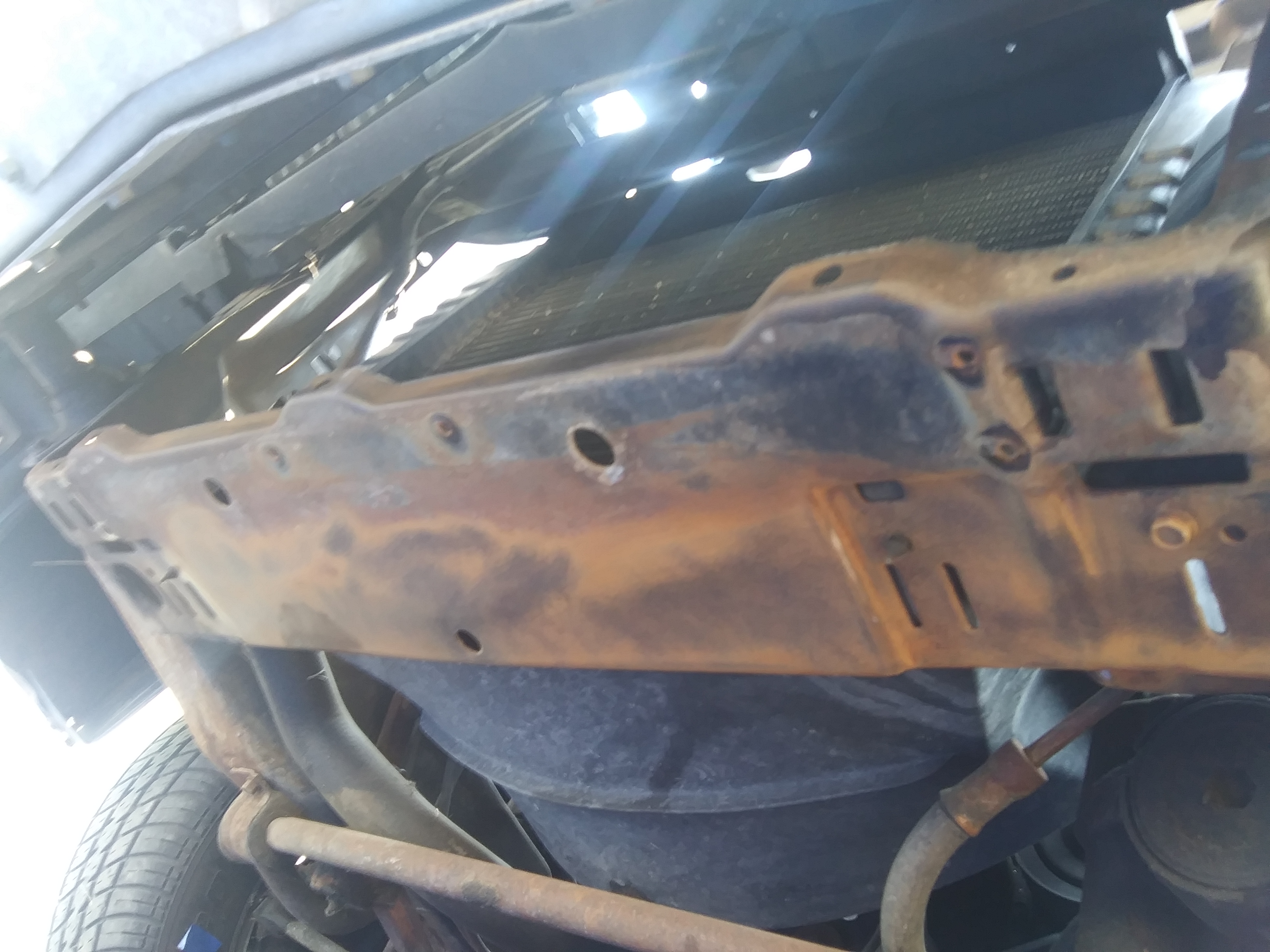

Here a shot the best I could get anyway of the underside of the Core Support. Cleaned up and Truck bed lined.

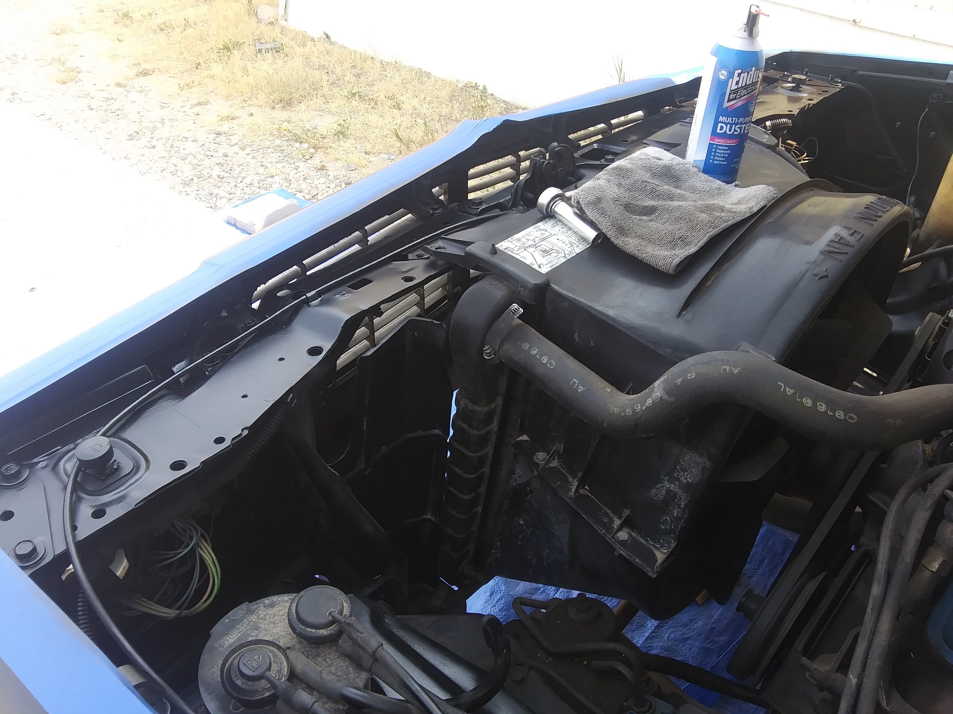

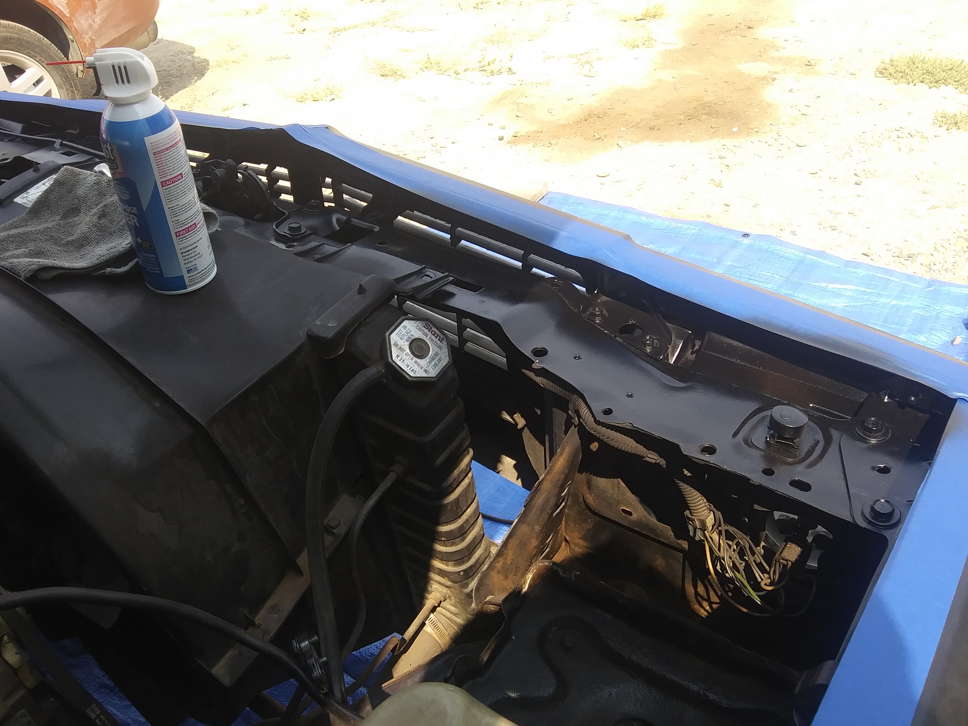

Core Support got a fresh coat of paint on top after 2 coats of VHT. Battery Tray is now rust free and coated.

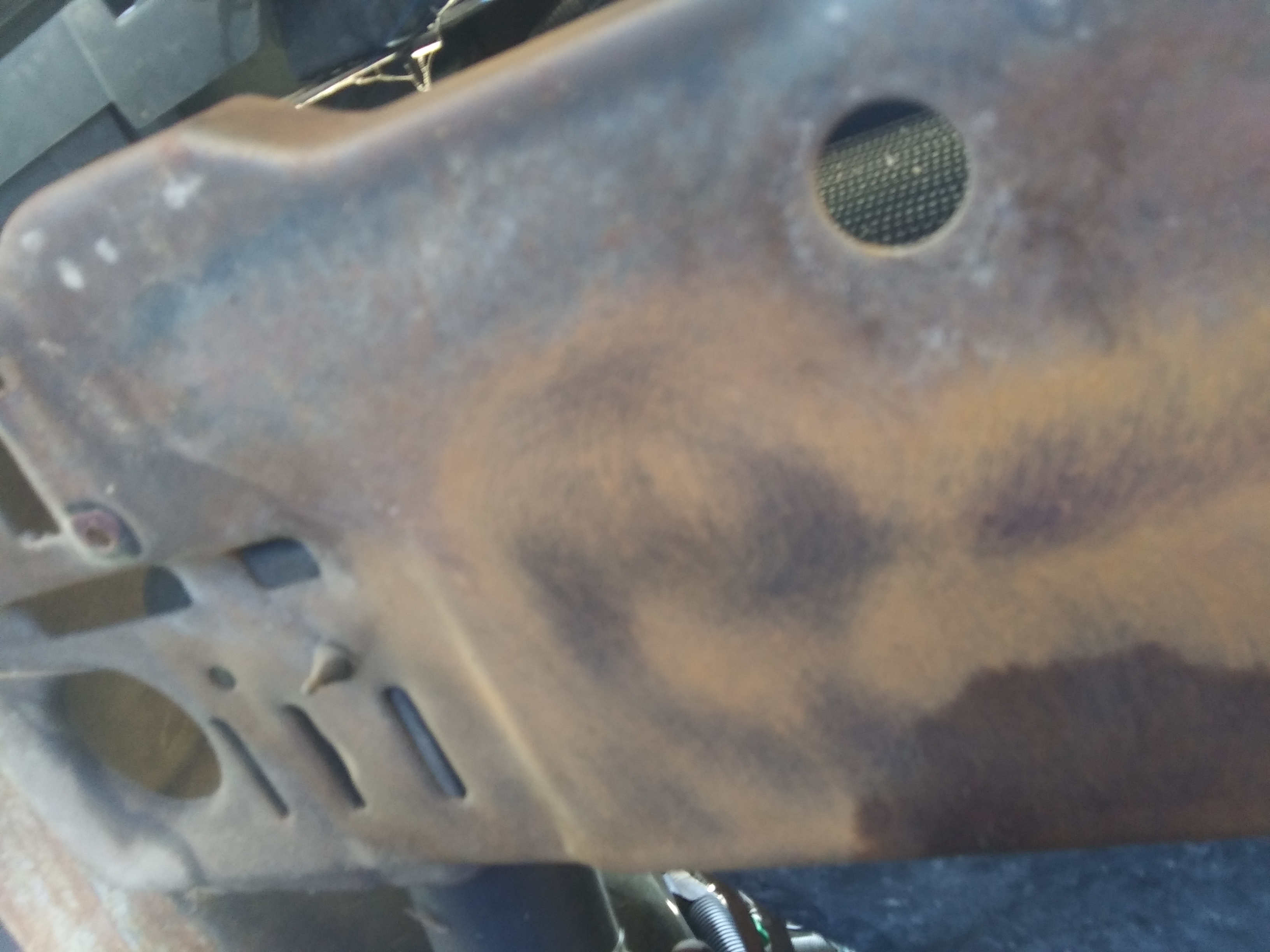

Now for the challenge. I can't for the life of me remember what the protective guard piece I took off underneath is called, but its off and I have wired brushed and sanded all this you see here away, it is Rust treated for protection but I am going to have to get more Truck Bed Coating.
Mostly all I see is surface rust, much of this at least in the front I have gotten too.

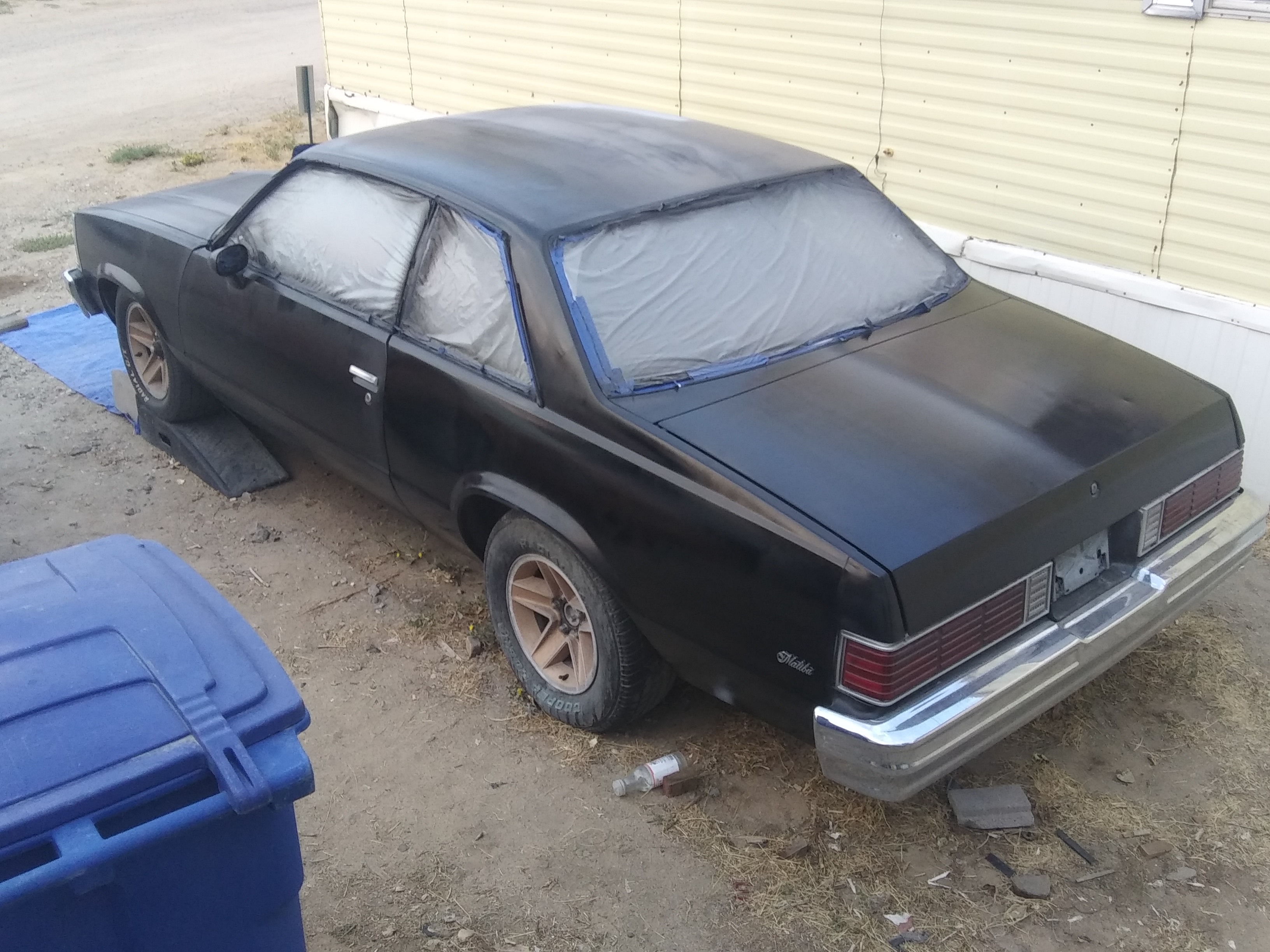

Body is slowly getting clear coated. But today the paint is just giving me a fit with so many fixes I have go back and take care of. I stopped to cool down, and go underneath to deal with the rust.
