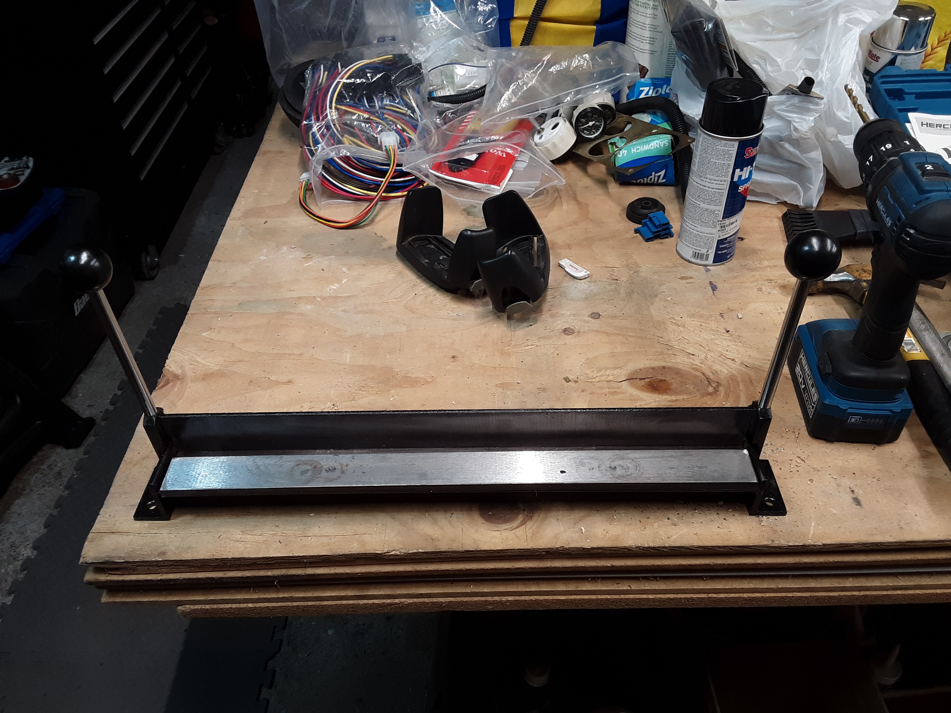

You could probably sell those if they actually hold a drink. Where do you put the cup?Went to Harbor Freight today and picked up an 18" bending brake for a small project.
Simple tool, did the job I needed. Inexpensive too. It will come in handy for other things in the future.
So here is what I made with it.

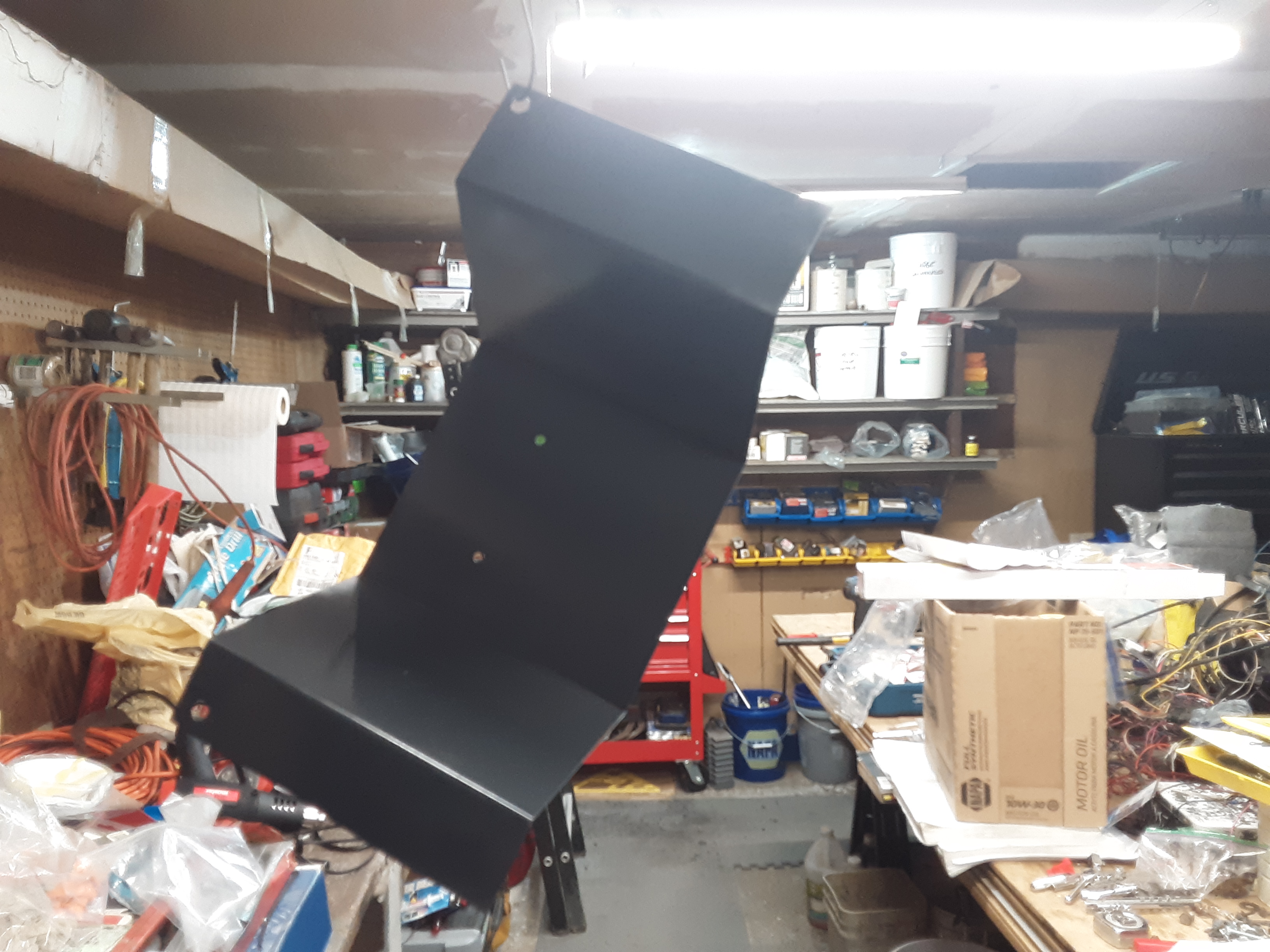

Since I completed the dash and venting portion of my heat only to AC conversion, I no longer have cup holders. This will be a long-term temporary (until I find something suitable for permanent installation) over-the-hump mount to fasten two cupholders to. The two holes at the outer corners will slip under the seat brackets and over the front seat bolts.
Pictured hanging in the garage to dry, I have one coat of rattle can primer on it. I plan on another coat tomorrow, then a semigloss finish coat in black also.
The two holes in the center section is where I will bolt the cupholders to, there will also be room to the rear to create other add-ons if desired.You could probably sell those if they actually hold a drink. Where do you put the cup?

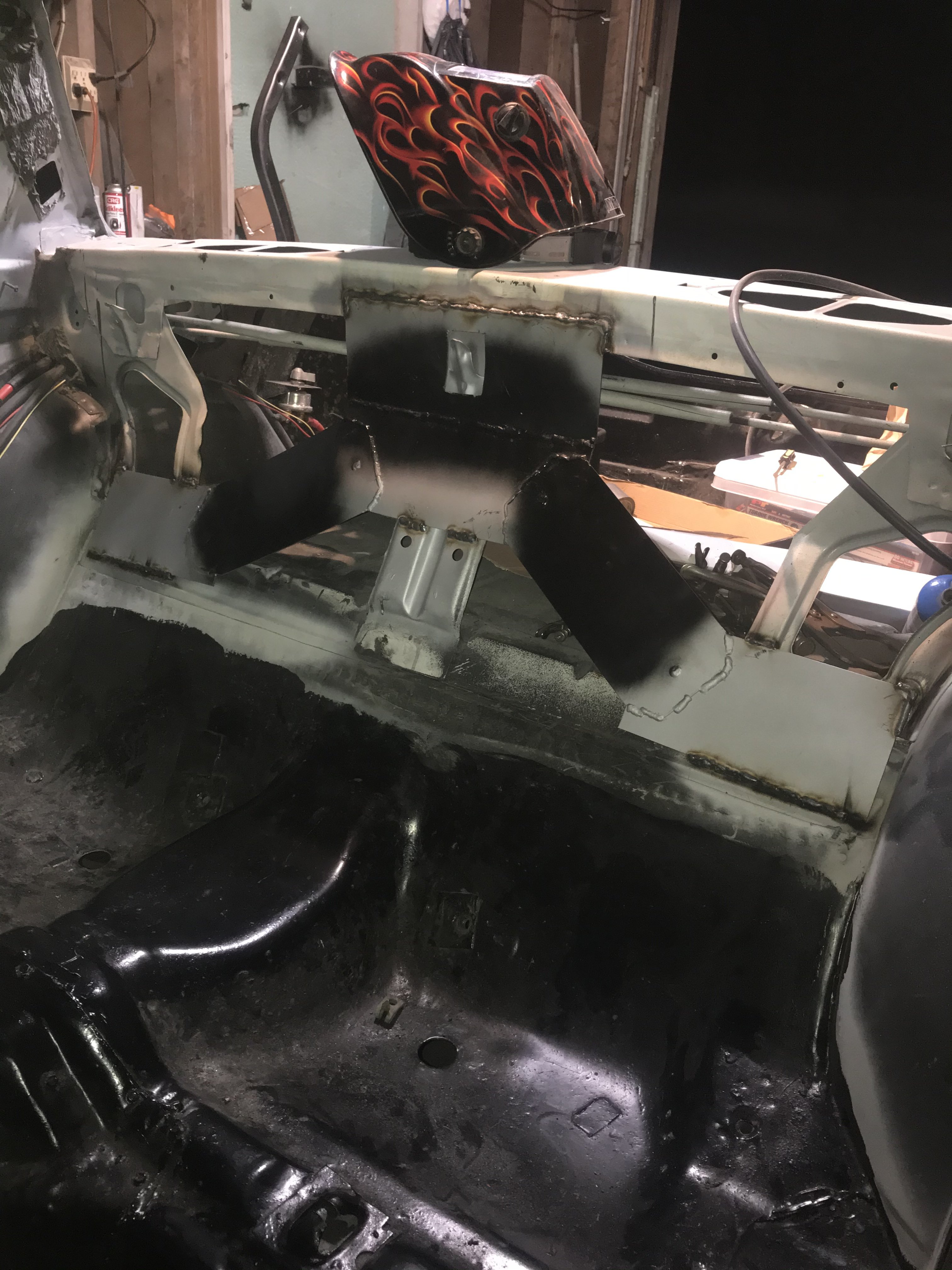

Well, the welds look like trash, but they’ll most definitely hold. I just have to drill a couple of holes in it and weld nuts on it for a rear firewall, which will probably be 2 pieces if I can get away with it. Both NHRA and IHRA rule books are unclear on the matter.
A small PSA if you’re installing one of these braces, I welded the brace legs to the bottom of those outer structures and found out really quickly those were stretched in the stamping process to 20 gauge, and not 18 gauge like the rest of the metal here.

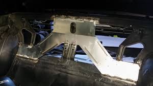

It’s like the bolt in X braces but heavier, I’ve seen claims that this style of brace is a night and day difference, some that it doesn’t do all that much. I wanted to add some stiffness to the body to help reduce the chance of B pillar crack, like the X braces do.Interesting idea, I am curious as to how much that adds to rigidity? Where did you get the idea?
I got the idea from the Tinman brace Kirban sells:
But the $200 price point drove me away. It was hard to tell where exactly the Tinman brace gets welded, but it makes more sense if it gets welded to the trunk floor instead of where I welded mine.
The material set me back $48 but I ordered 1 extra sheet by mistake. It’s 14 gauge CRS 5 inches wide and was 48 inches long.
