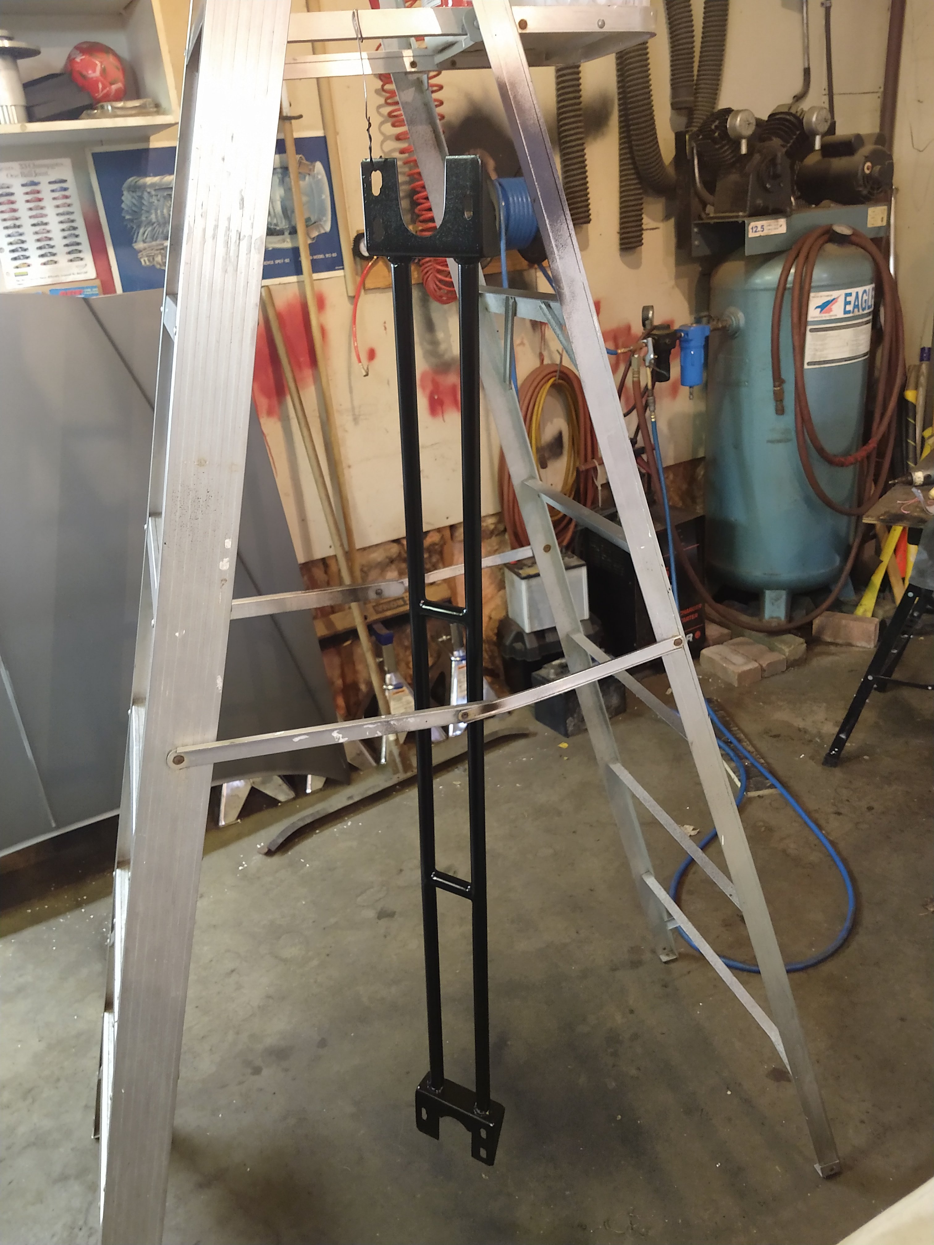

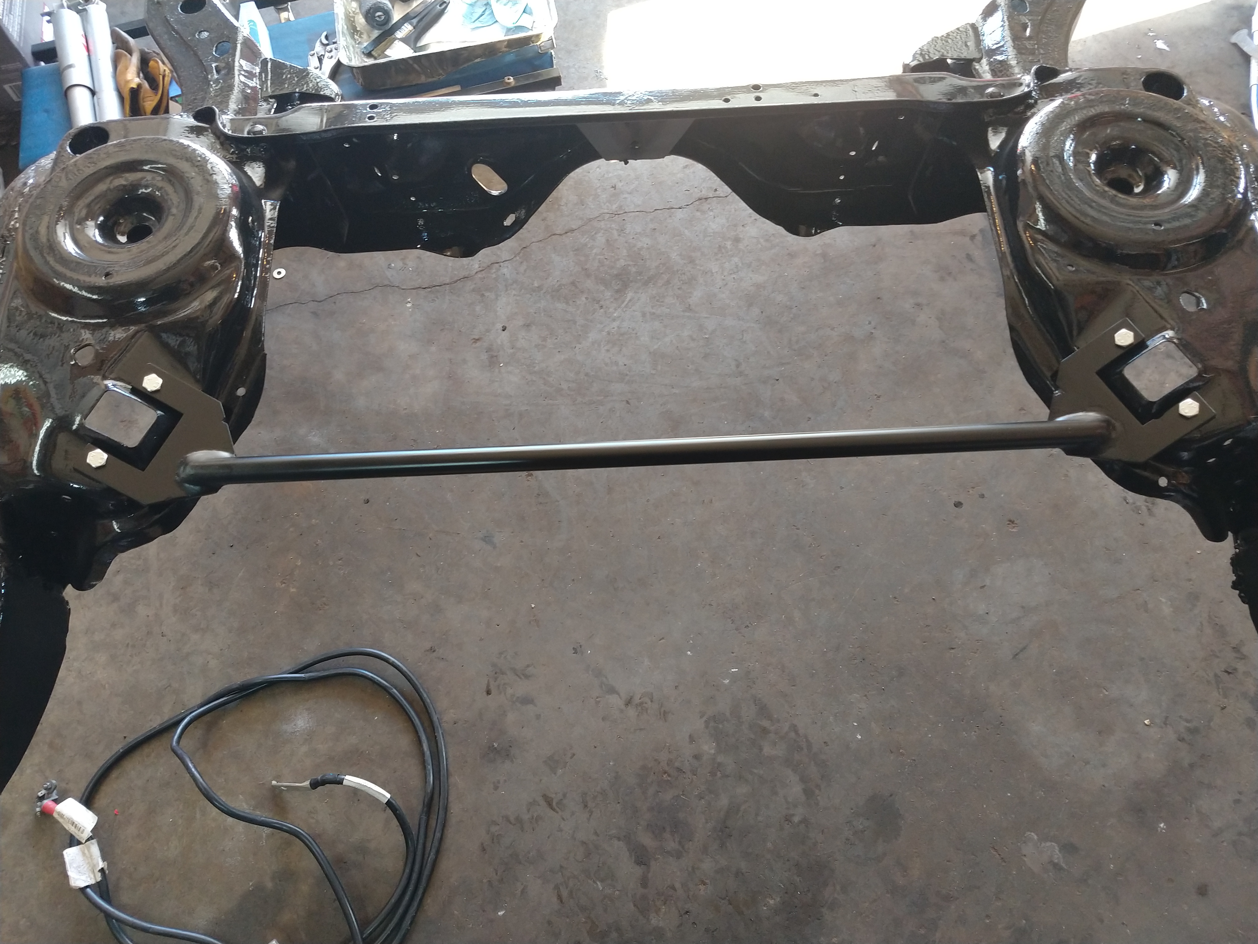

Made a shock tower brace yesterday from some material I had laying around. It's only 7/8", 1/16" wall tube so it's not as strong as the UMI one but with my rear frame brace I made I think it will do just fine.
View attachment 136646View attachment 136647
that is nice work you did, have you considered tack welding floating nut plates to make it easier to install the shocks?
Great idea, I've never seen those floating nut plates before, going to have get some. 👍
we used lots of them on aircraft.....we used 3/32 flush rivets to install them. They deform the bolt threads to lock them but they are resuable, they use them on most the access doors on aircraft and when the door is removed the screws or bolts are bagged to reuse
