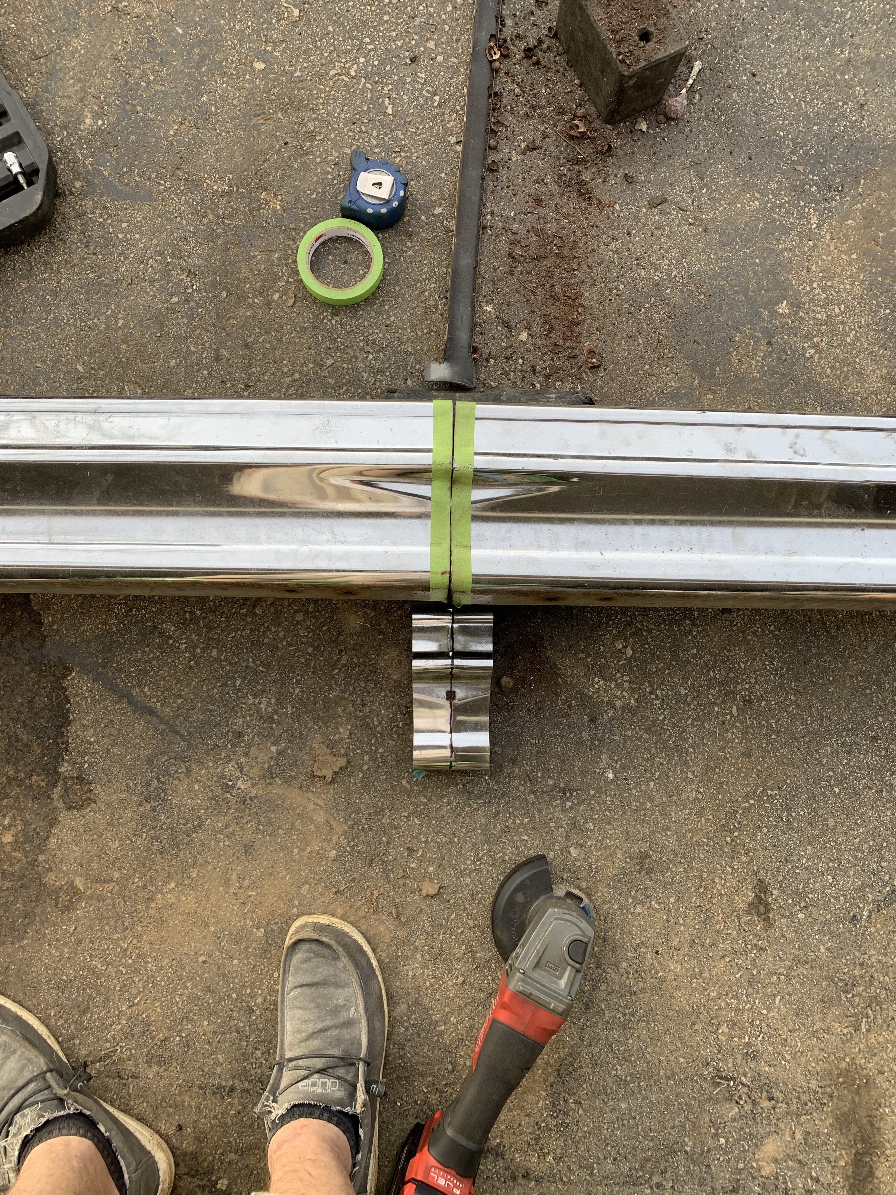

Working on the bumpers today front is almost done then on to the rear

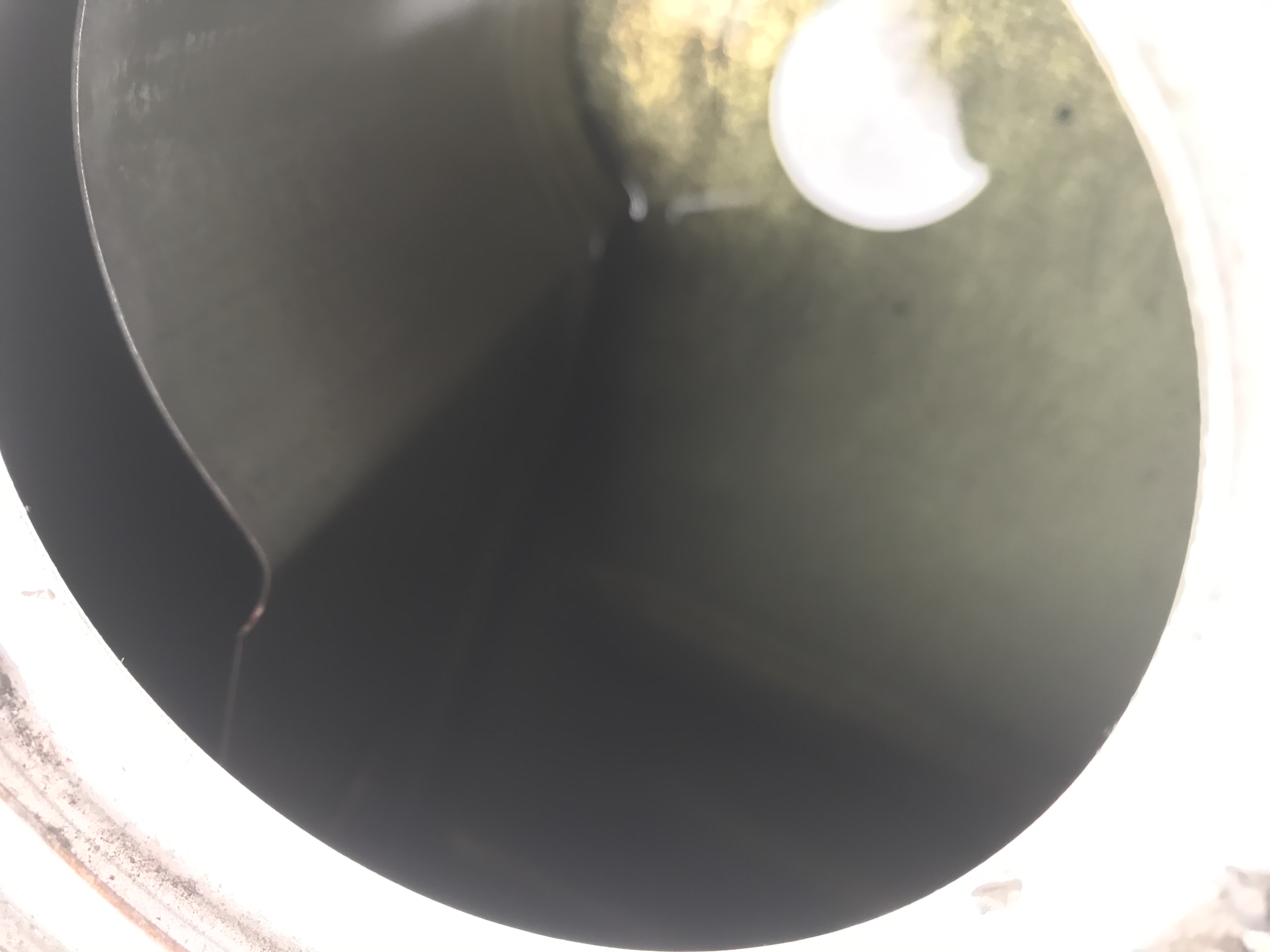

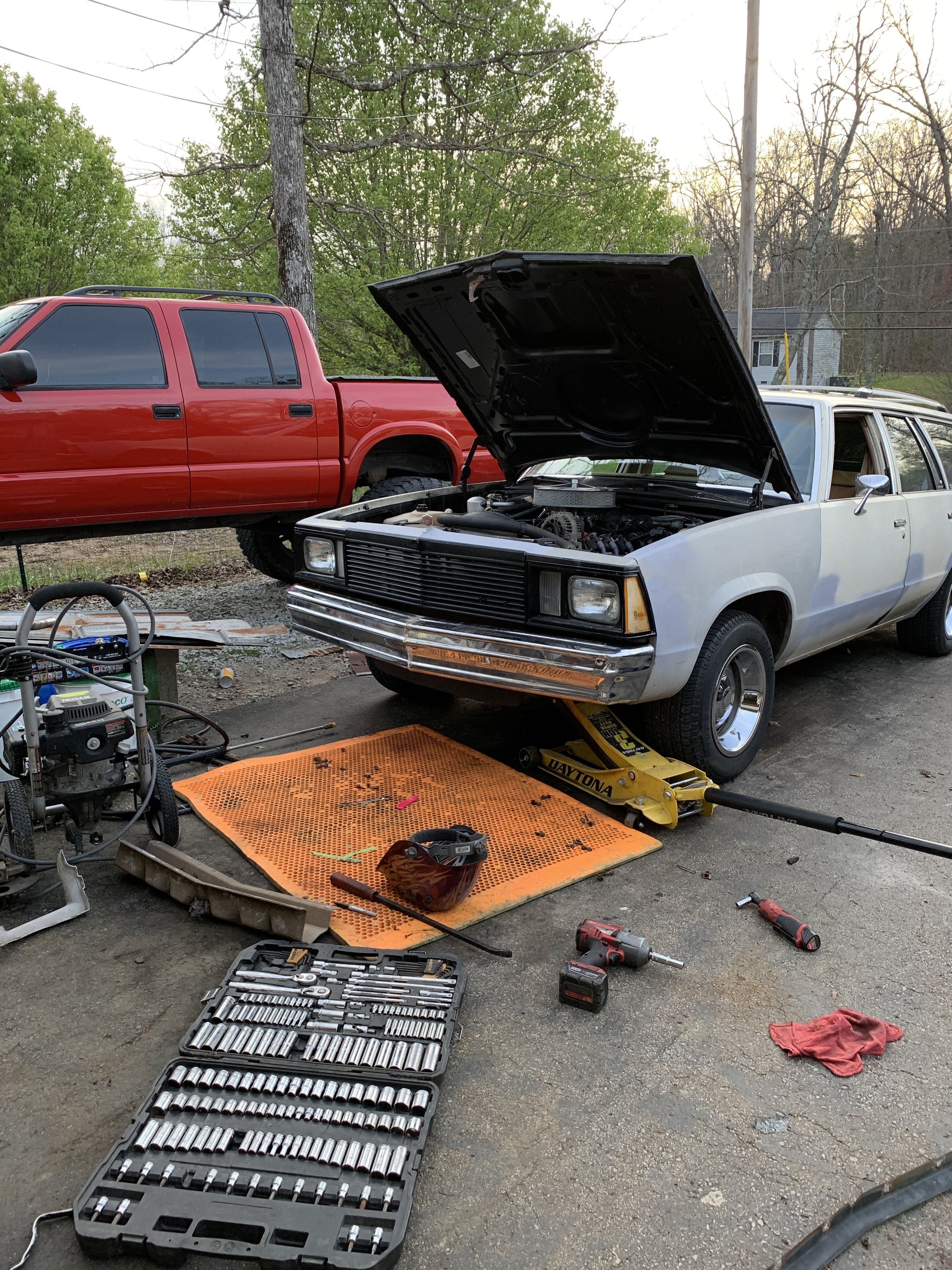

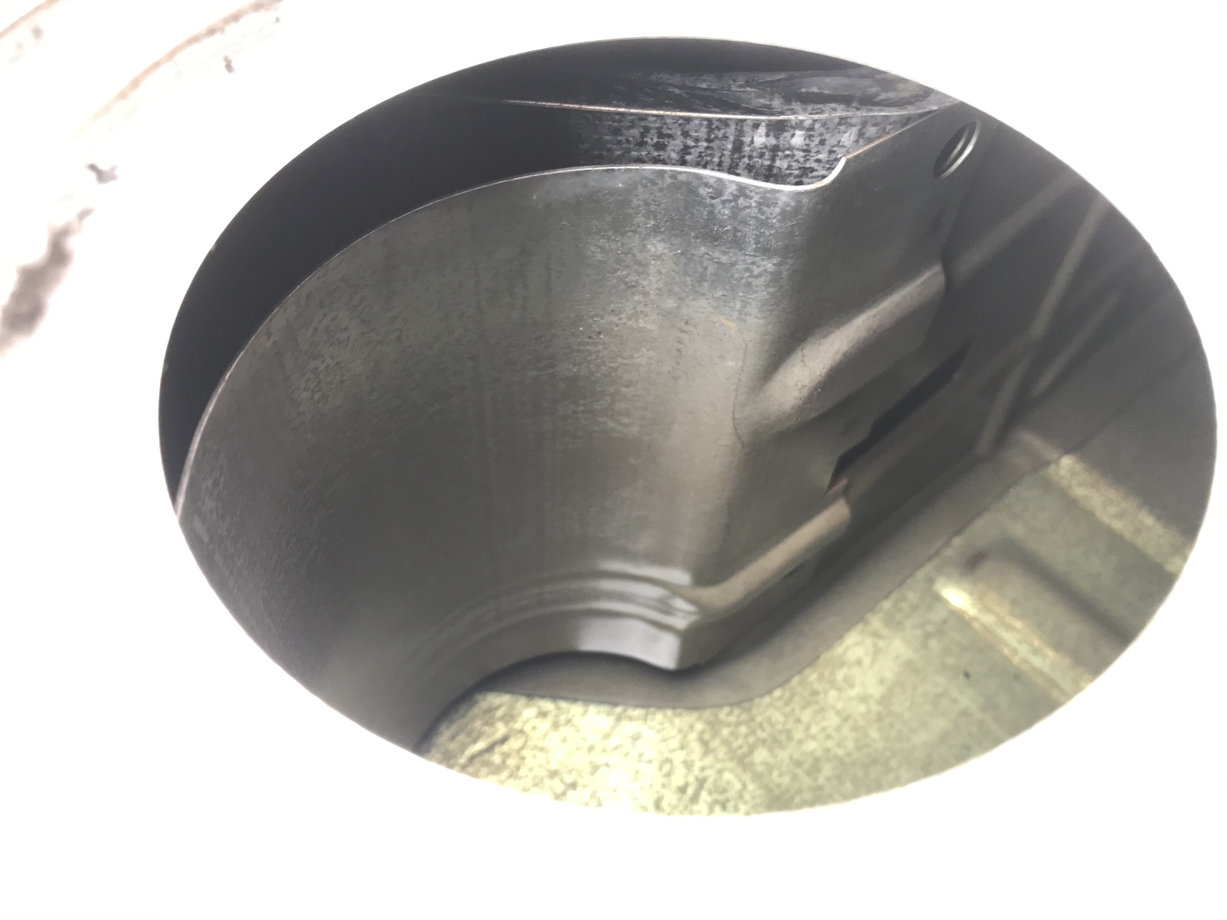

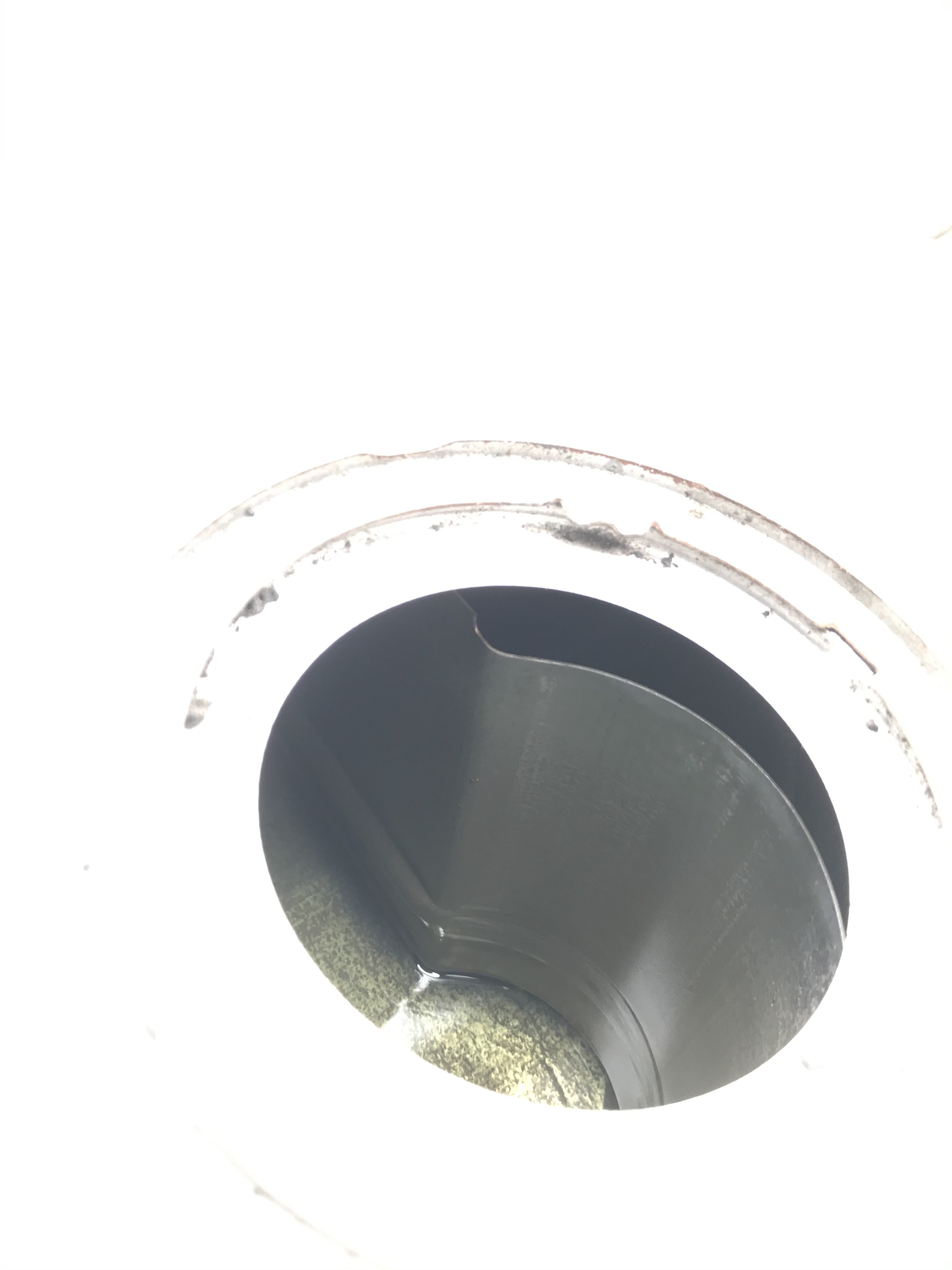

I put my car on stand yet again( I feel like it spends more time on stands than on the ground). I wanted to pull the tank. I found some junk in the regulator and carb. I wanted to clean the tank out. I was also going to take the time to cut off the old exhaust hangers as they welded to the frame. Well I pulled the sender out and I found the tank was very clean inside but I found what looks to be a baffled tank. My old 84 cutlass did not have these baffles.It has me wondering what tank this is. 0249B4B9-AD32-44A3-A5FC-D7987BC28CBD.jpegA5529AD7-A1C5-419F-B9CD-69ACE3D170AD.jpegA41B95C8-6364-4A85-9EC1-44696237AD8F.jpeg
I put my car on stand yet again( I feel like it spends more time on stands than on the ground). I wanted to pull the tank. I found some junk in the regulator and carb. I wanted to clean the tank out. I was also going to take the time to cut off the old exhaust hangers as they welded to the frame. Well I pulled the sender out and I found the tank was very clean inside but I found what looks to be a baffled tank. My old 84 cutlass did not have these baffles.It has me wondering what tank this is. View attachment 141436View attachment 141437View attachment 141438
My 86 has the same thing. I was very surprised at how clean mine was, it’s about as clean as yours.
