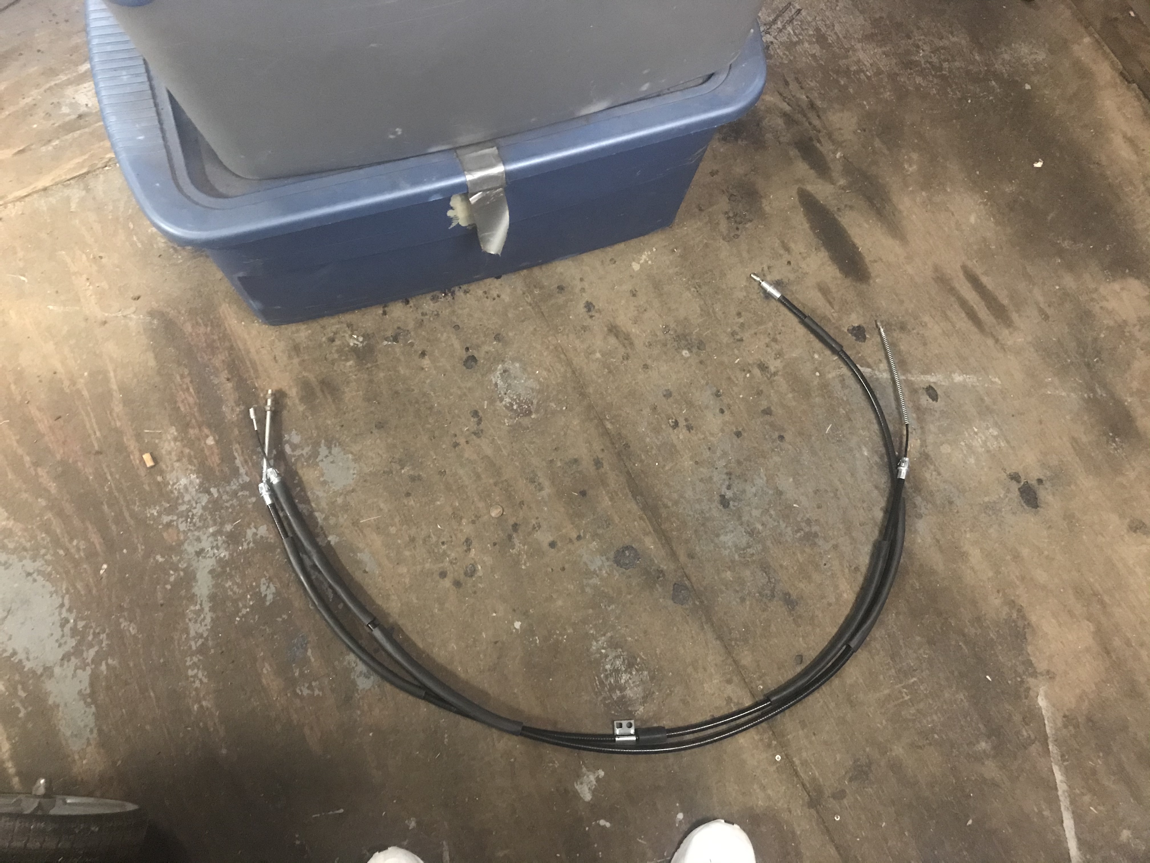

Got the idea in my head that I just might be able to use the G body parking brake cables with Mustang disk brakes on Saturday and found that the sheaths for the cables are around 3 inches too short no matter how they’re routed.
So following some advice from the Factory Five forums, I decided to cut the SN95 sheaths down, and use the G body cables in them.
I’ll do a write up when I’m done, but this was surprisingly easy to do with just a grinder and a crescent wrench.
Here’s the difference in lengths, the G body passenger side cable is the shorter one.
Twist off....
Cut, twist on, and with a parking brake cable repair kit for options, assembled for dry fitting.
Check your local Fleetpride store. They can custom make brake cables..
