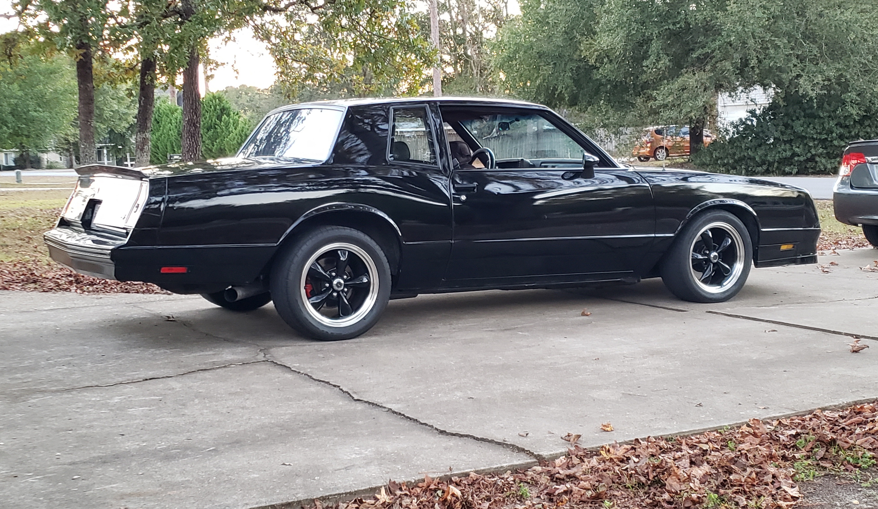

Pulled the front springs and about to give them a little cut down..
1" off the coils.
Well, looks a little better.. 🙂
Right rear is 1/2" higher then the left rear. Front jacked up in the air the whole rear sunk down and was level. Got to be something odd..
Looks good though....giving it that front rake effect.
Now the front tires looks to be a lot closer to the fenderwell... is the front suspension tight enough with minimum travel so it doesnt rub when you dip some?

I'd be surprised if the front didn't settle more. I'm curious to hear if the ride went to sh*t with those mounts too.
Those front springs have been in the car for 12 years. The rears are new and I'm hoping that drops a hair.
