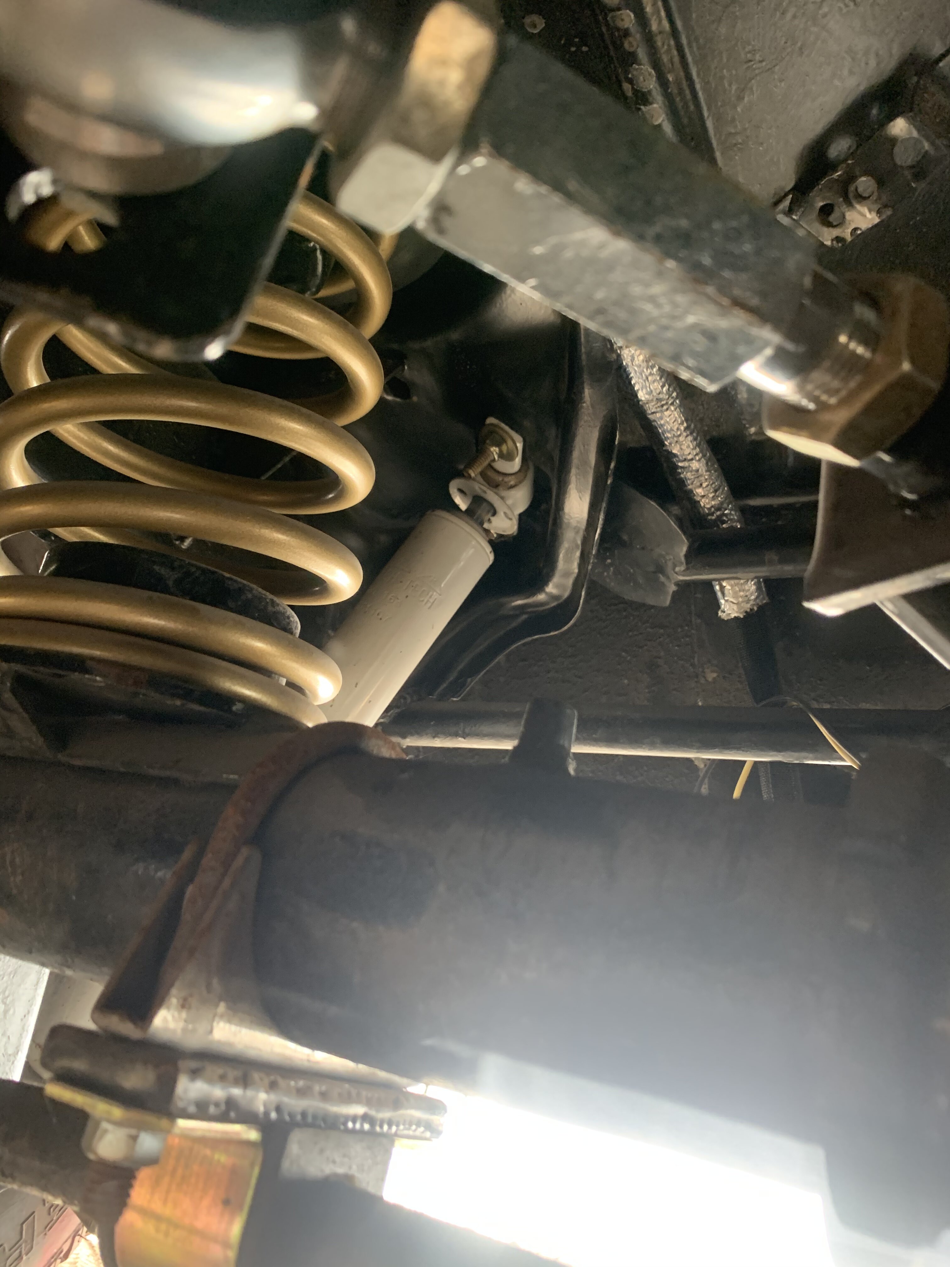

I’ve been reworking my exhaust because it looked far too low and found I bought the wrong shocks when I was setting this up initially:
Im not sure why the passenger side is lower than the driver’s, but I’ll check that when the car’s on a proper level. I need some lowering shocks, and I found in a couple old posts from pontiacgp that a set of Bilstien AK series should work.

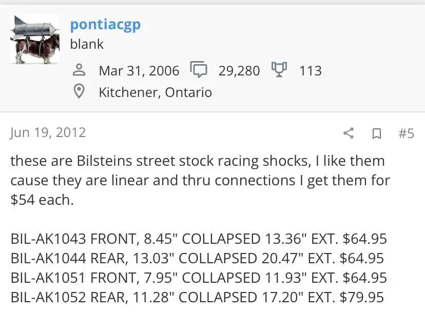

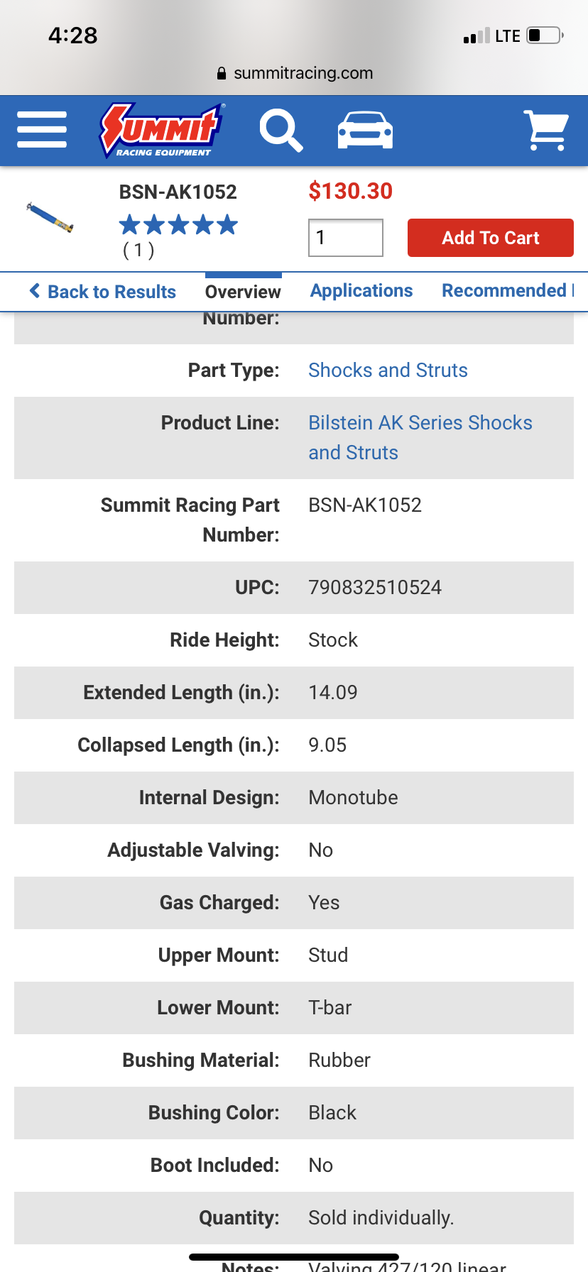

But there’s a catch. While the part number still exists, the measurements have changed if Summit is to be believed:
So I’m at an impasse here. I can’t find a shock that fits the measurements from pontiacgp that’s the right type of shock for the rear of a G body, and I’m not thrilled at the prospect of going with a completely custom set from AFCO or similar with no knowledge of the valving in a performance shock.
Might give Vi-King a call later next week but I’m not prepared to spend up to $500 for two shocks.
Looks like your jam nut is loose on your upper arm there, is that on purpose?
