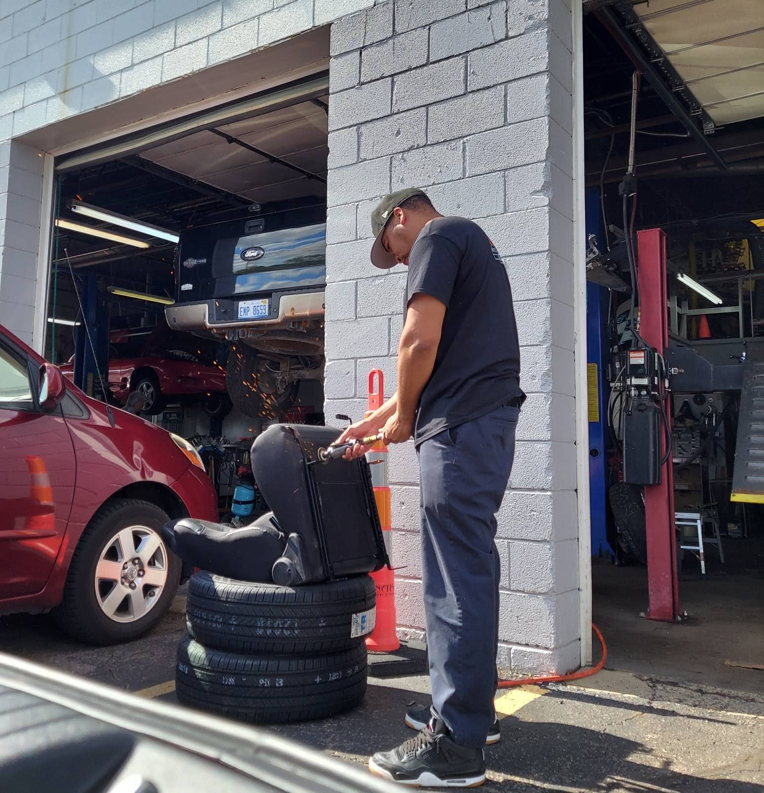

The Gbody procar mounts don't allow the seats to go to the lowest setting, so I cut off the highest hole. Unfortunately, I don't have an angle grinder or cutoff wheel, so I took the seats out, went to the shop, and they loaned me the tool. That 1/2" inch, made a big difference (that's what she said lol). I would honestly work at this shop for free, but unfortunately, they're at work when I'm at work.
Get a 4" electric angles grinder. Swap the 'head' for whatever job you're doing ( cut-off wheel, flap-disc, Scotchbrite disc etc....). Pneumatic cut-offs work great in certain situations where space is limited. Many tasks (like the one you did) can be done w/the larger angle grinder.
