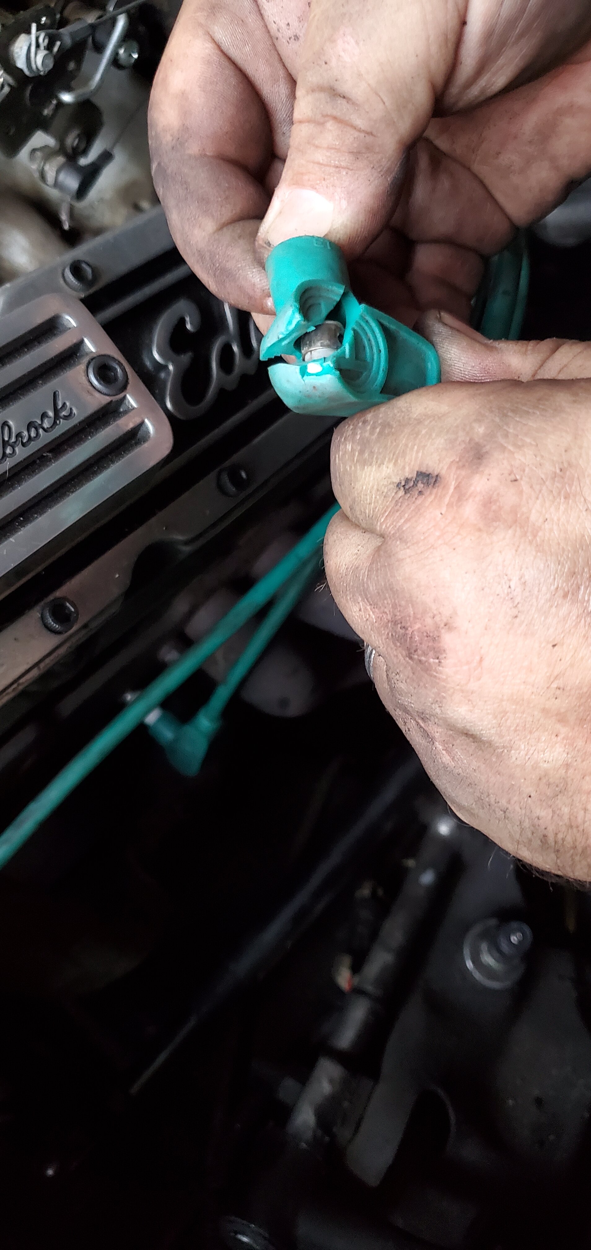

Got my buddy to stop over last night and give it the once over. He decided we should change the plugs, cap, and rotor to see where that gets us. Once we got through that the top port on the Sniper sounded like it was sucking a hell of a vaccum. Also noticed there was a nice break in the boot of the wire. Then the distributor wasn't getting any vaccum to it, played around for a while and seems to be the IAC going wacky. Was supposed to be 8-12 they claimed, it was originally at 0 then would go up into the 50s a few times, one time even went full 100 before it stalled the car out. On the Sniper display it was showing it going lean but the car was running very rich, so got to do some more homework and see what all is going on
View attachment 200275View attachment 200276
You know I'm not paying extra for all that work. Still just the $50, pizza, and beer.😆
Seriously though, it's good to hear there is a lot more going on there, it makes more sense how the car would be running for a while then just crap out on you.
