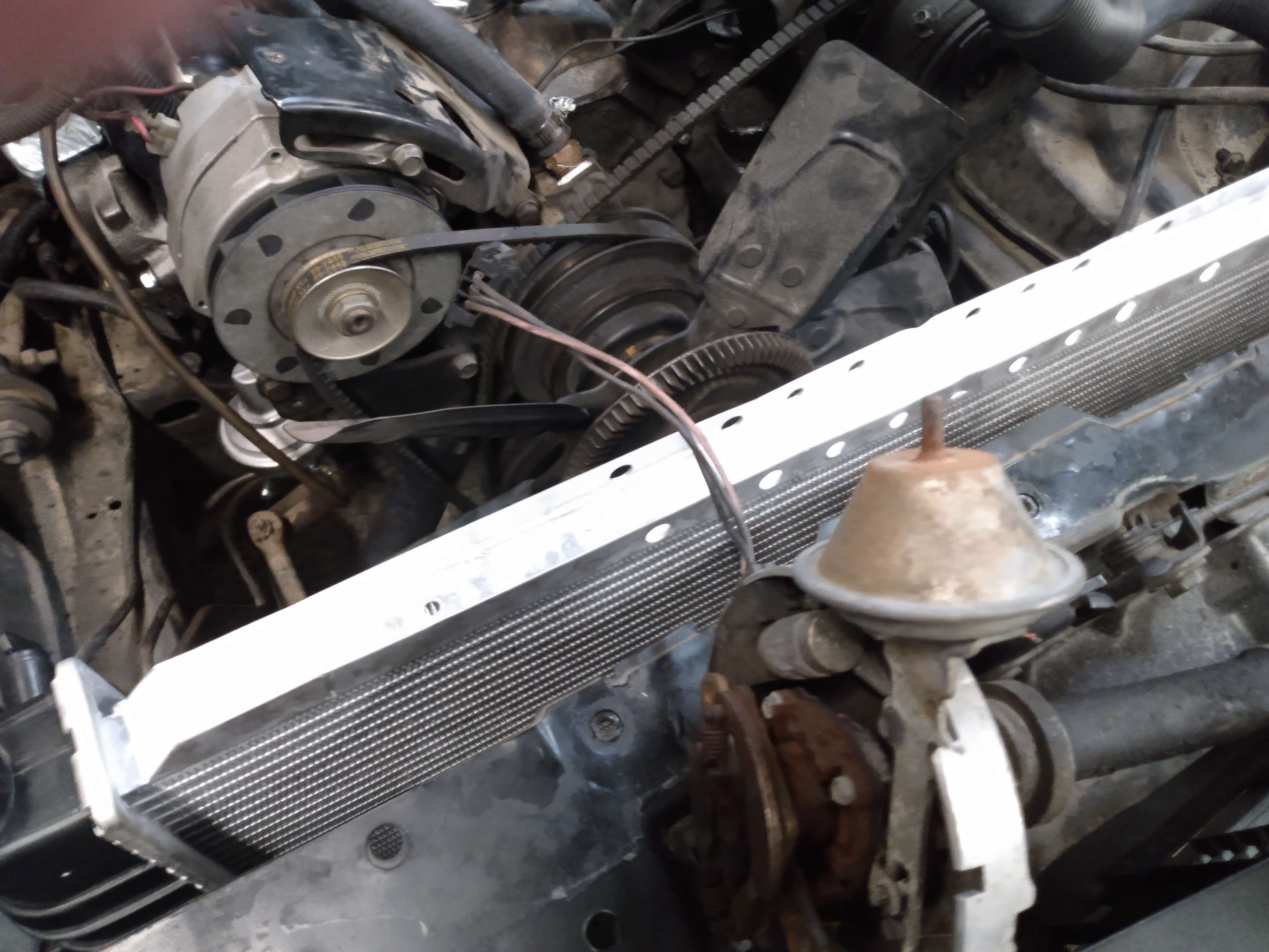

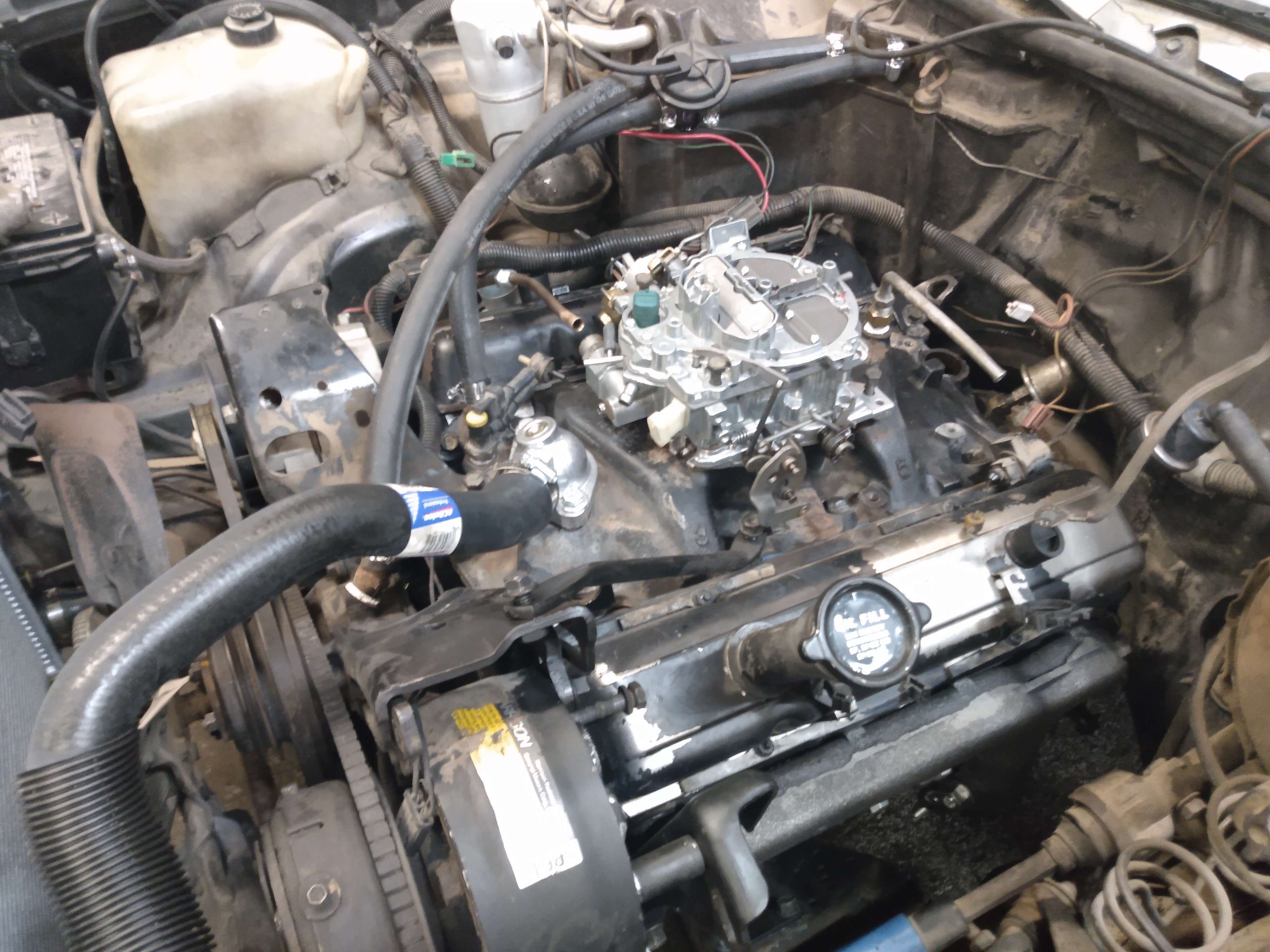

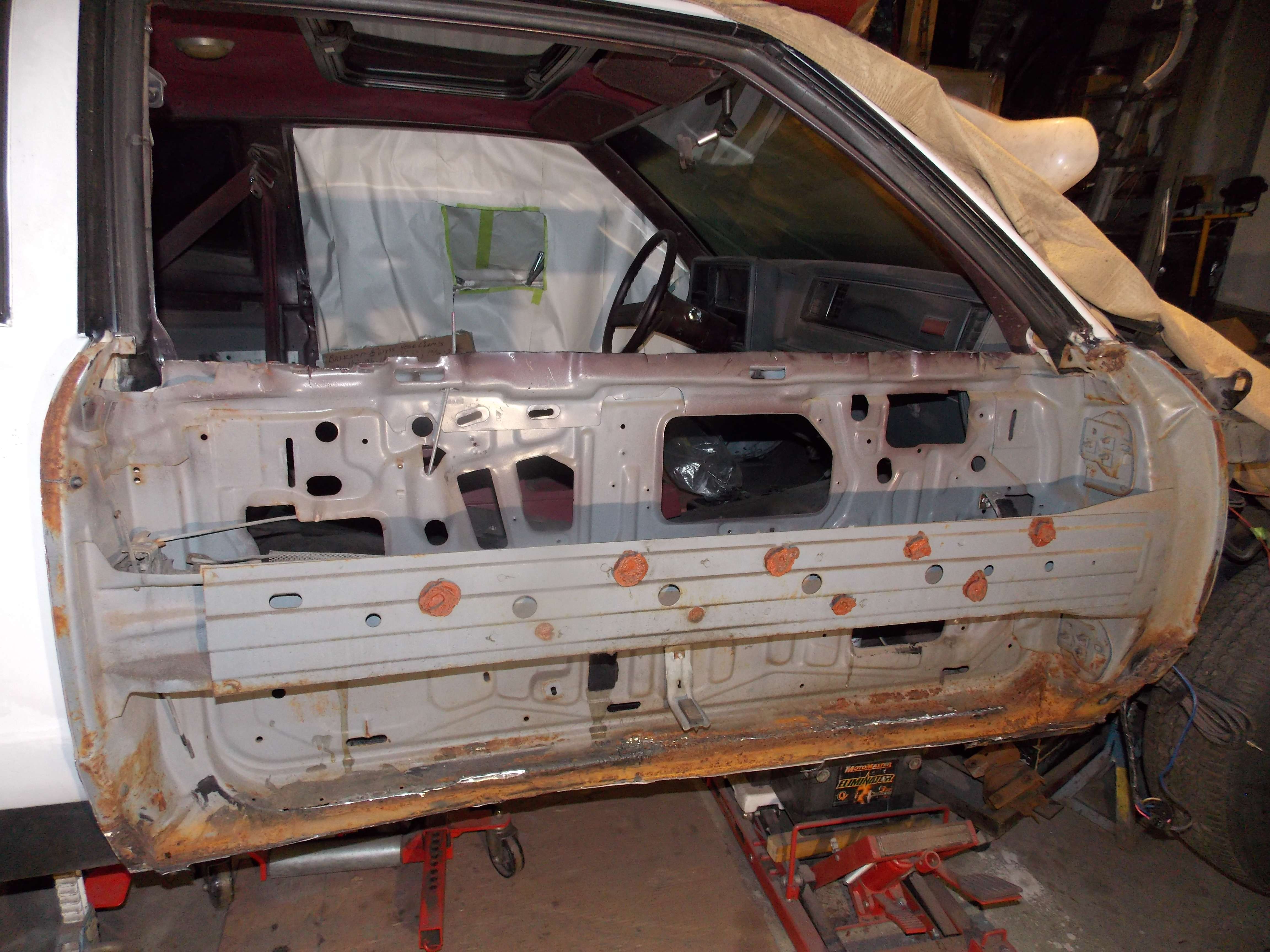

It's been a long haul of a hot Summer. my B-Day was on the 9th otherwise I would have posted this earlier. Anyway on said day I dropped by the shop to see the progress the Mechanic has made. Well the engine is in, spacers had to be used for both of the Motor Mounts, I am assuming it was a quality issue. However I had to buy a few more parts which are on the way, New Distributor with the one wire required. New Oil Pressure Sensor and Wiring. Also something called a Dentien Cable? Mechanic called it a "Kick Back' cable that leads to the Transmission something for the Throttle. I've already got a longer "Universal" Throttle Cable that should be long enough to reach the top part of that. Being that I cannot find a shroud IE: Clutch Fan, I myself will have to modify the existing shroud by cutting it short and moving the shoulder that holds the radiator in place inward a bit. Permatex should do the trick for that. Well the engine is in and the transmission is mounted with no problems. All I need are said parts an its about ready to go. I'll be posting a video when the time comes that I get her back.

For your googling pleasure to be able to look at what the mechanic was asking for it sounds like you mean the detent shift cable, aka kick down cable. Basically it's what tells the trans to downshift when you floor the accelerator to a degree increasing your RPMs and getting your engine into a higher portion of the power band than where you would be at a lower rpm/higher gear. Helpful going up steep hills or when you want to pass something.

MalibuDavyouS, Looking at Pic Two, is your motor solidly mounted as it sure looks that way in the shot?
Also, what transmission are you running? Asking because, from what I see in Pic Three, that looks a lot like what I have sitting on the intake of my Non G, and my t-box is a 700R4 which has a TV cable. The downshift or detent cable that I had when I ran the Th350 had a mounting/pivot tab that had a long slot in it, not what your picture shows. A quick peek using the close up function shows the correct mounting points for the throttle cable and the pivot pin over which the cap on the end of that t-cable snaps into place. So, me here, being curious.

In response to your question, I am still running with the TH350 Transmission. The bracket shown for the two Cables is one that came off of the V6 and fits on the 305 which will be reused on the engine.

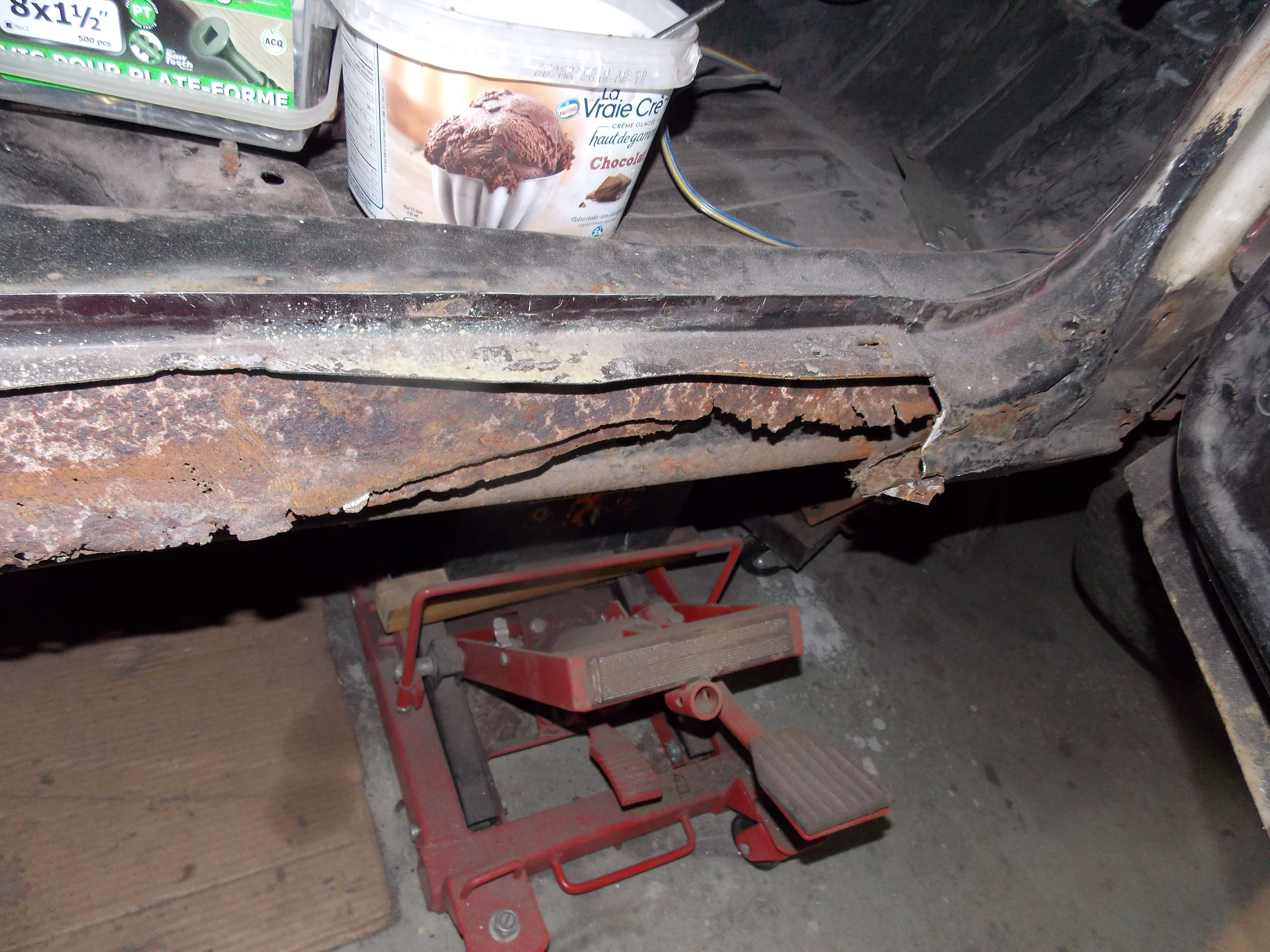

So, for show and tell today, what you are seeing is a sequence of shots of the passenger side of my Monte. The passenger door has been completely skinned out and only the latch and some brackets remain inside the otherwise bare inner door or shell that is still hanging there.
The detail shots show the lower door flange, or what was left of it and the first attempt done many years ago to try and repair it. This exercise was performed on the back driveway in the sun and rain, under a canopy using a Lincoln 225 Wire Feed set up for Flux Core. Being outside with no shop back then, Gas would have been a waste. it worked, sort of, but it is time to try and get it right. This shell, although no beauty, is repairable. And that may happen some quiet summer day sometime whenever. For now, I have another completely renovated inner shell on the body table and waiting to go in. Repair, you say, why not chuck it as a lost cause? Because, up here in the land of the Frozen Chosen, any kind of donor doors are about one step away from Dodo land, extinct that is. New inner and outer skins are available, sort of, but the wait time is hideous and the price per each, ................well, all about a week's pay.............each.

What is also shown is what is left of the inner and outer rocker panels. Total junk, they both will have to be cut away from under the A pillar all the way into the lower forward corner of the front of the quarter panel. You can get outer rockers; the inner I had to fabriate from scratch. Been waiting to do this repair for over a decade at this point. The last shot is the lower A pillar. Once the door shell is unbolted and set aside, I may have to cut this apart and do it all over again. I do happen to have a donor pillar, (and wouldn't that be a crazy looking inch worm) that I can dissect for the necessary bends and panels. It is just a mean amount of work to muddle through. There are a few more shots poste over on the thread about the 85 door problems.
waste not, want not. I see you area also using a battery on top of the jack to hold the door/frame up?
and is the chocolate ice cream for having a snack later? 😁
Reactions: Northernregal
Ah............No. While you are right to believe that the battery is sitting on the lift deck of the bike jack however, sorry, there is no lift going on I use those batteries as dead weight when trying to push panels into place. And it is a dead battery; it has long since ceased to be. What you see and think you see is actually the camera angle playing tricks on you.............gotcha.
As for the ice cream container, nope, ice cream long gone. The empty containers, being made of tough plastic, get washed and rinsed out and recycled out to the shop to hold bolts and varsol and anything else that will fit in one of them. I even use them for tool sets like my 1/4 drive kit which is what caught your eye, the box beside it, with the green label, quit holding screws some time ago and now holds drill bits. Reduce, re-use, recycle.
