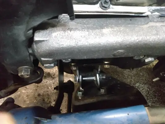

Well, the engine is in, spacers had to be used for both of the Motor Mounts, I am assuming it was a quality issue.
I am not sure why he would install solid mounts on what appears to be a stock or mild SBC instead of the stock clamshell style but it looks like a mismatch between upper and lowers they shouldn't be squished closed like that when mounted.

I am not sure why he would install solid mounts on what appears to be a mild SBC instead of the stock clamshell style but it looks like a mismatch between upper and lowers they shouldn't be squished closed like that when mounted.
Back a page or so ago, I did also happen to comment on that picture and mount, wondering why it looked deformed? It's location is the driver's side. Nick
