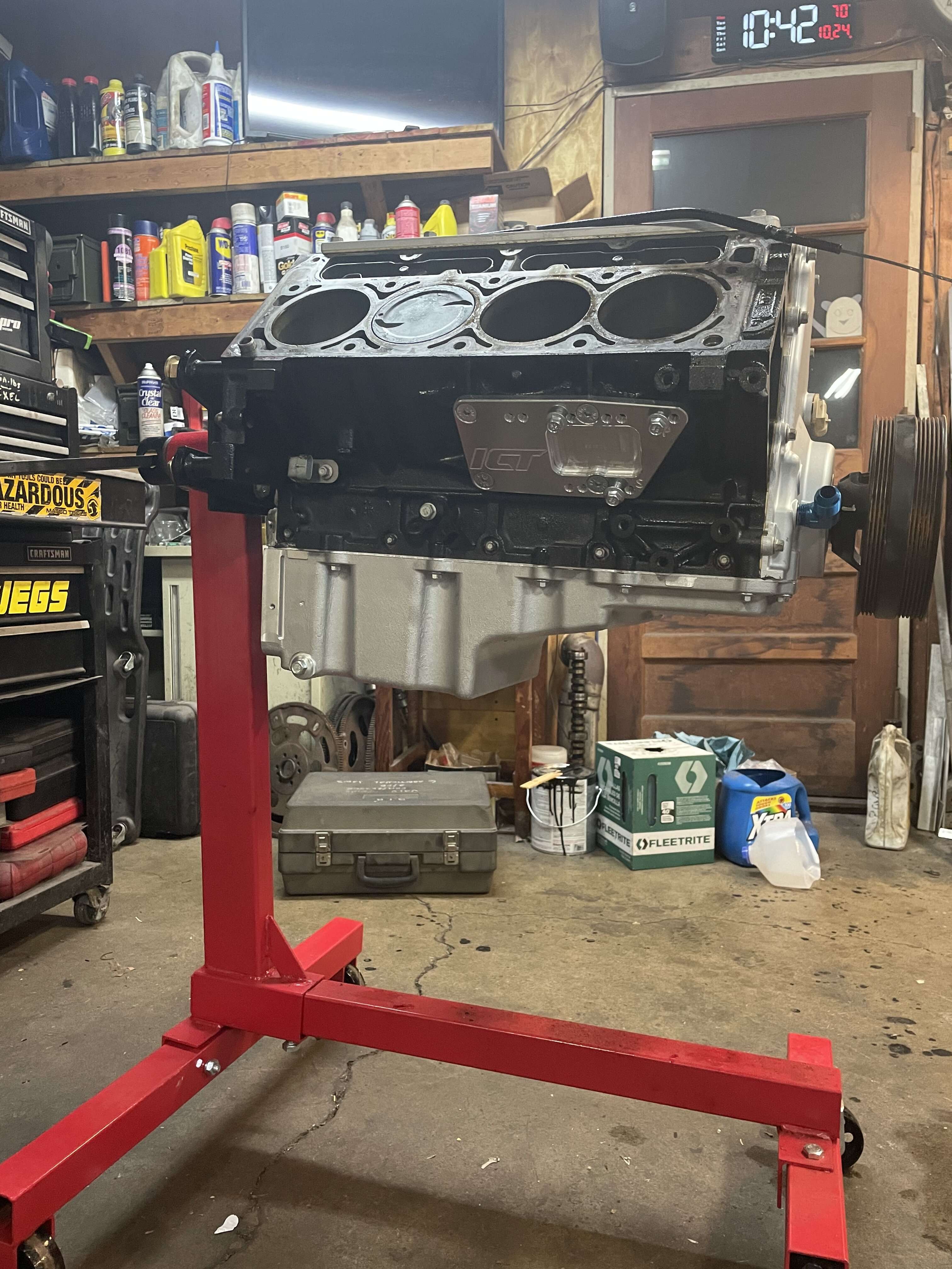

Stumbled onto a ‘sort of’ LY6 6.0 for free. 6000 miles and had an oil pump pressure relief spring failure. The fix was a set of bearings, an oil pump and a set of rods and mains.

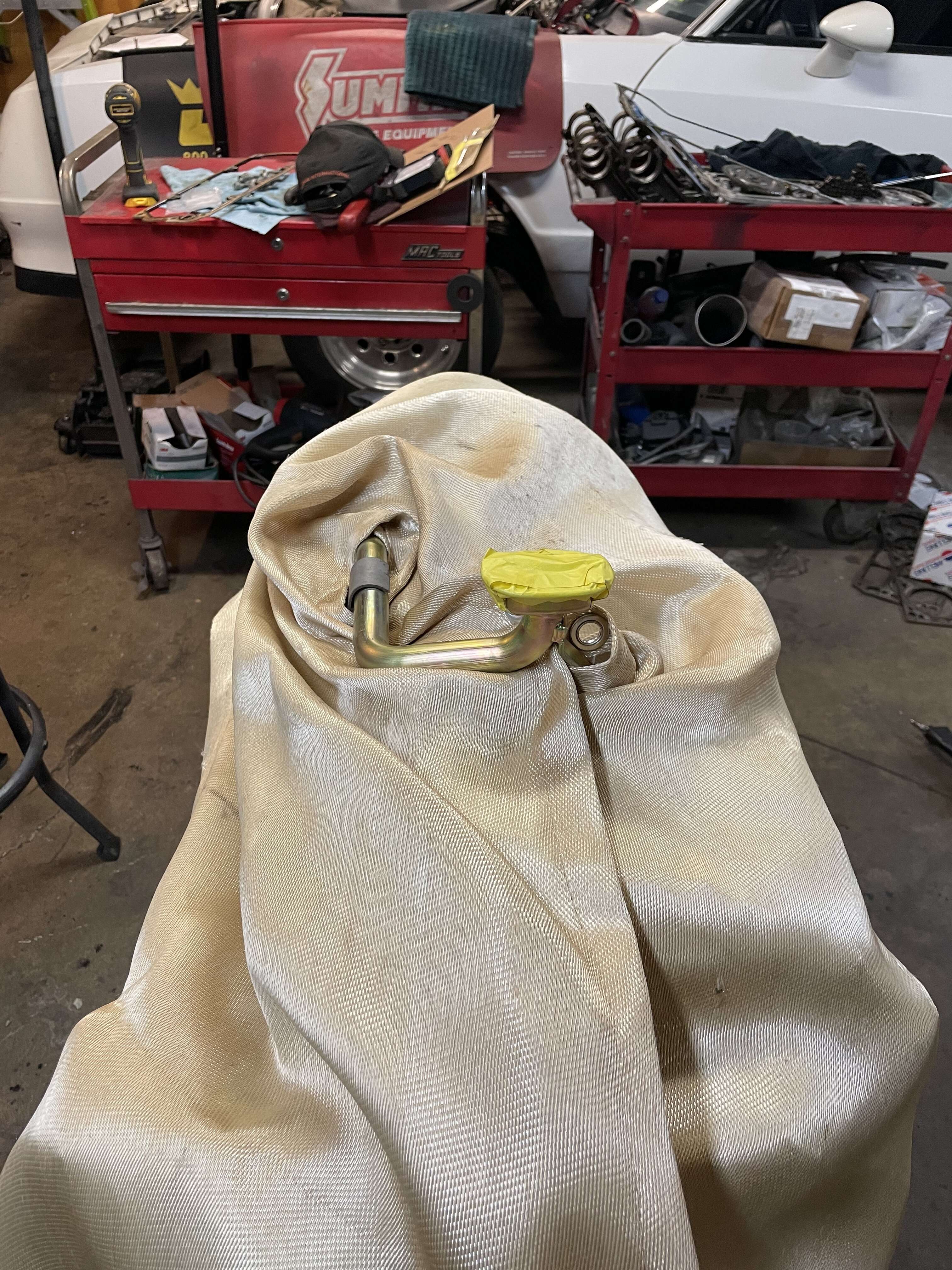

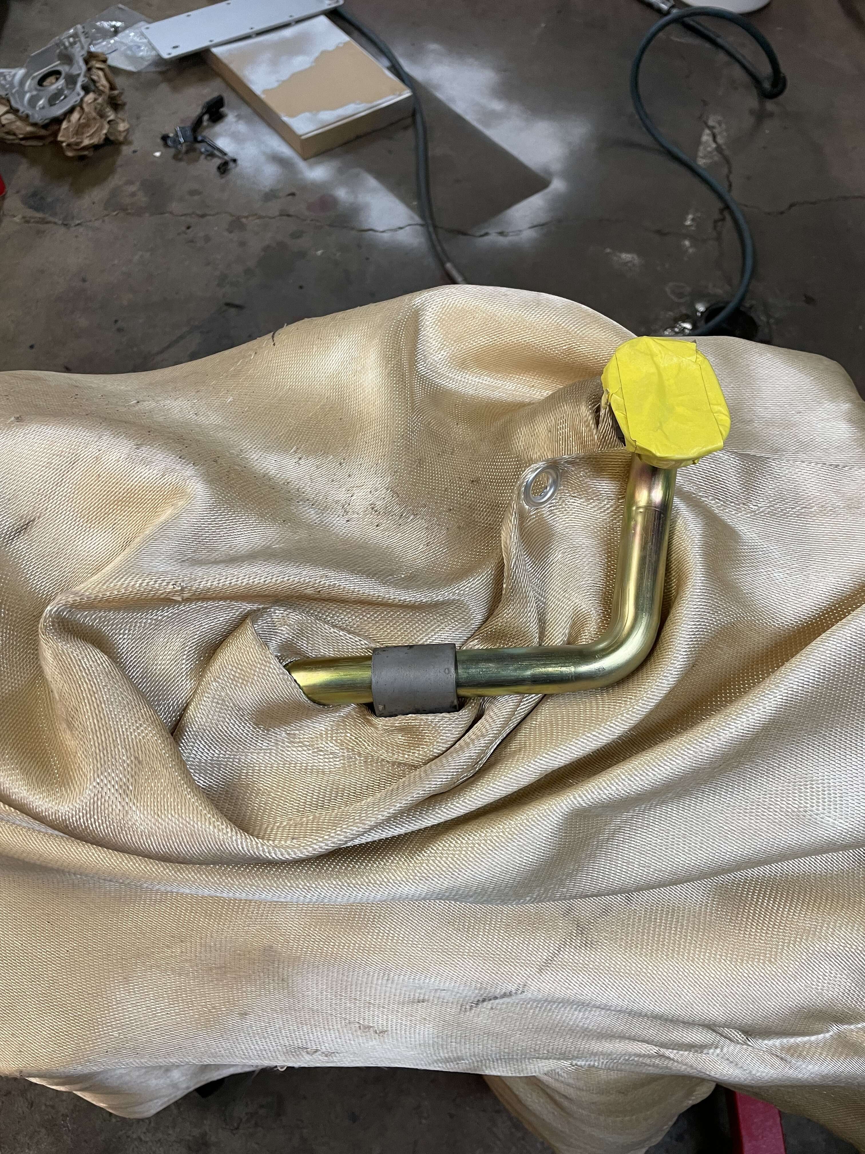

Actually trying to make it look better than my usual junkyard stuff. Picked a white box Holley copy oil pan that Streetbu put me onto. The oil pickup is minorly goofy - it has only mine support and was a little loose(wiggles) when installed. So I fixed that 😉
4968CFBC-57CE-4B9A-BC4E-9A56AF4D2E4E.jpeg97A4D3CB-97EC-4D98-835D-2798E379B518.jpeg14B0D494-2CFF-41C7-95D0-D2F601840EC9.jpeg
Has a SS2 and a set of mildly used PAC 1218’s. I deleted the VVT and put in a 3 bolt cam gear for 58-4 timing setup.
I wanted to use the virtually new 821 heads, but they’re square port and I have no intakes for them. So I’m digging through the 317’s that I have ‘in stock’ to find a set. I have two sets of 706/862’s that are ready to go, but they’d put the compression over 11:1 and this is a pump gas only deal. So 9.6:1 will be where it’s at.
