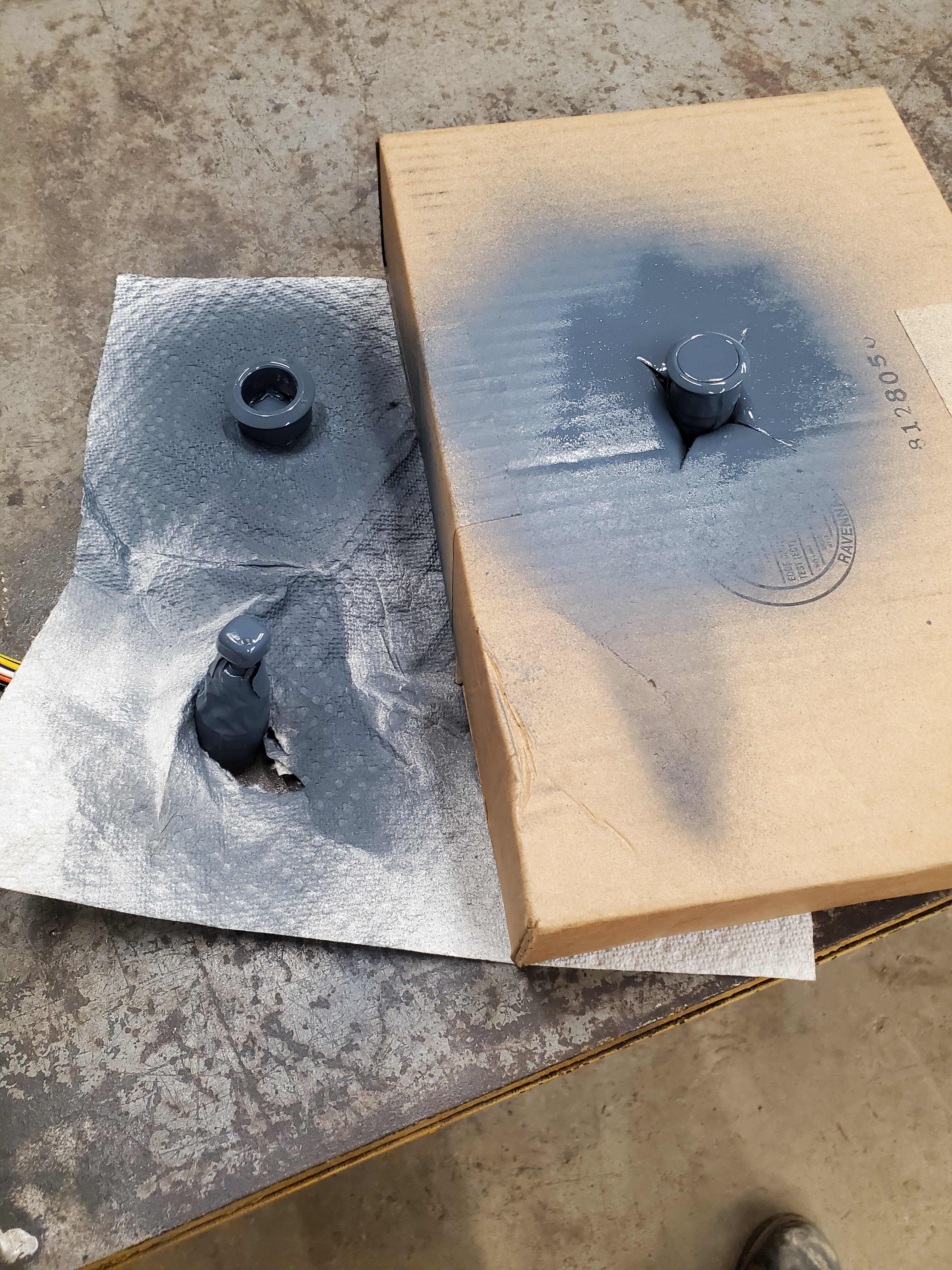

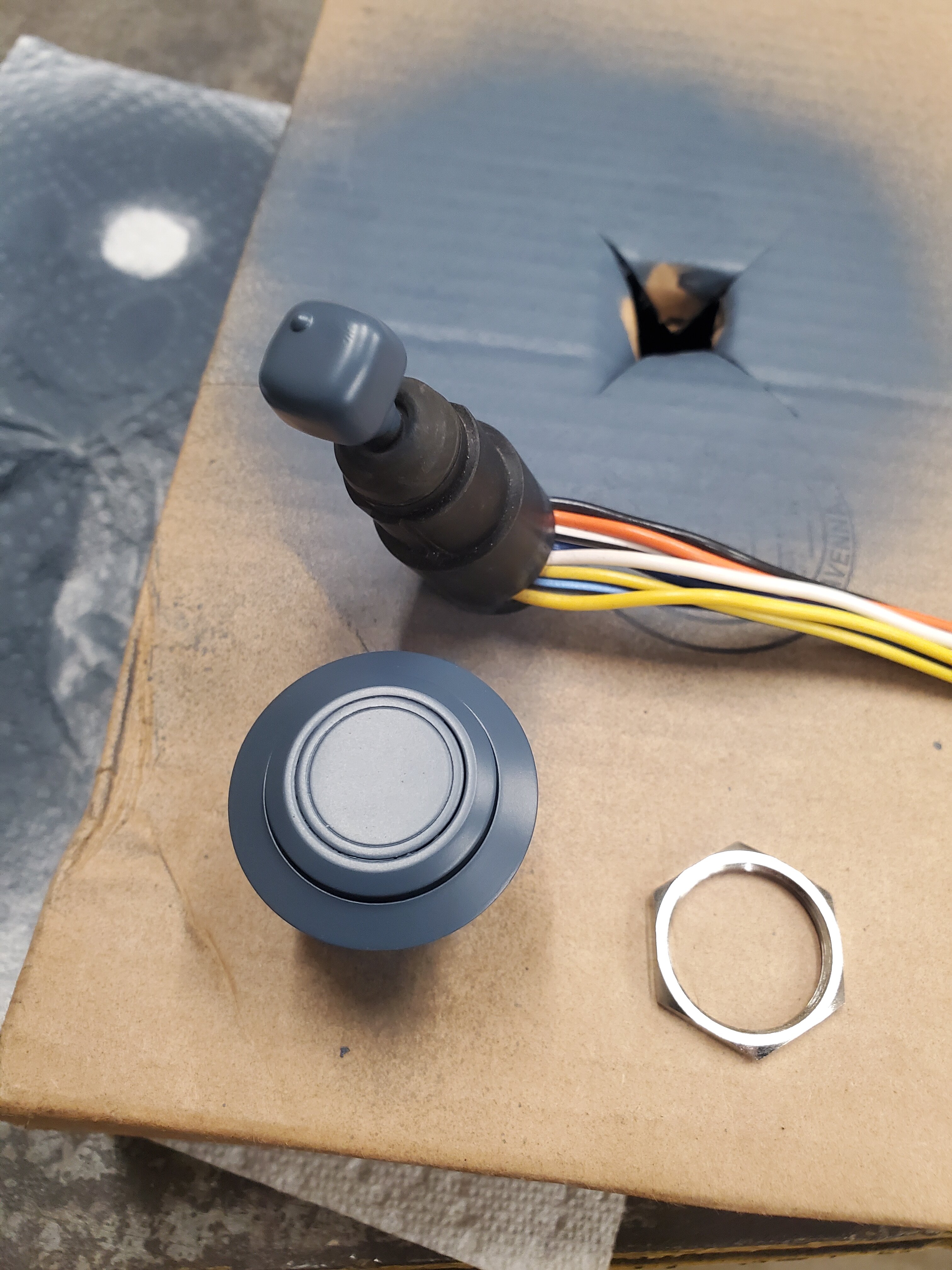

Got a little painting done to hopefully make this fit what I have going on in my interior a little better
