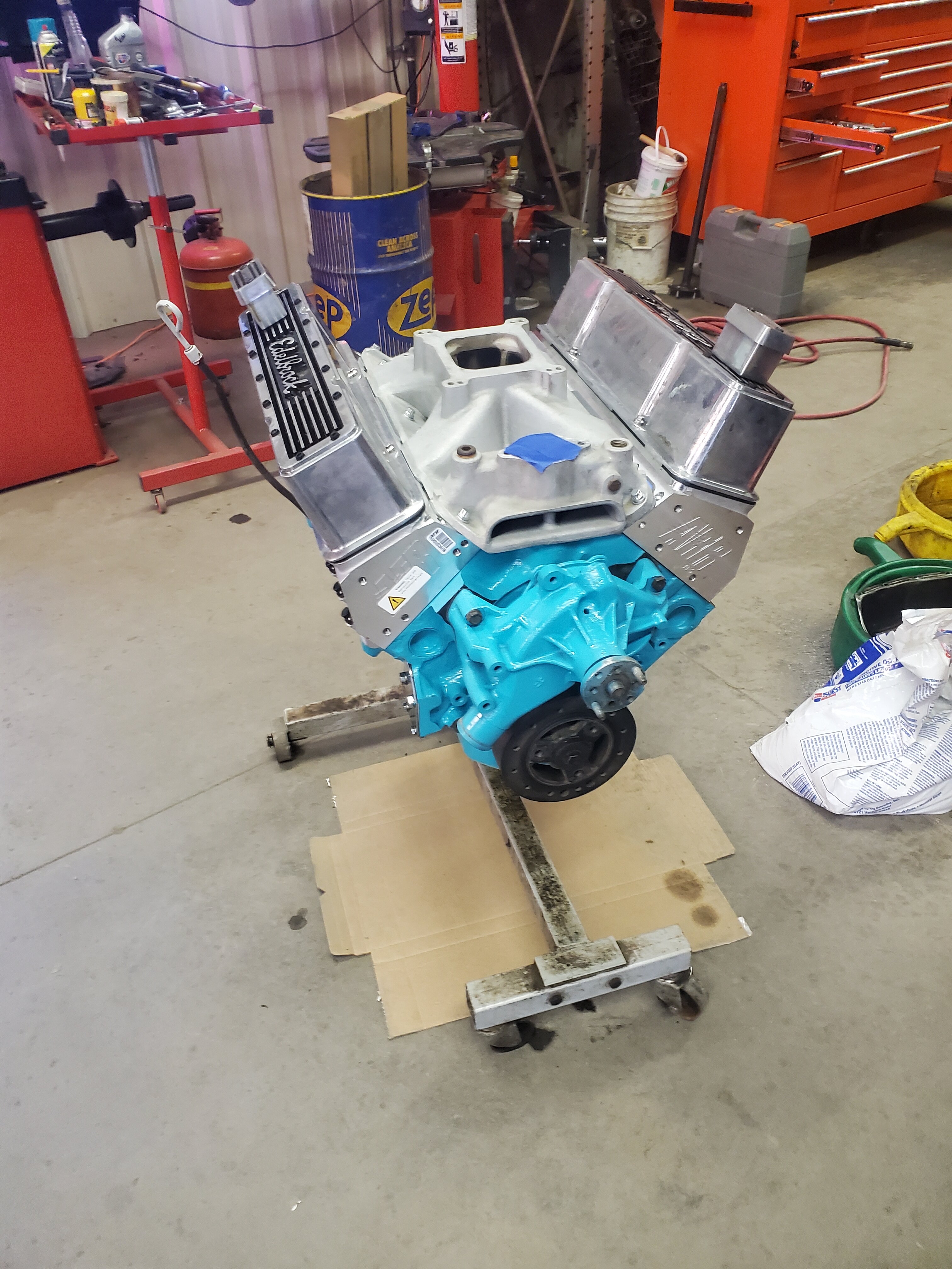

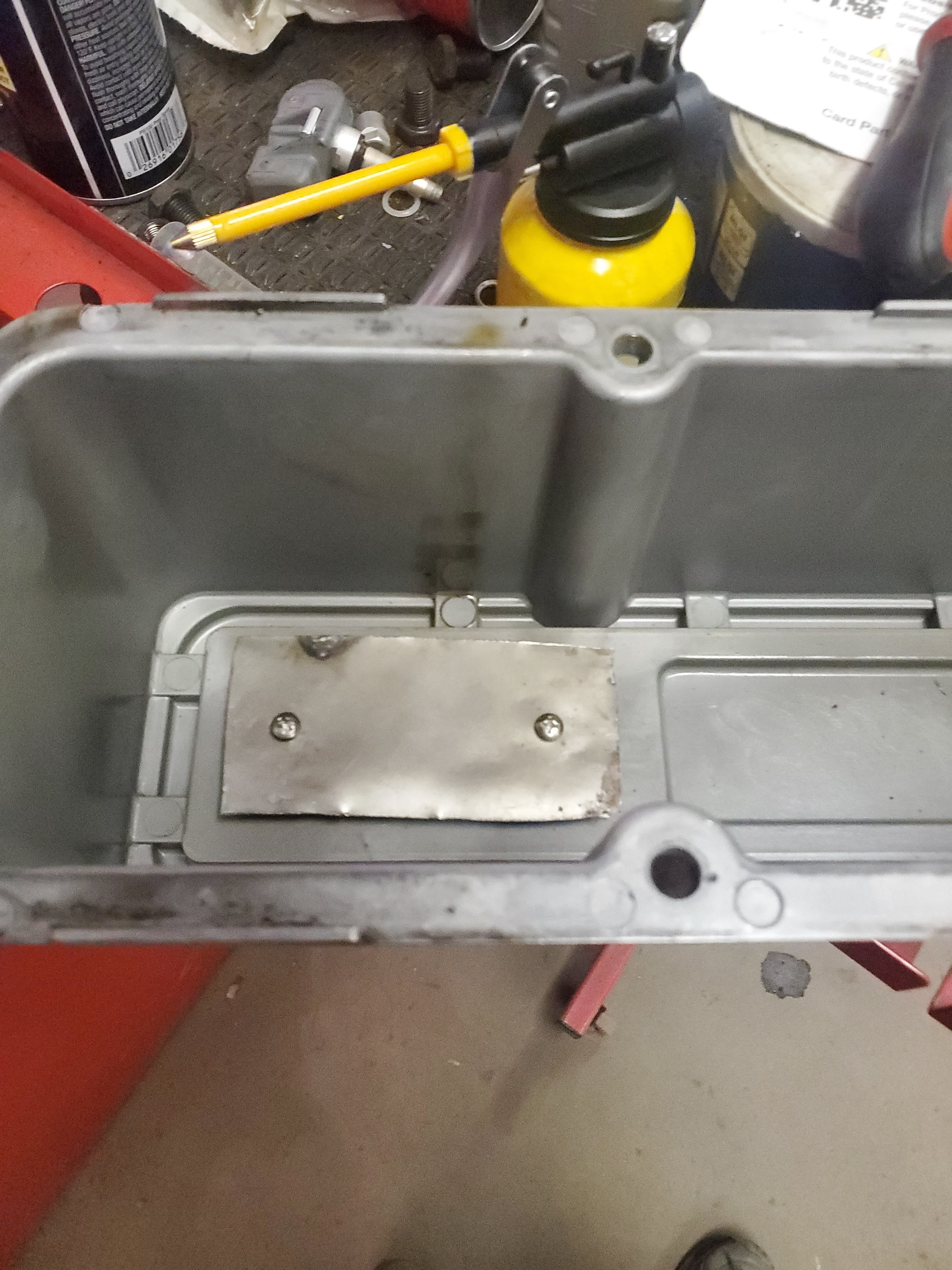

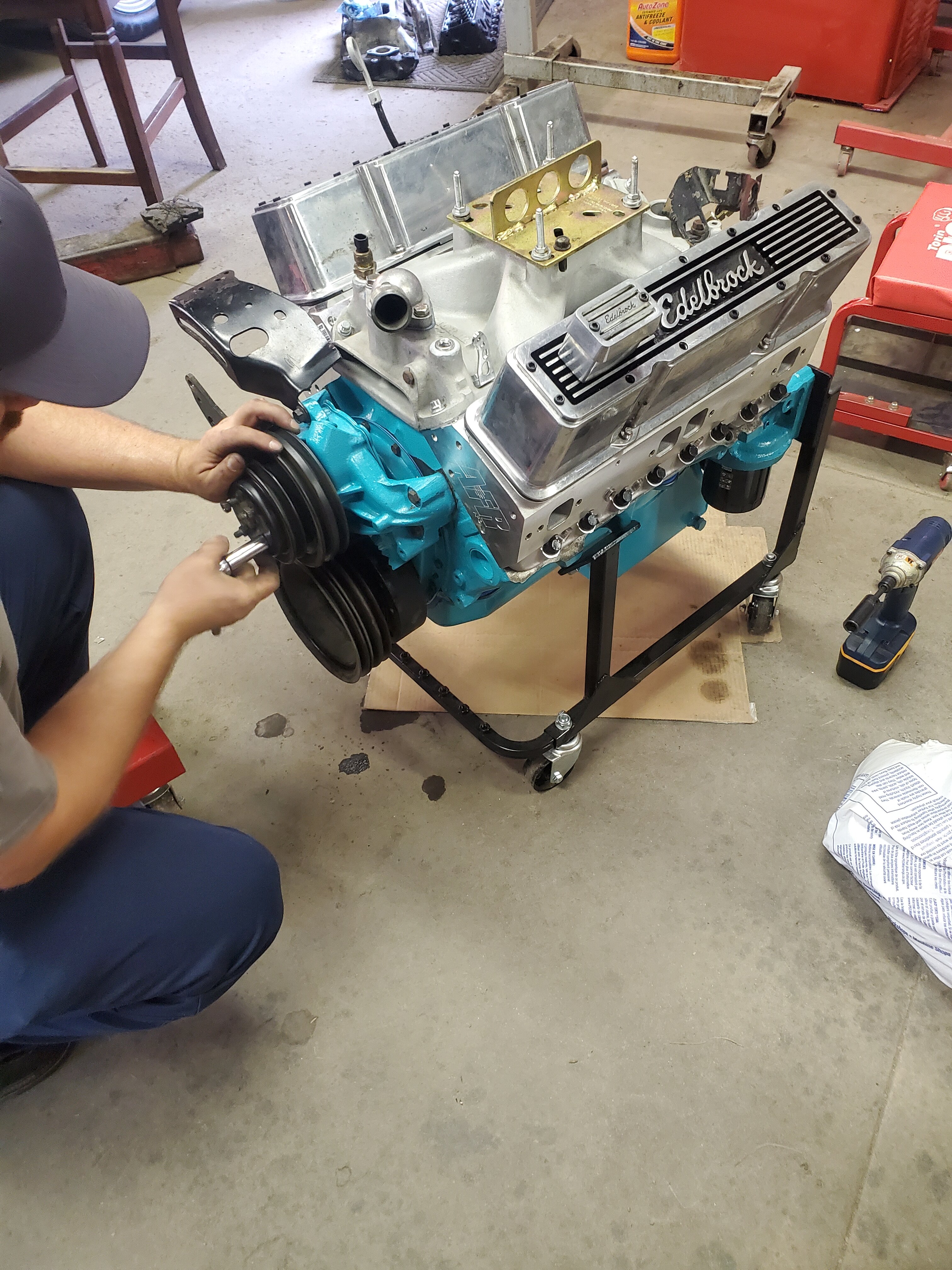

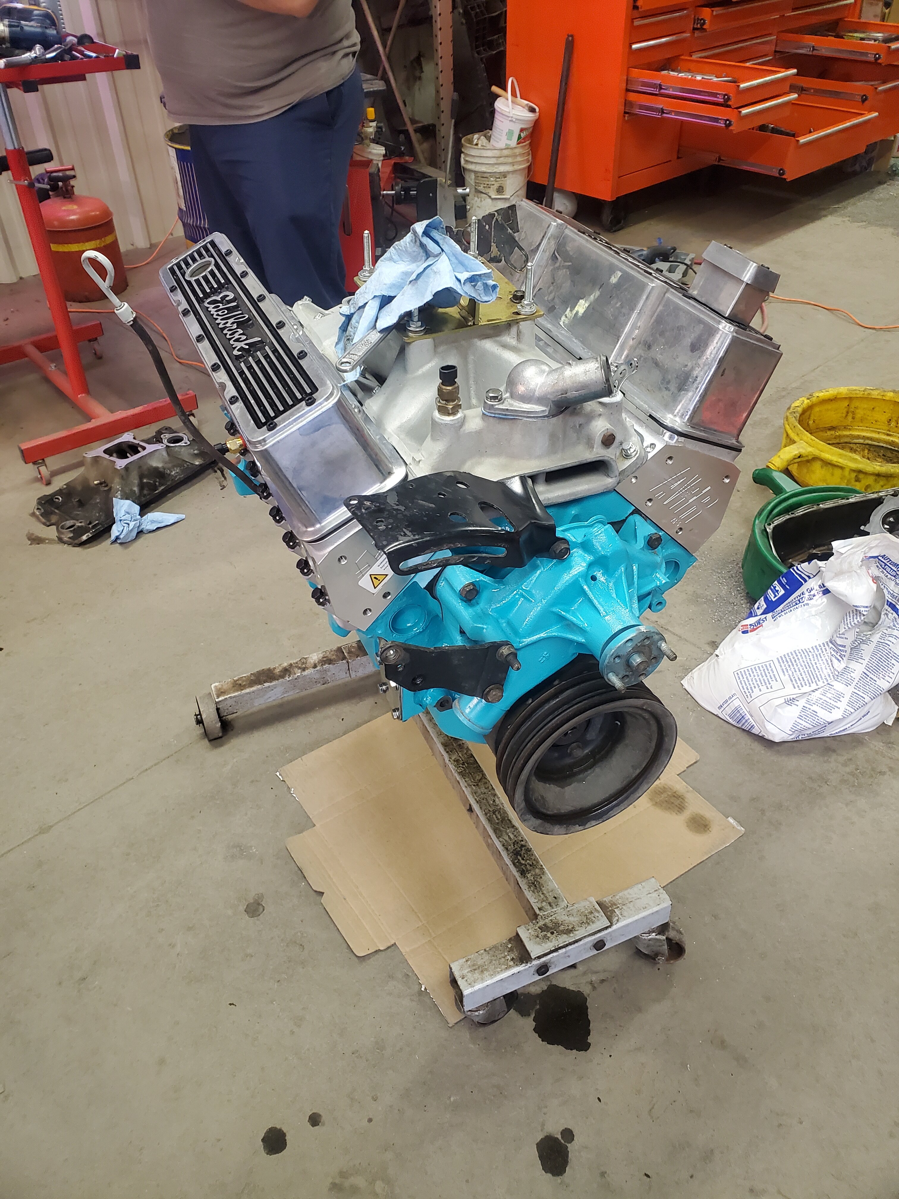

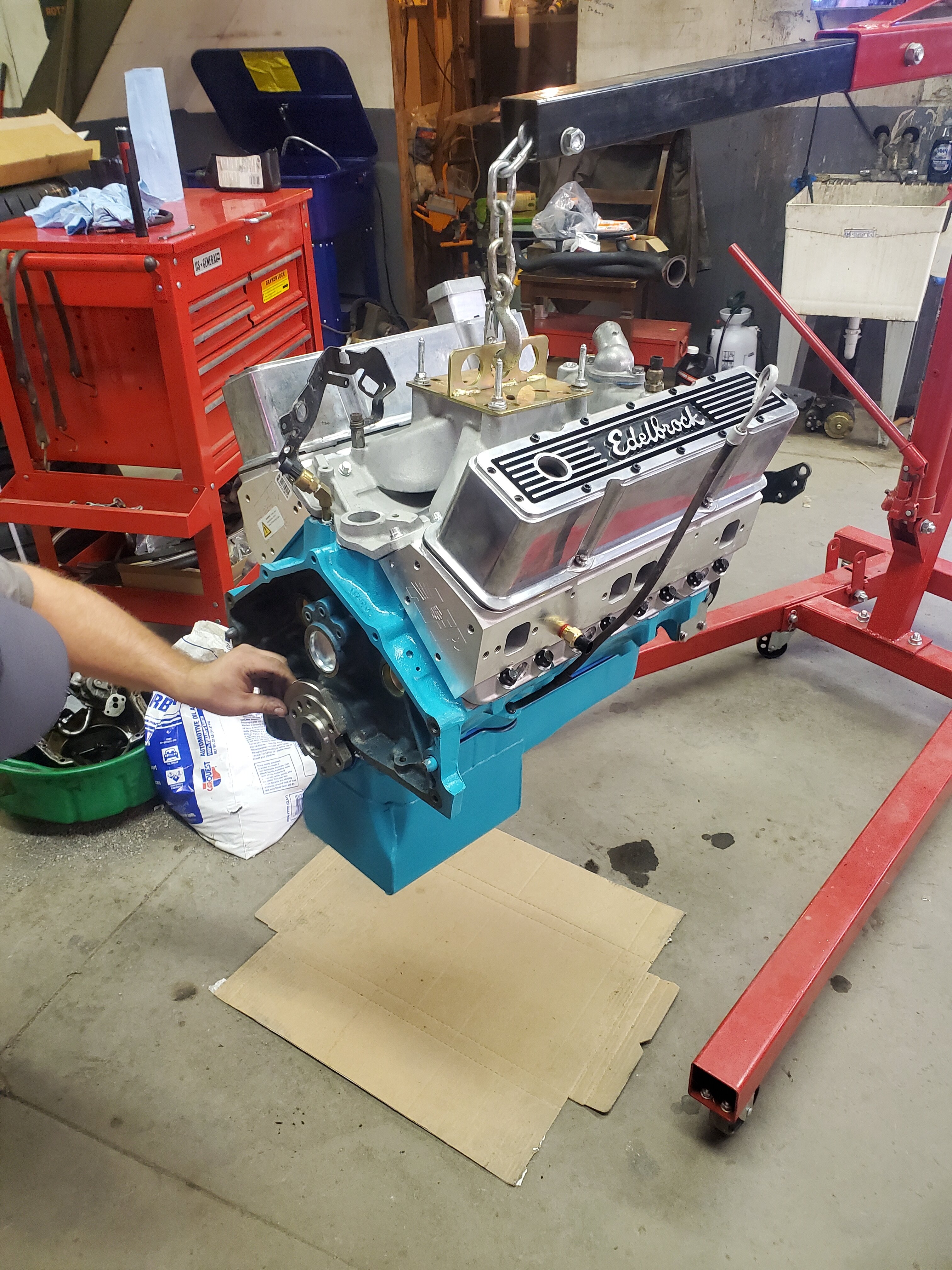

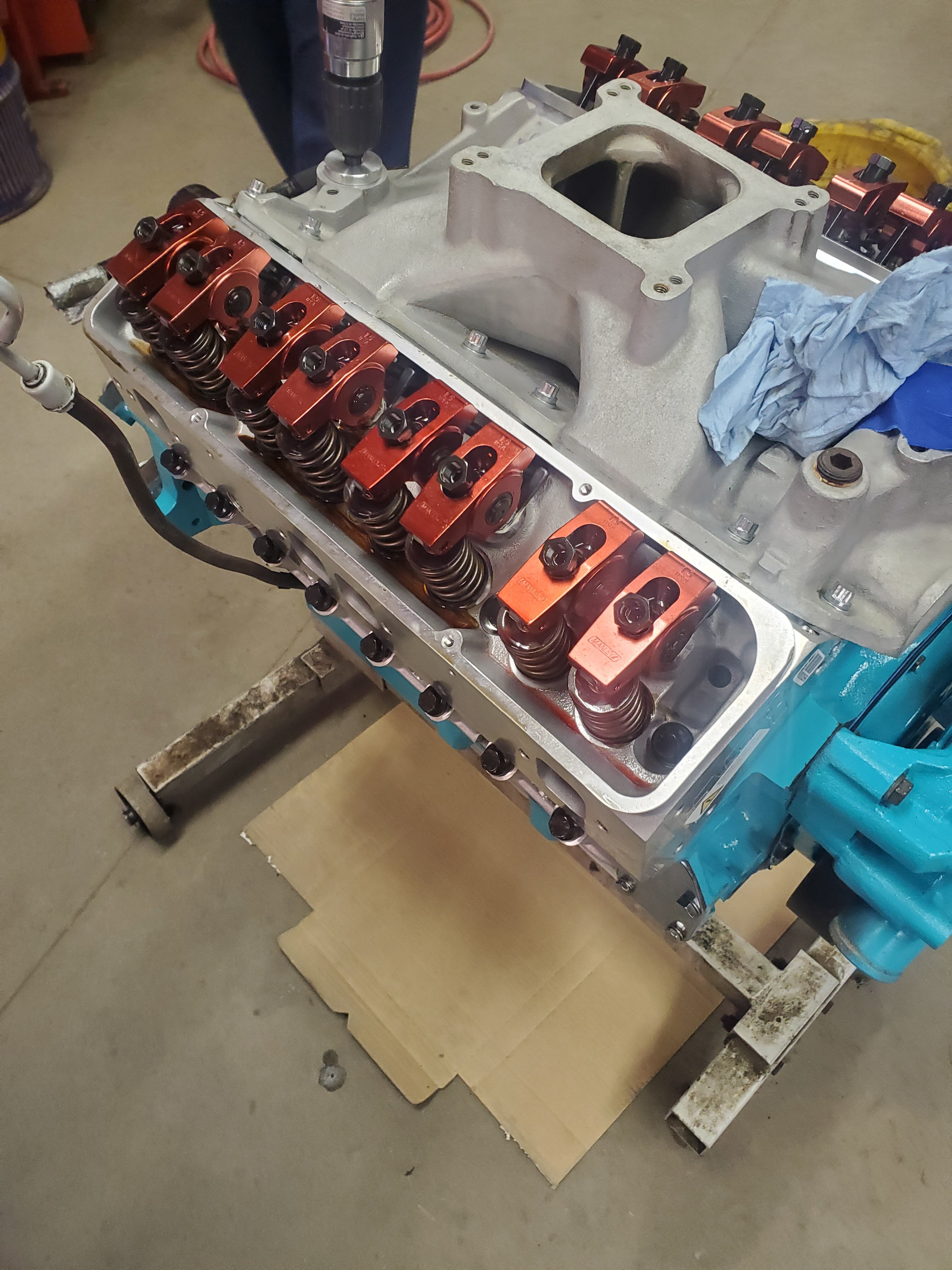

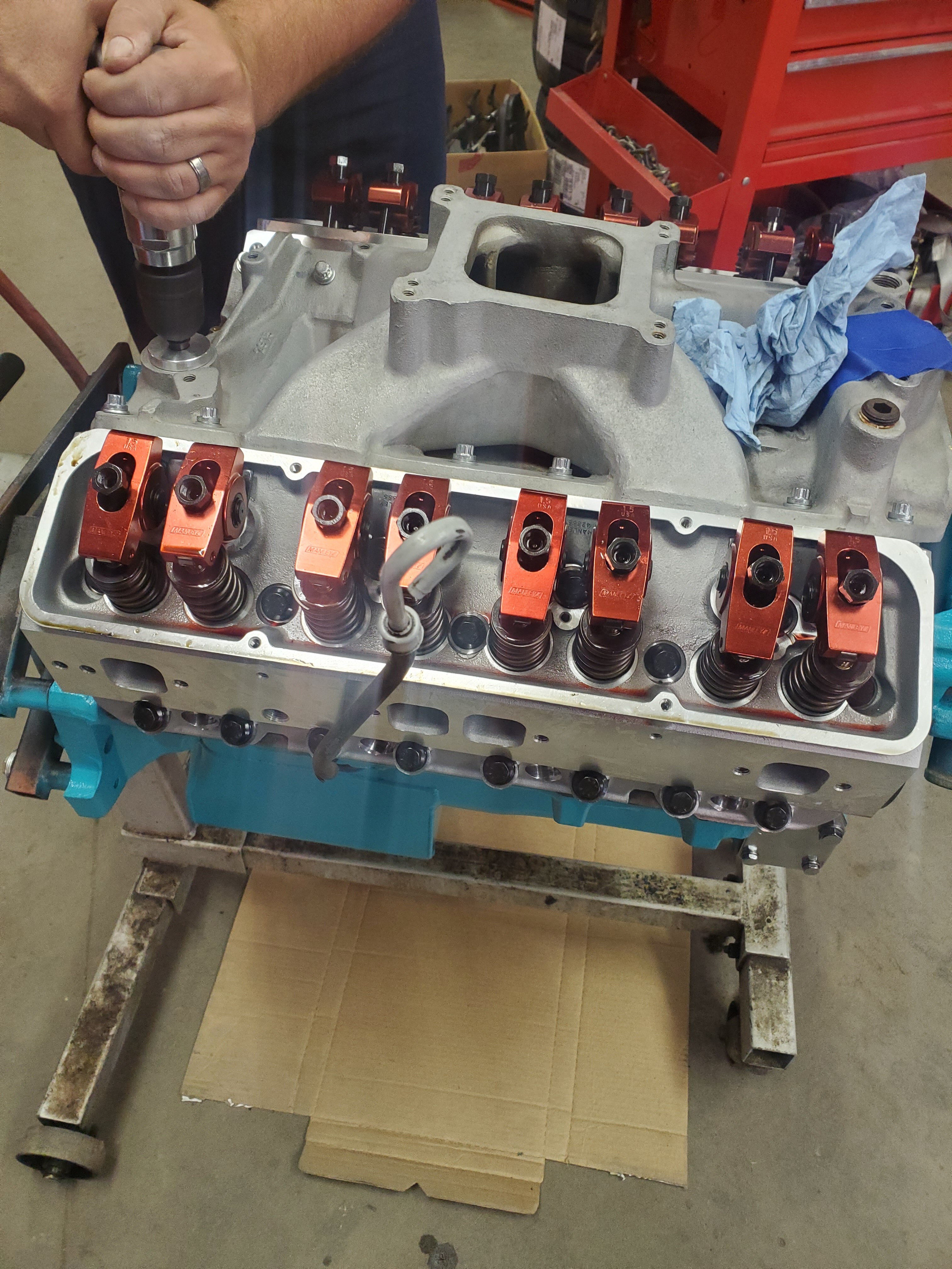

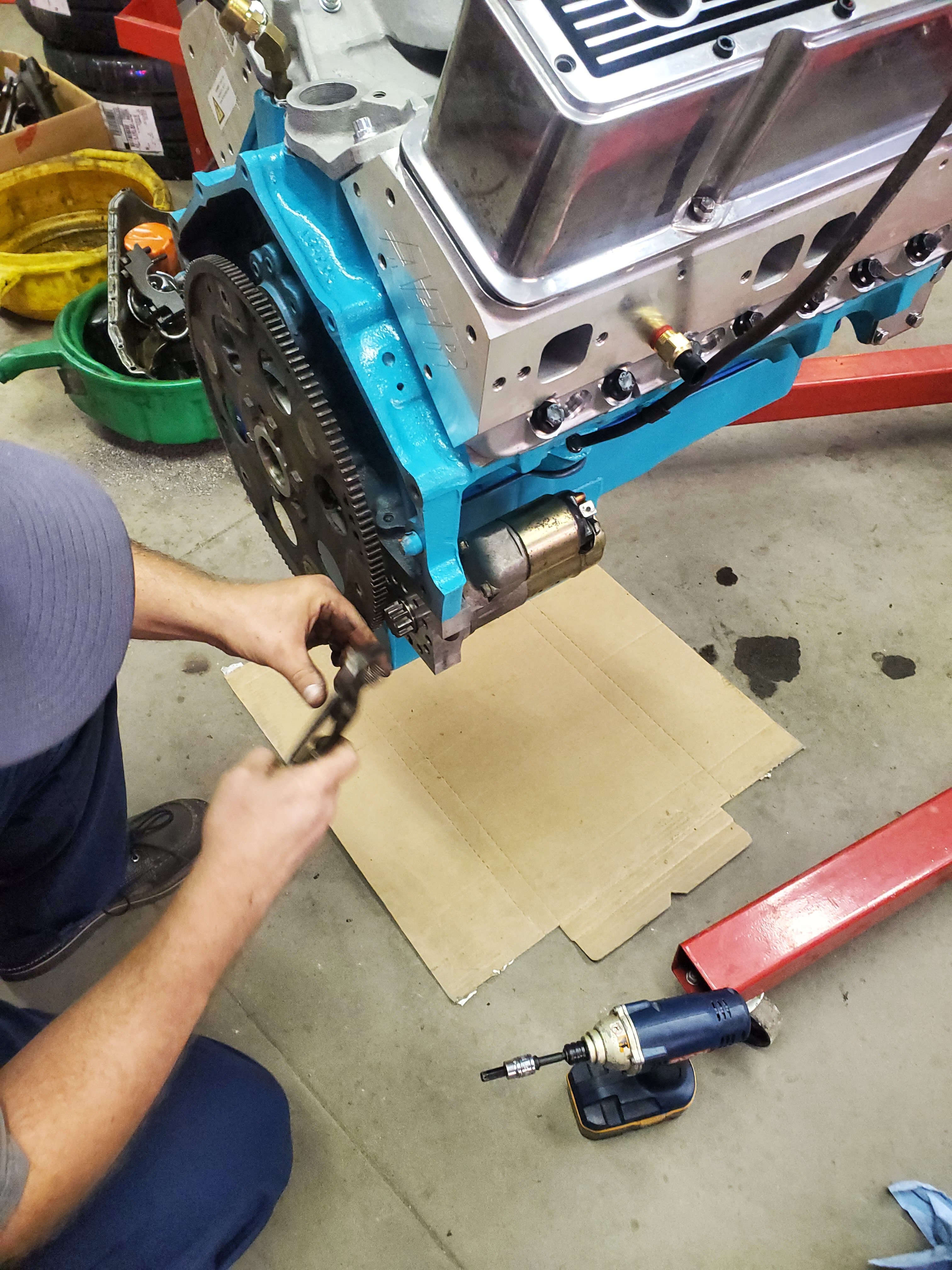

Got the motor together and primed, but Auto Zone dropped the ball on the PVC setup. Had to take what they had in stock since what they told me would be there wasn't and won't be for a few more days. Then the grommet was too small go into the hole in the cover so going to see what comes in a few days, ended up making a cover for the inside of the valve cover since it wasn't there and then cut the bracket down on the alternator mount since the new intake was different
Got the motor together and primed, but Auto Zone dropped the ball on the PVC setup. Had to take what they had in stock since what they told me would be there wasn't and won't be for a few more days. Then the grommet was too small go into the hole in the cover so going to see what comes in a few days, ended up making a cover for the inside of the valve cover since it wasn't there and then cut the bracket down on the alternator mount since the new intake was differentView attachment 228595View attachment 228596View attachment 228597View attachment 228598View attachment 228599View attachment 228600View attachment 228601View attachment 228602View attachment 228603View attachment 228604
Edelbrock doesn’t provide the baffle but you can get them. Had to do the same even after getting them. Depends on how old mine were possibly.
Yeah my buddy said originally just to buy one, then he was like hell with it we can make one quick
