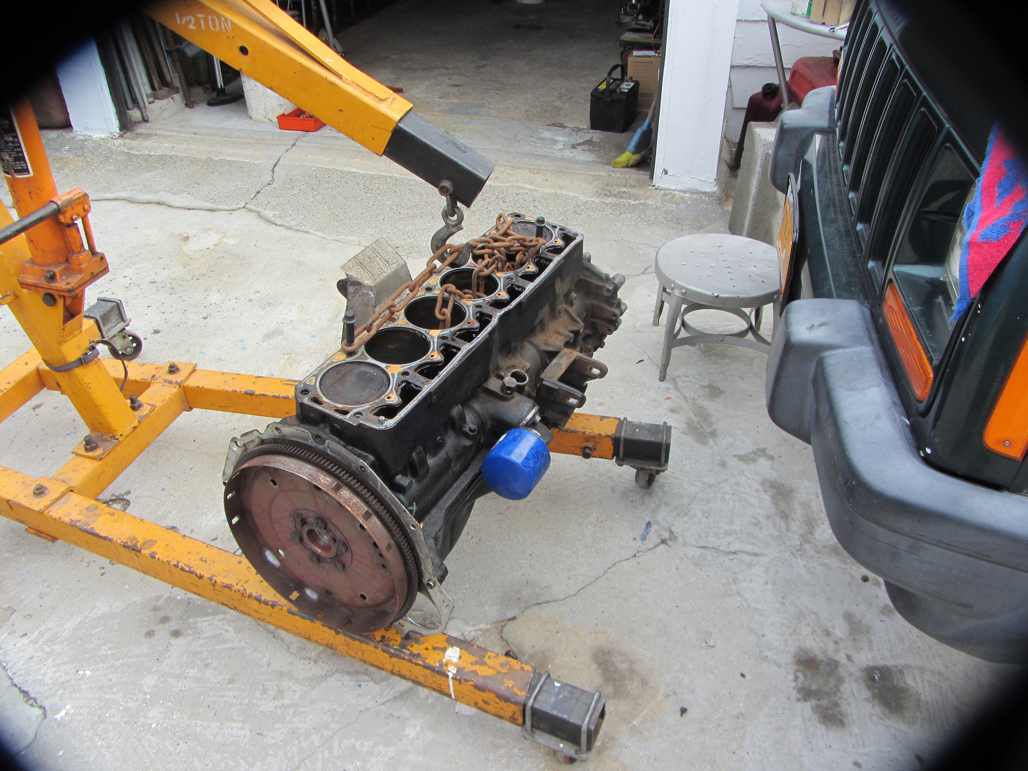

I pulled the block out of the Jeep. Some GD genius thought it was a great idea to use E12 external TORX bolts at the top of the bell housing where there is NO room. I though with the head off I could get at them and then I found they were TORX. Idiots. I needed the E12 socket, a swivel, an about 5 feet of extension with a breaker bar to bust them loose. They WILL be replaced with a saner fastener. Now I strip it down for a trip to the machinist. See the back of the flywheel? A reluctor for the crankshaft position sensor. You can see the sensor at the top of the bell housing. If you want to get back at someone you hate- give them a Jeep!!!!View attachment 129301View attachment 129302

Perfect time for that stroker kit.
It would be easier to just find an AMC 258 and slip that in. I had one in an Ambassador station wagon and it was a good motor. Too much trouble to adapt all the computer/emissions junk.
