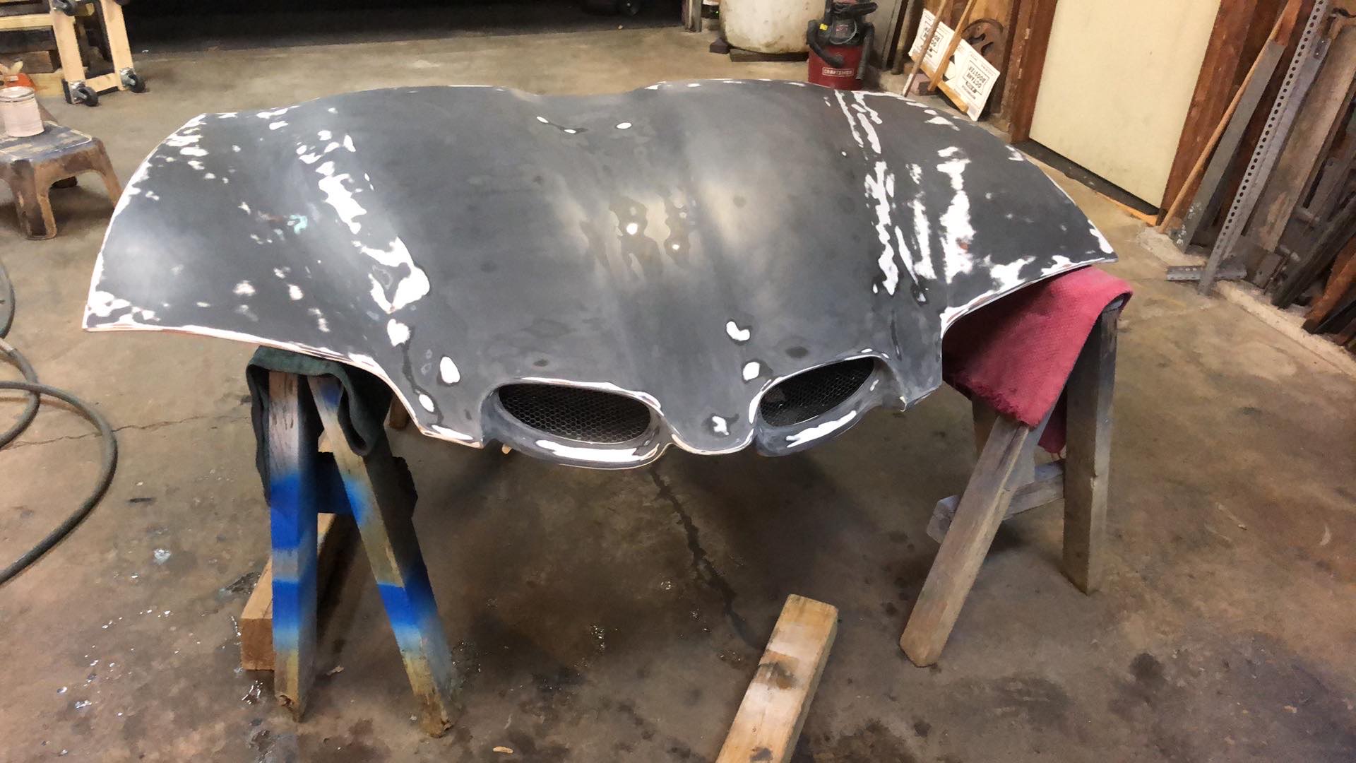

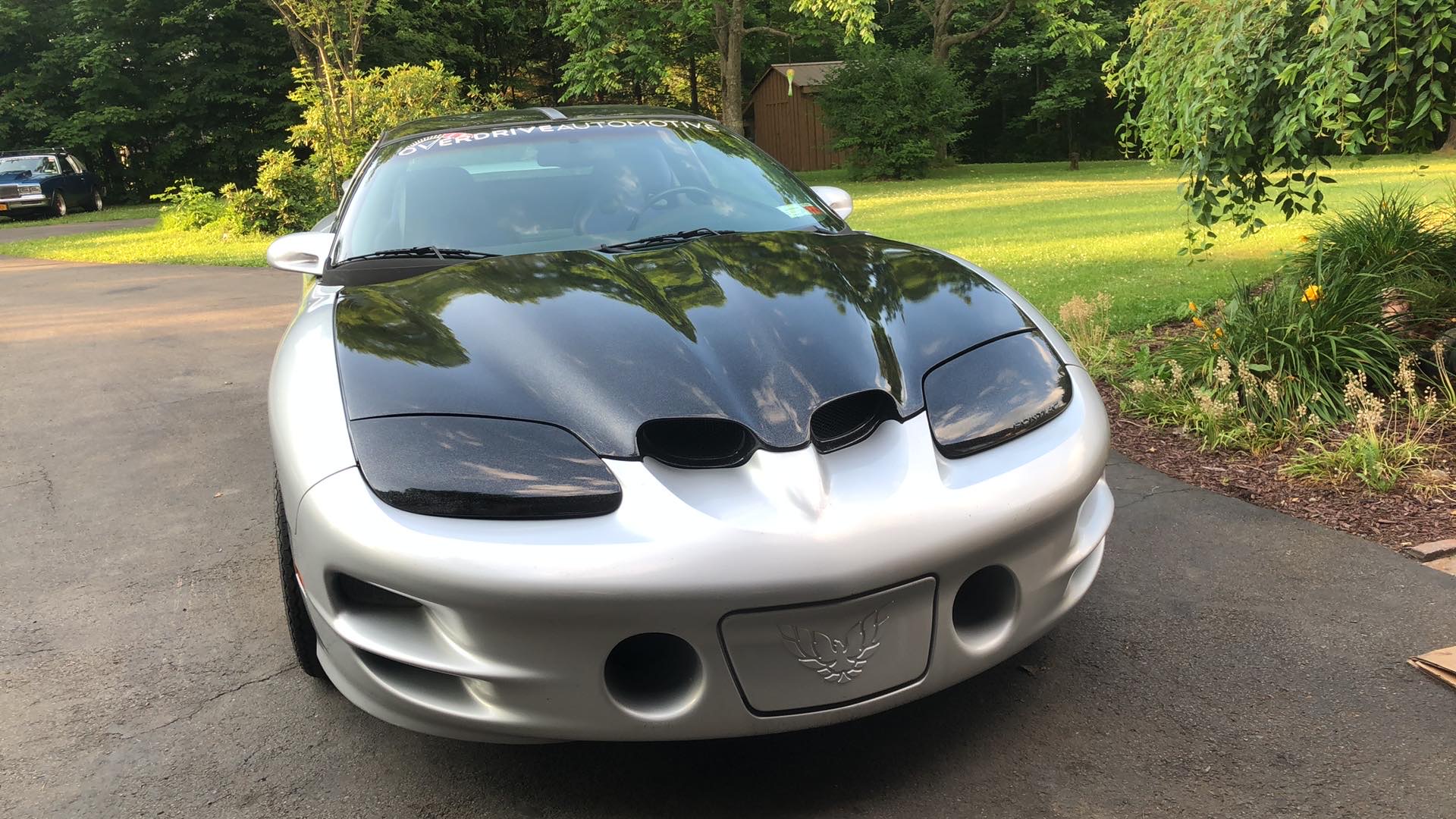

Not mine, but a friend of my son's 9 sec WS6. Hood was peeling the clear coat off. I prepped and my son painted. It's ready for an Alberta (Donovan) style sand and buff.
The young man that owns it is really happy, especially for the price of letting me borrow his trailer 🙂 🙂
View attachment 151403View attachment 151404View attachment 151405View attachment 151406View attachment 151407View attachment 151408View attachment 151409
Is he color blind? That doesn't match at all- way too dark!
