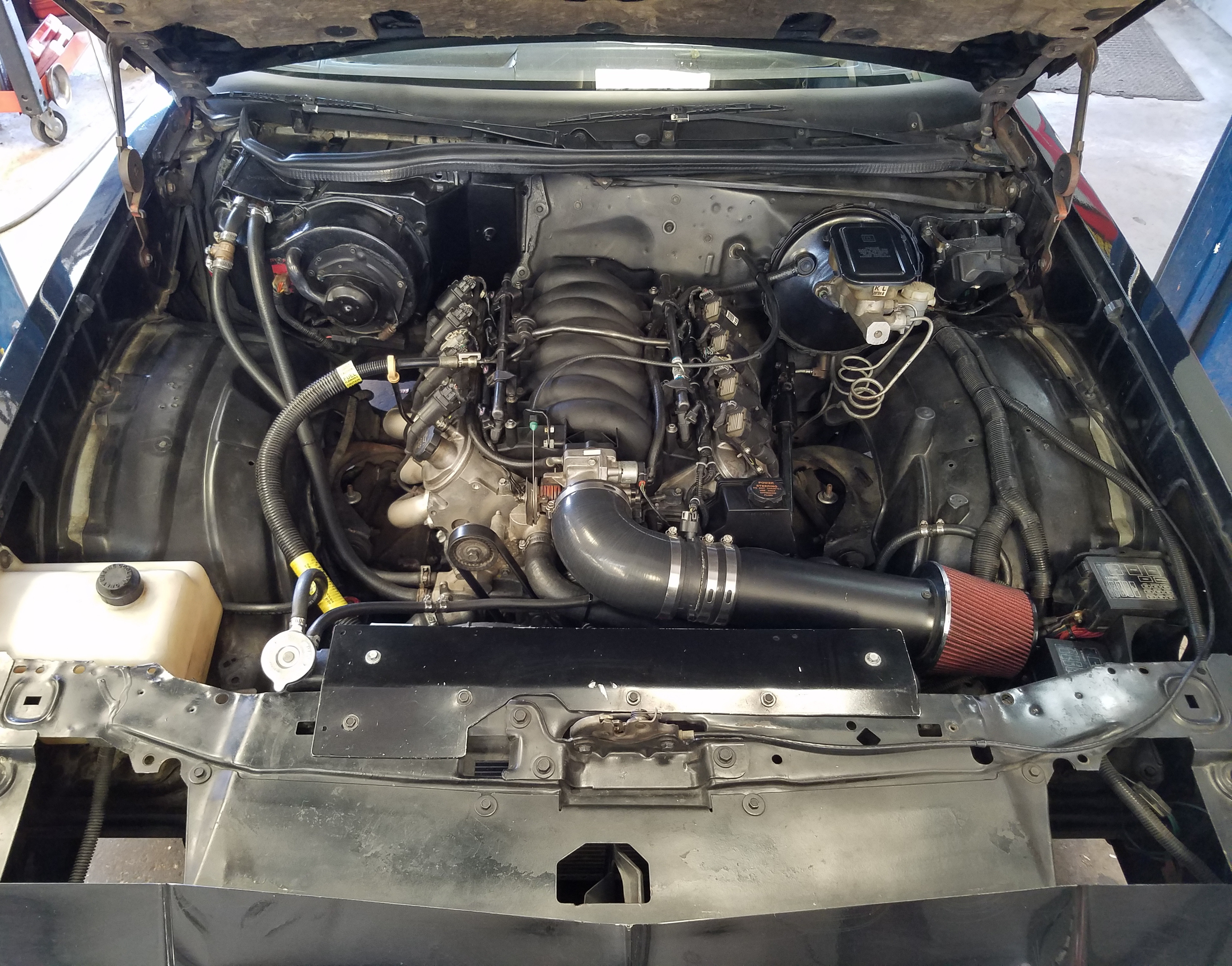

My picture above? That was cropped to focus on the coils, I have full pics also.
My OCD is neat and tidy, keeps it simple. 🙂
Which is why I grabbed a copy for my build resources. An overall shot like the one immediately above doesn't do it for me 'cause too much of the detail is lost. The cropped pic, on the other hand shows exactly the details that I need to know about to finish plumbing my own intake. The biggest side bar to that goat F*** is that I have finally found a source for the lower injector O-rings. Seems Lingenfelter's offers a set that exacting match the ID and OD of what I have. I tried specking them as EV6/USCAR from a 2011, both Camaro and Vette but they came up as the same Fel-Pro number that I already had and which was too small in the ID. So they are on their way. After that the next big ticket item is going to be a pre-oiler for this mill as I can't just yank the timer and spin the oil pump shaft with a 1/2 inch drill motor. There is also the stock manifolds to deal with as I shave off the bosses that accepted the screws that held on those tin heat guards. Most of the tabs were rusted out anyway. So I am going to see if I can fill the screw holes and then shave the bosses down completely. I know for sure that one is a pocket and clipping it off will expose the exhaust passage in the manifold so that is going to take a little thought
