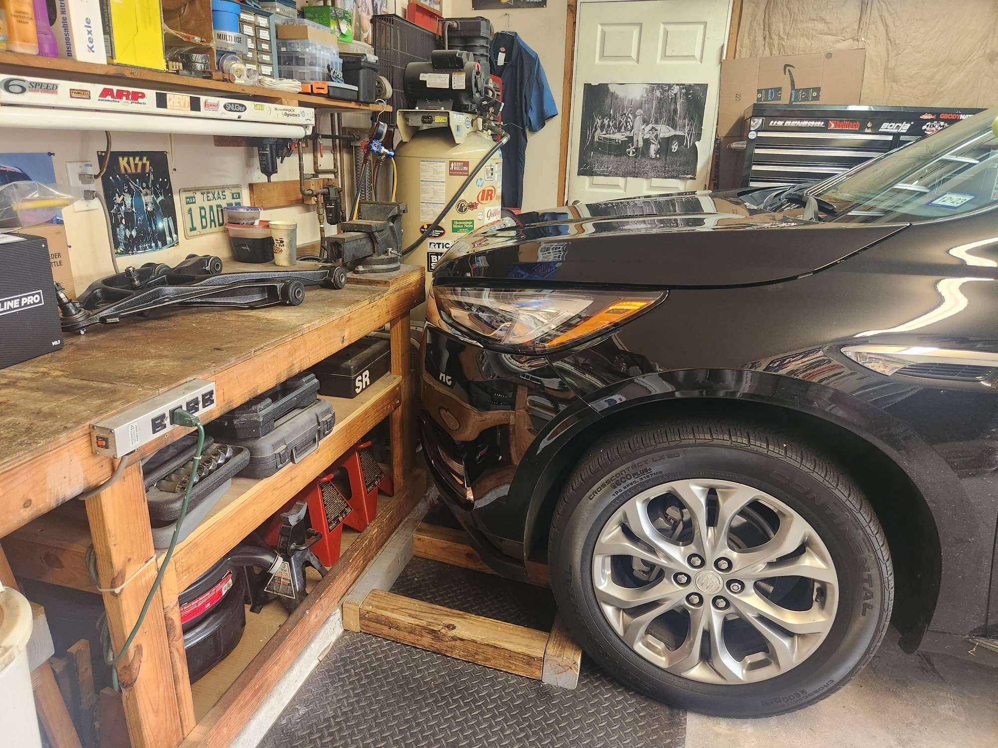

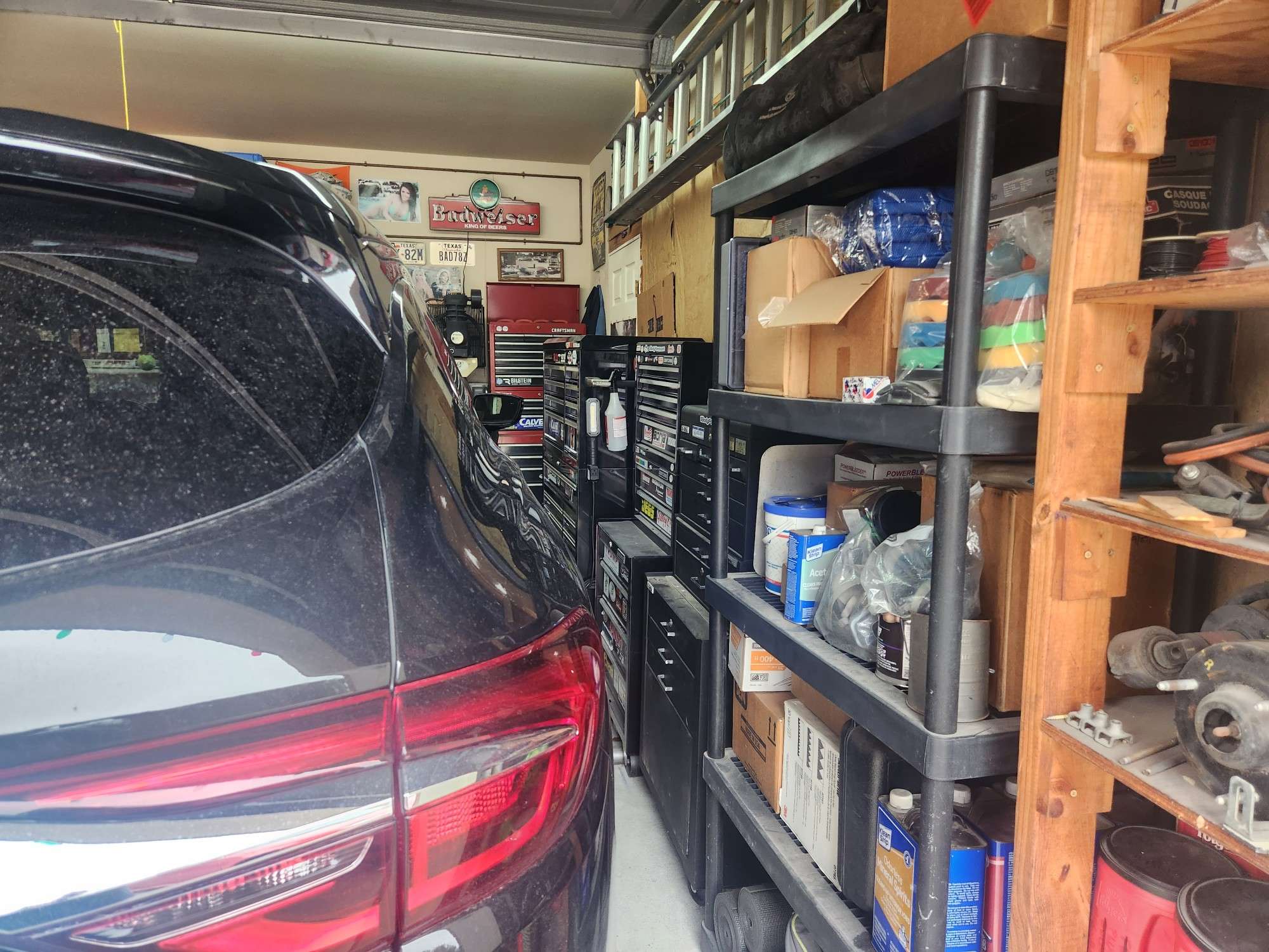

I had hernia repair surgery on the Friday before Thanksgiving so I haven't been doing much lately. I'm pretty much back to normal but I'm not supposed to do anything too strenuous for another month or so. So I get off my backside and go out to the garage. I quickly determine the three year old Delco Freedom AGM has given up the ghost. Big deal right? It needs a battery. Well, fortunately and unfortunately it broke down in the garage. Fortunate in that she wasn't stranded and we didn't have to deal with it somewhere else, unfortunate that it is dead, parked in front of all of the tools....
It's a tight fit in the garage with the workbench.....
It has an electric emergency brake. It has an electronic shifter. It won't come out of gear. It won't roll. I'm getting grumpy. I go change clothes. In retrospect I could have put the jump box on it and rolled it back some but I didn't want it dead, half in and half out of the garage (can't roll garage door down) and there was a chance for rain so we left it where it was. This was also the first time I dealt with this irritating stupidity on top of the battery.....

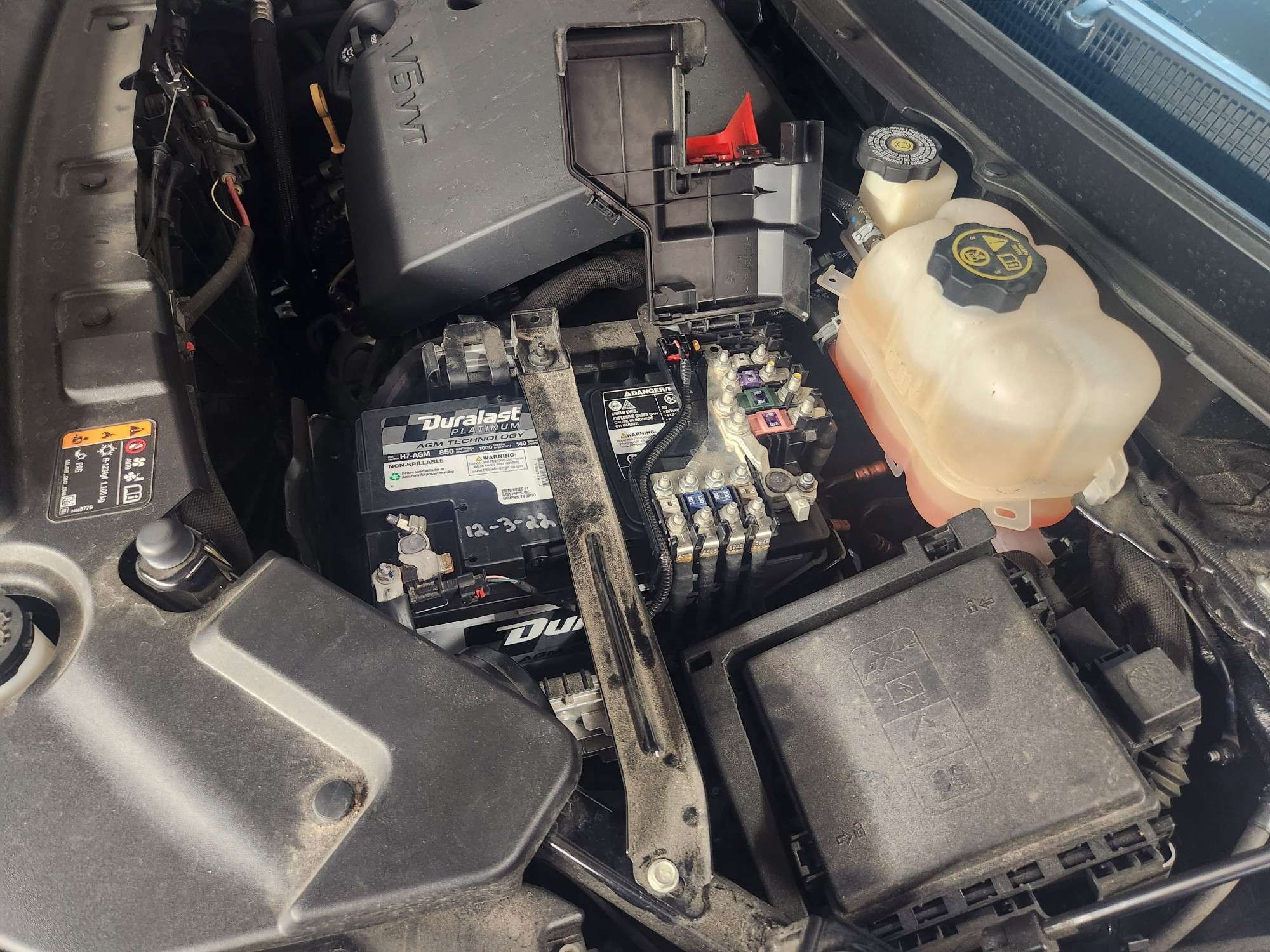

We got it, obviously, and it wasn't that big of deal but these modern helpless cars are ridiculous. We had the typical need it today auto parts experience getting a replacement battery. I got online and O'Reilly couldn't do it until Tuesday. Amazon couldn't do it until Tuesday. This made me think, ok, Napa warehouse. It's about 10 miles but it's the best chance. They show to have one. We go down there. They don't. The knuckle head that waits on us tells us the store right by our house has 6 in stock. We go there, not believing it. They don't have any and the counterman can't imagine why the warehouse told us that. We go back home. I get back online. It turns out AutoZone shows to have one and they do. It was actually a decent experience too. My preference would have been a Super Start Platinum AGM from O'Reilly or a Deka Intimidator from Amazon but it got a Duralast Platinum. We haven't had good luck with the Duralast AGM's so we'll see how this one does.
I can tell I'm really going to enjoy maintaining this car. It's the best thing for the family financially so I'll do it.
Did you reset the computer so it doesn't overcharge the new battery? New cars are programed to increase the recharge voltage over time as the battery ages. But this means that when a new battery is installed you need to reset the computer so it doesn't fry the new battery.
Reactions: 86LK and Texas82GP
assuming, of course, that requires a reset. call up Advance Auto, have them look up a battery for your car. it'll tell you right there.
