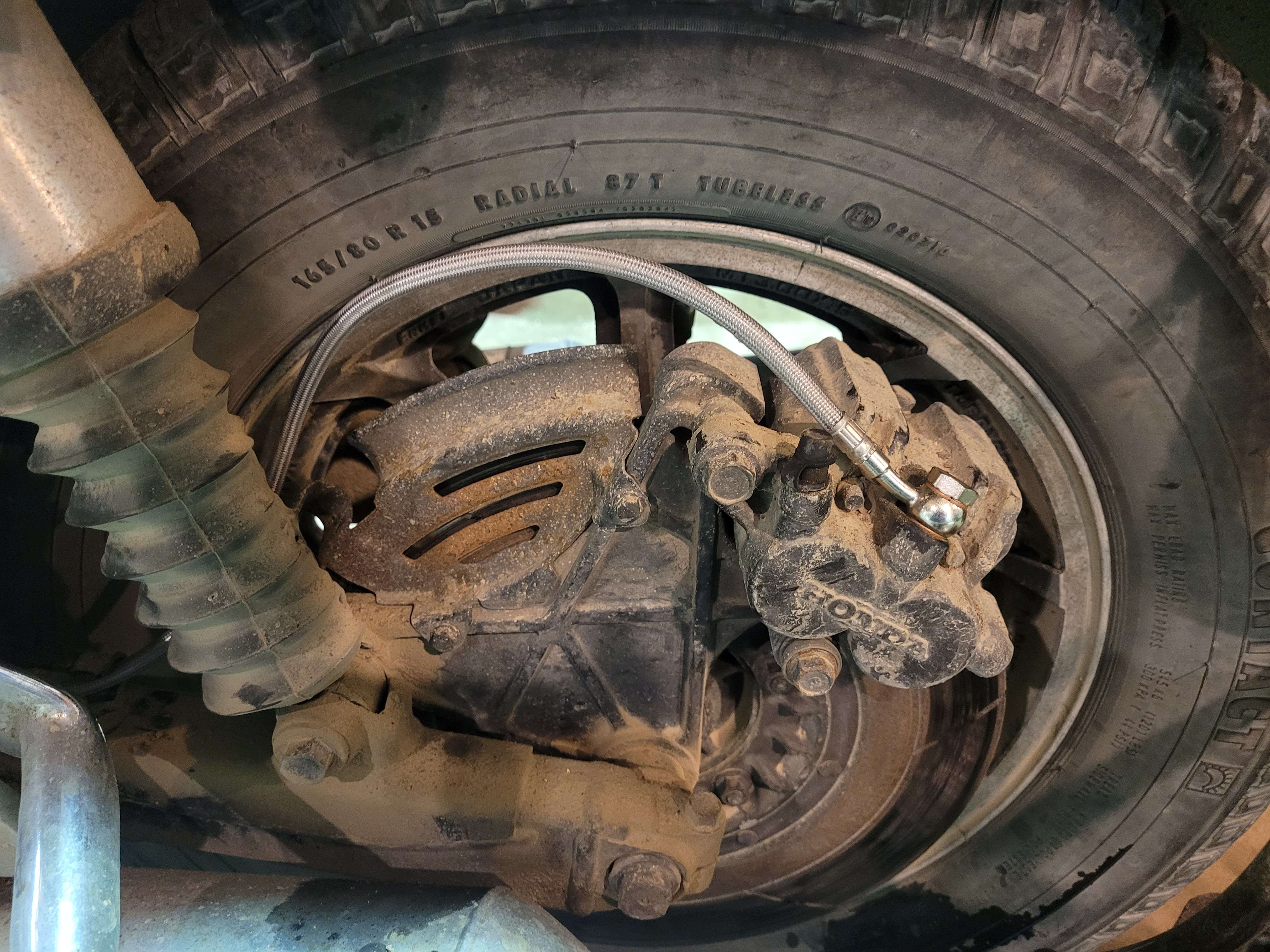

Finally got the custom rear brake line I ordered for my GL1200 Goldwing. Installed, did a full brake bleed, and got all the plastics reinstalled.
Took it out for a ride today, and it was amazing how much better the rear brakes are. Not having to push the pedal down 2 inches to get any braking force is quite an improvement.

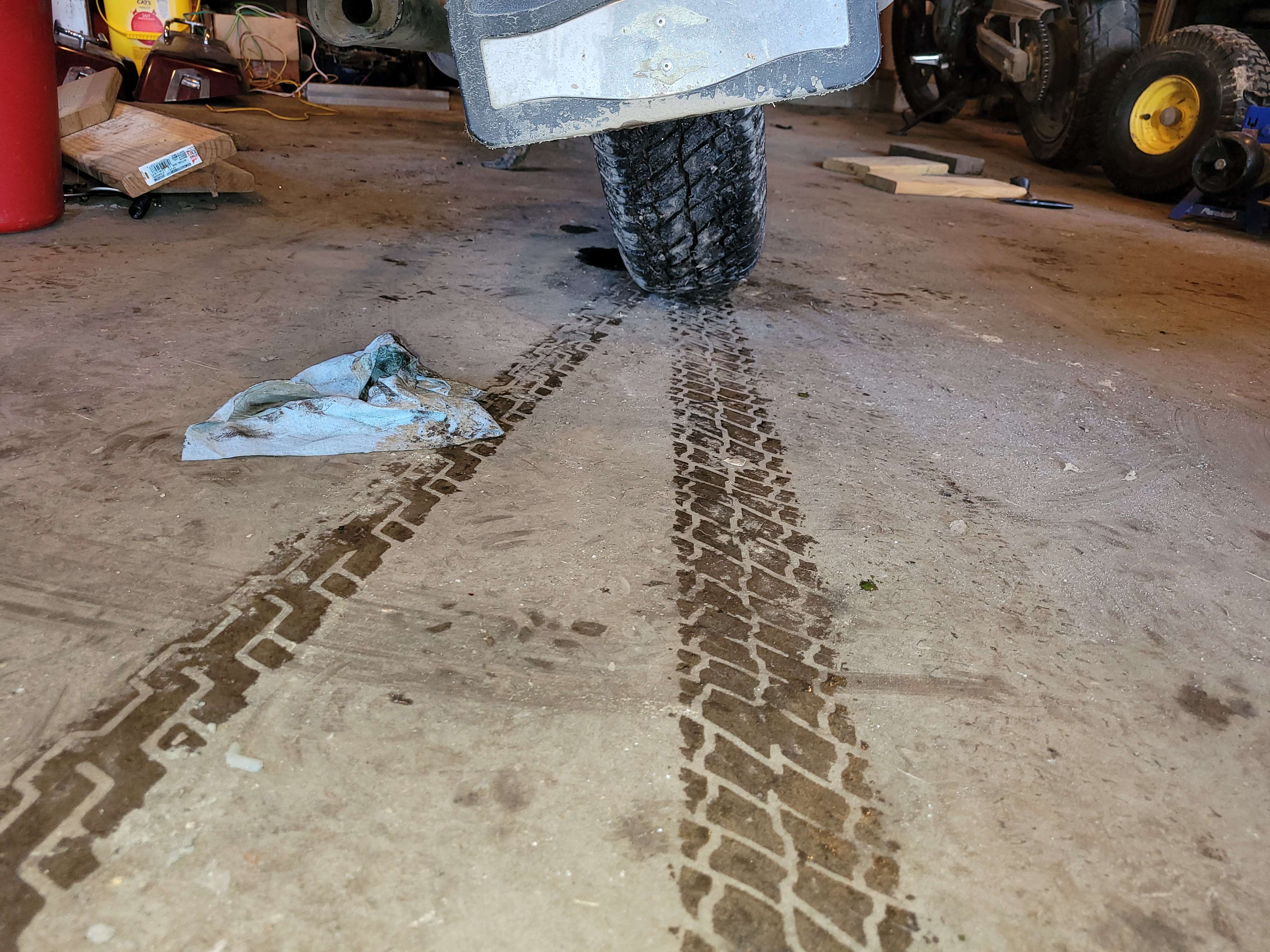

Why does it look like you have a truck tire on a bike?
Reactions: Wageslave
It's actually a VW Beetle tire. Since most of the motorcycle tires that you can find for this bike are very close to their weight limit with one person + supplies, a lot of people opt to use car tires on Goldwings and other big bikes for their higher load limits, greater contact patches and greatly improved service life.
It's called Darksiding and is right up there with which oil is best, as far as starting a fight in the Motorcycle community.

40000 mile tire sure beats how long a motorcycle tire lasts!
Yeah, that definitely doesn't hurt given the last motorcycle tire on the back lasted about 6000 miles before it started causing some nasty head shake issues in the handlebars.
