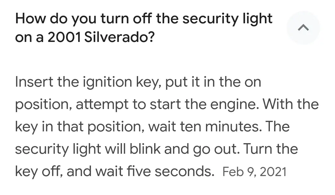

So of course you get on the internet and you find literally three different things of how to reset that light, and all of them referencing the relearn procedure for VATS. I'm trying to shut that fault light off. Most likely the little component in the column. I'll have to put a resistor in the wires.
Security light should go out once the BS is turned off in the PCM. If it still doesn't go out, but is also incapable of rendering the truck inop, just yank the bulb. I think you'd need to be talking to the BCM at that point.
Digital cluster, pops up in the little "information window" so there's no yanking a bulb. Kicks on because there's an issue in the VATS circuit, this case here most likely that probe in the key switch. I'll have to pull it apart and see if I can figure out the resistance it's supposed to be so the BCM can read it and the light turns off.
Only way to get it.
Can you do a relearn? Or is that too new? When I did a power train swap on another truck it turns out the VATS module on the truck was not getting along with the PCM. I bypassed the whole column resistor and added one that was within the range of the system, and did a relearn which consisted of starting the truck and letting it die. Let it sit with the key on 10 minutes, fire it again let it die and sit, and on the 3rd or 4th round it learned the new value and stayed running. Saved me $120 on credits so I didn't have to tune it out and sold that pig for moneys.
