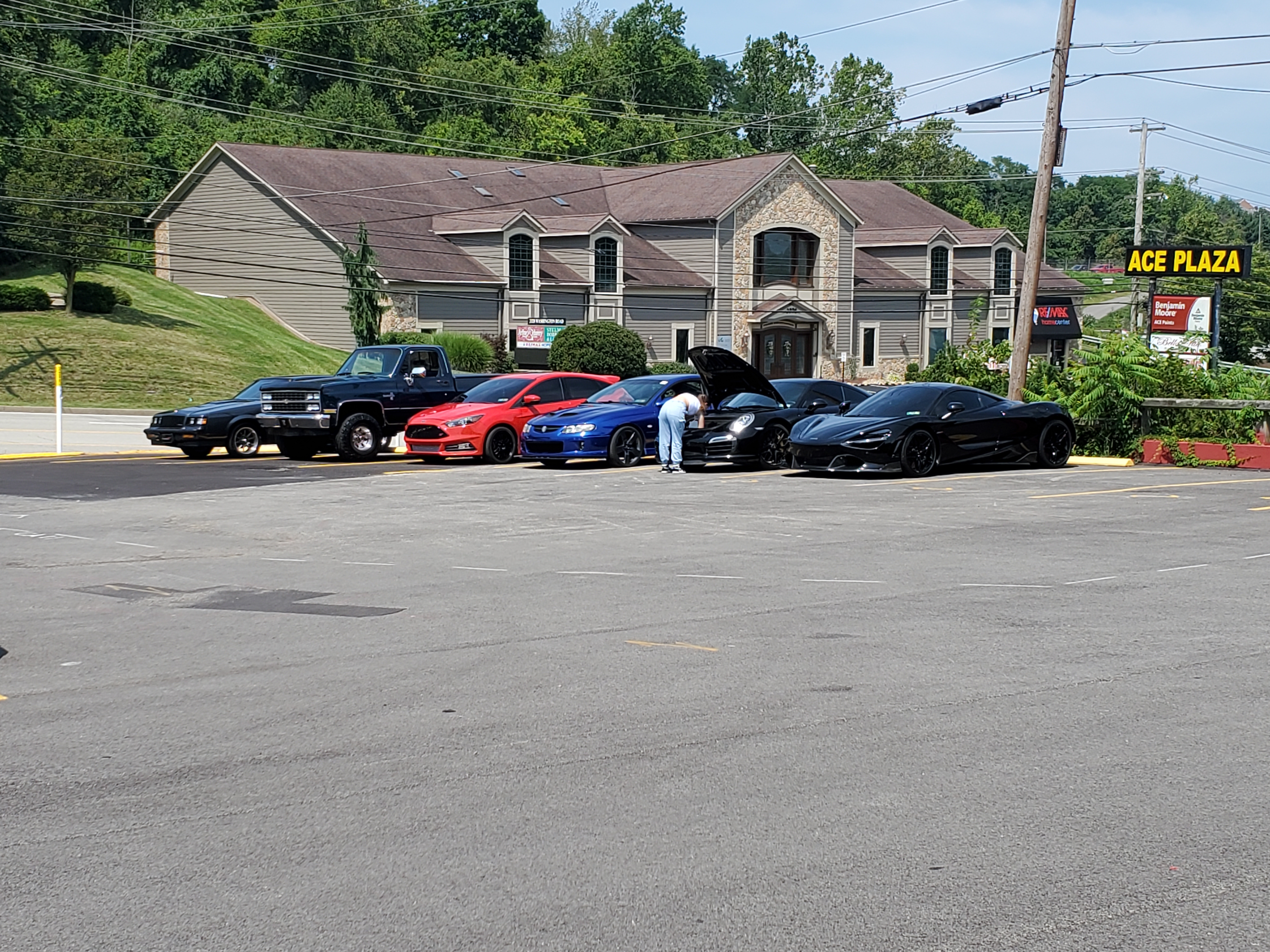

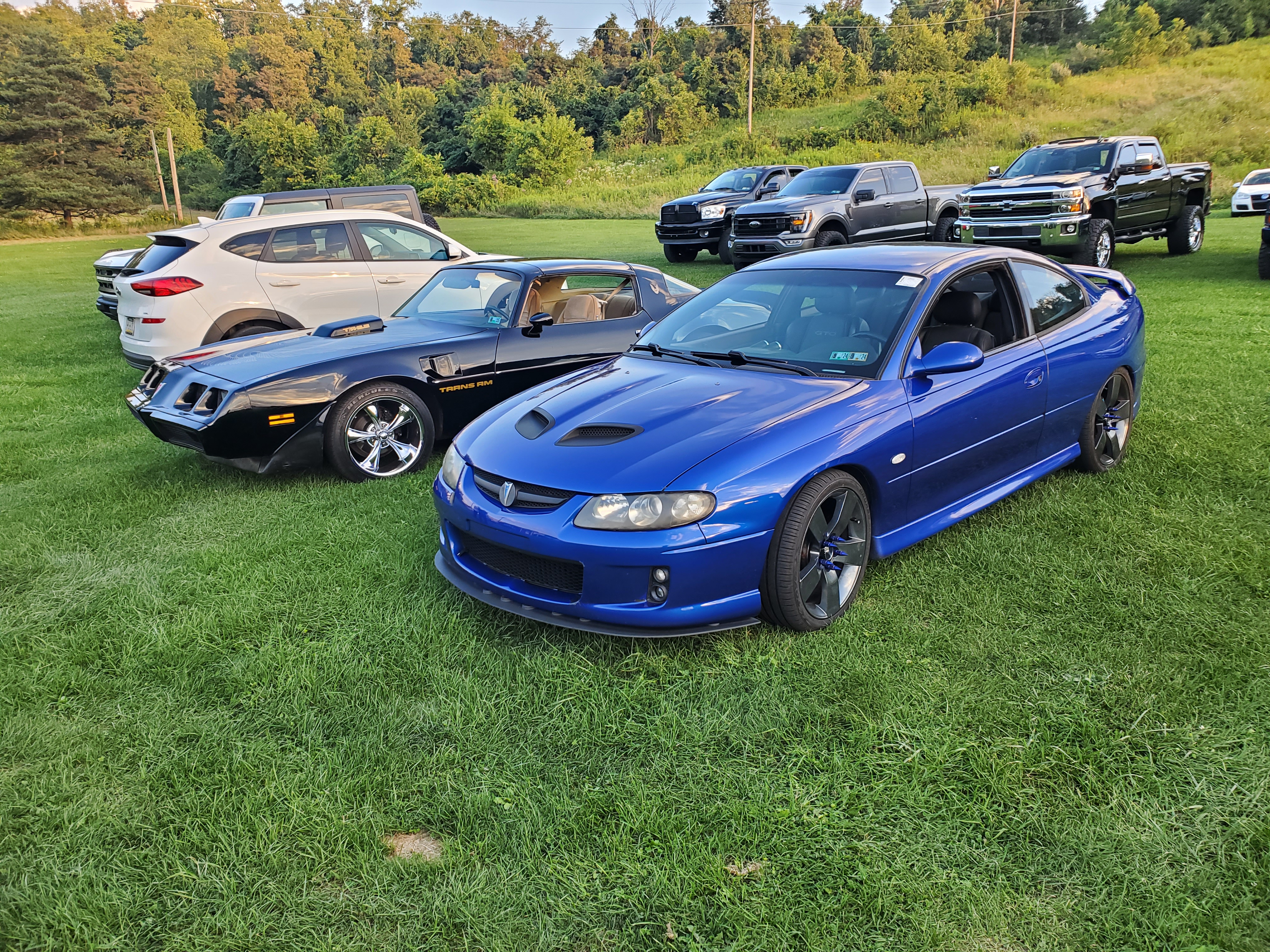

Was out in the GTO all weekend again, Friday night saw another rare sight at Mineral. Then did an all day adventure with some friends, the T Type did not handle the highway play so well unfortunately

So what went wrong with the T-type? Handling or engine or ??
Engine, before we left she was saying it was going to need a new rear main seal. Once we got to a spirited drive it was smoking a good bit and then was leaving nice droplets of oil off to everyone. When we got to the other car show, everyone else was wiping down their car to get it off, I figured it just gave the GTO character
