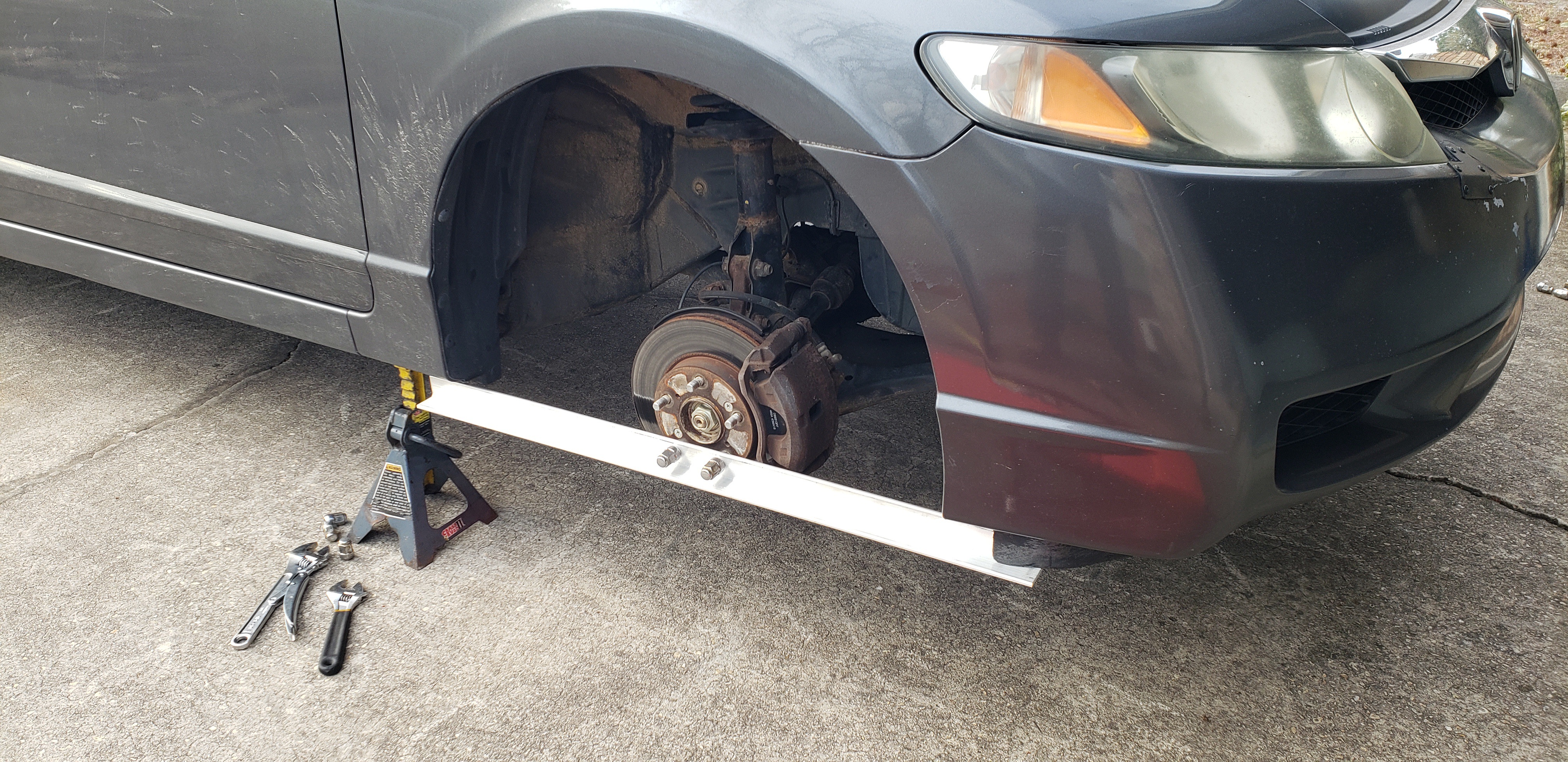

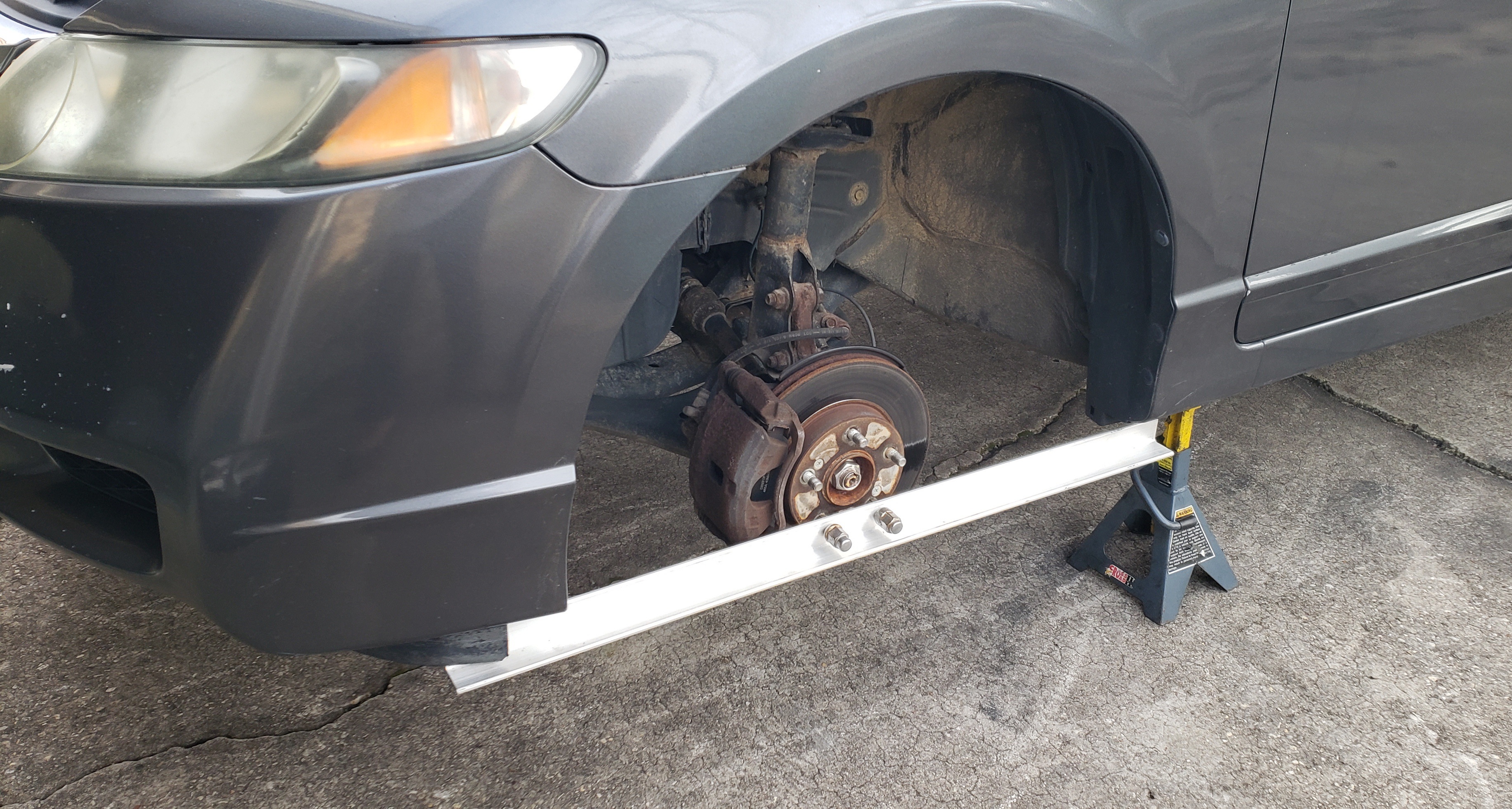

Been having an issue with my daily driver pulling to the right. New tires on it seems to make it more noticeable. The way these roads are here they grade to the right so that's a factor. Odd thing is all my other vehicles track straight then again they are RWD.
I made these out of some aluminum angle to bolt up and take a measurement from end to end under the car.
With the suspension unloaded the geometry will toe in compared to loaded. Just how it's designed. I made an adjustment already and its tracking spot on so far on flat roads, it used to have a very slight right pull. I'll see how it does on the way to work tomorrow and go from there. I get it true I'll get it up in the air and take the unloaded measurement with these bolted up.
I could load it and get it square which would be the way, but it's kind of hard to get a tape measure through an engine..
View attachment 235807View attachment 235808View attachment 235809
Set those against the tire 3-4" off the ground and fish the tape measure through that way. Toe out will make the car darty and prone to tramlining, but will not cause a pull one way or the other. The road crown can induce that, but if it has a drift or pull on a flat road you have a cross camber, cross caster, and/or cross KPI (bent knuckle) issue.
My mind was so tracked on pulling the wheels to make adjustments I didn't even think to just leave them on and use them angle pieces since they are long enough to get a good measure...car on jack stands on the very edge of the lower control arms it is...

Pull to the right was like super slight on flat roads, it's gone now why I think it was a toe issue because that's the only thing I'm messing with. It was fine before I got new tires a while back. It only pulls under acceleration, crusing it's pretty straight.
I'll have to get at it tomorrow, get it in the air loading the front as much as I can and using them two holes ziptie the angles to the wheels. Then get measurements and make it even then see what it does.

Just keep it higher than the 'bulge' @ the bottom from the static loading on the tire
Oh I completely agree why I'm going to see how much jackstands at the edge of the lower control arm loads the suspension. Just to try. If it doesn't do it all the way it'll be angles and tape under the car. Atleast I have them. I'll look up how to adjust the caster if that's needed.
