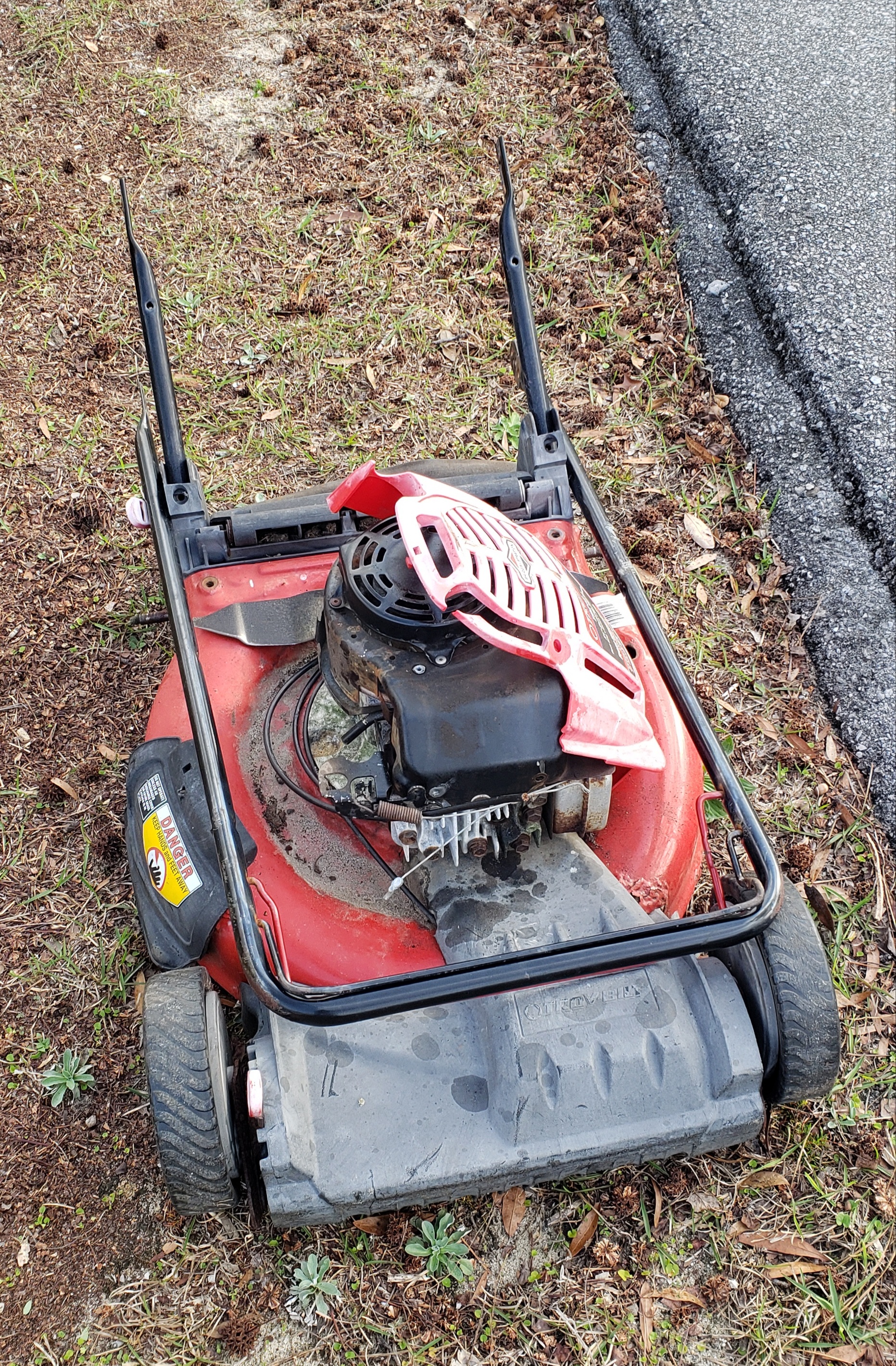

I got into the mower I posted above. Tore it down to a long block basically and inspected everything, lots of corrosion so somebody left it outside where it could get rainwater all that crap in it..🙄
Cleaned up what I could and actually got it running, had a surging idle which with these engines that's a bad governor and it's not worth replacing so I cannibalized what I wanted off of it for my other mowers since most of the parts are the same. It had a new blade on it, that went on one of my mowers. Put it on the street side for the community recycling program.
Since I had all the tools out, I took my two other push mowers and tore them down the same way to the long block. Blew them out with air and cleaned them up, sharpened the blades and they are ready to go for this season.

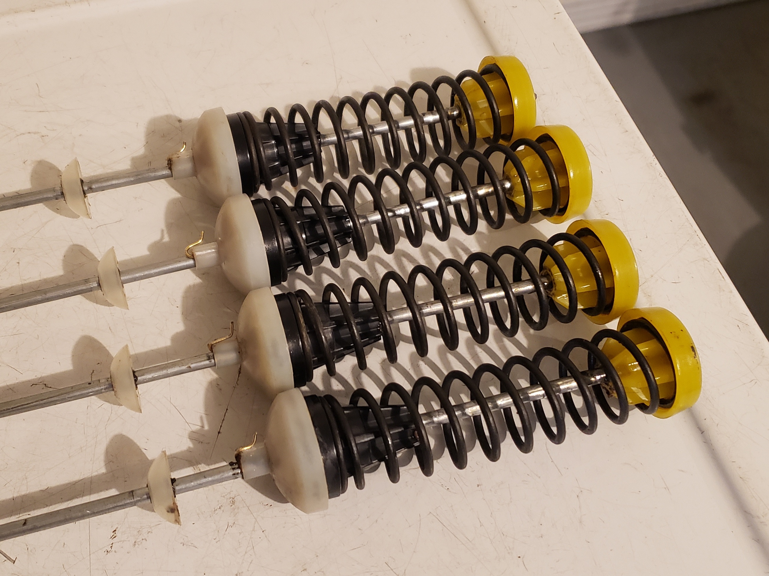

So today's project was fixing the washer. YouTube vid showed me this one. I got this with the dryer both new for $100 from a lady when I was in the process of buying my house. Definitely want to make them last.
There are four suspension rods with springs on them basically to dampen the load shift while you are washing stuff. Inside the upper piece there is a foam bushing that over time loses grip on the rod and therefore causes excess movement. All them loads over the years wore the ole girl out.. 😉
The quickest most simplest & cheapest fix was jamming a #3 safety pin through the upper piece of plastic therefore giving metal on metal friction and controlling movement of the spring rebound. That plastic sits in the bottom of the wash drum housing.
Easiest way to get them out was layed on the front, they go out through the bottom. Once they are out it takes like 30 seconds to do one. $3 pack of safety pins genius idea, I'll see how it works this afternoon. So far it's much better and movement is how it should be testing it.
Did the new shocks fix your issue? I did this twice in 3 months. It would work OK for a couple weeks then act up again. Mine cracked a ceramic wall tile the second time and that was it for me.
