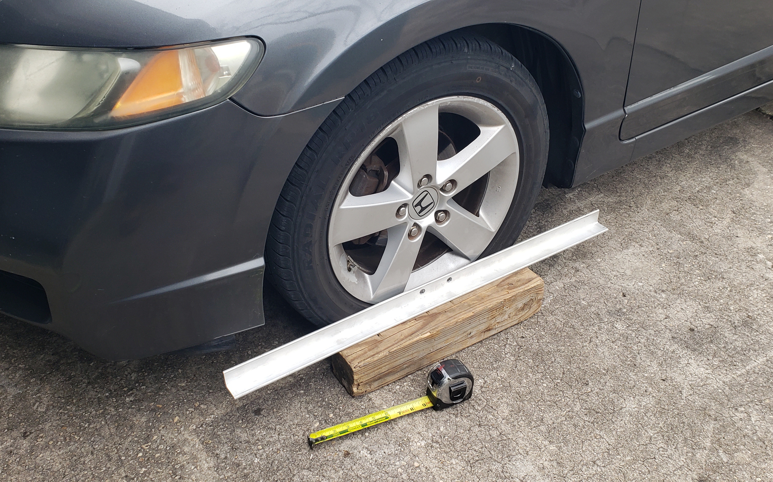

Got back into it this afternoon, basically set some blocks on the ground on both sides, took measurements off of those angles. Got it to the point where I am within 1/8 inch end to end. I'll take it, car feels smooth and tracks good.
As far as the caster...

You might be hosed on camber too from the factory. Nothing some adjustable upper plates can't fix if you get the itch. But 1/8" is right in there, I usually shoot for 1/16" for optimal tire wear but you run the risk of zero toe if you're not careful getting down that far.
I figure given it's FWD and I'm that close on an 18" off center measurement it'll be fine. This is also sitting static on my driveway, take the dynamic aspect of driving down the road which constantly changes, yup I should be good. It was 1/8" wider in the front compared to the back, which again who know's what it's doing when the front tires are pulling the car along. Feels smooth and the steering wheel is in center, I'll see what it does.
