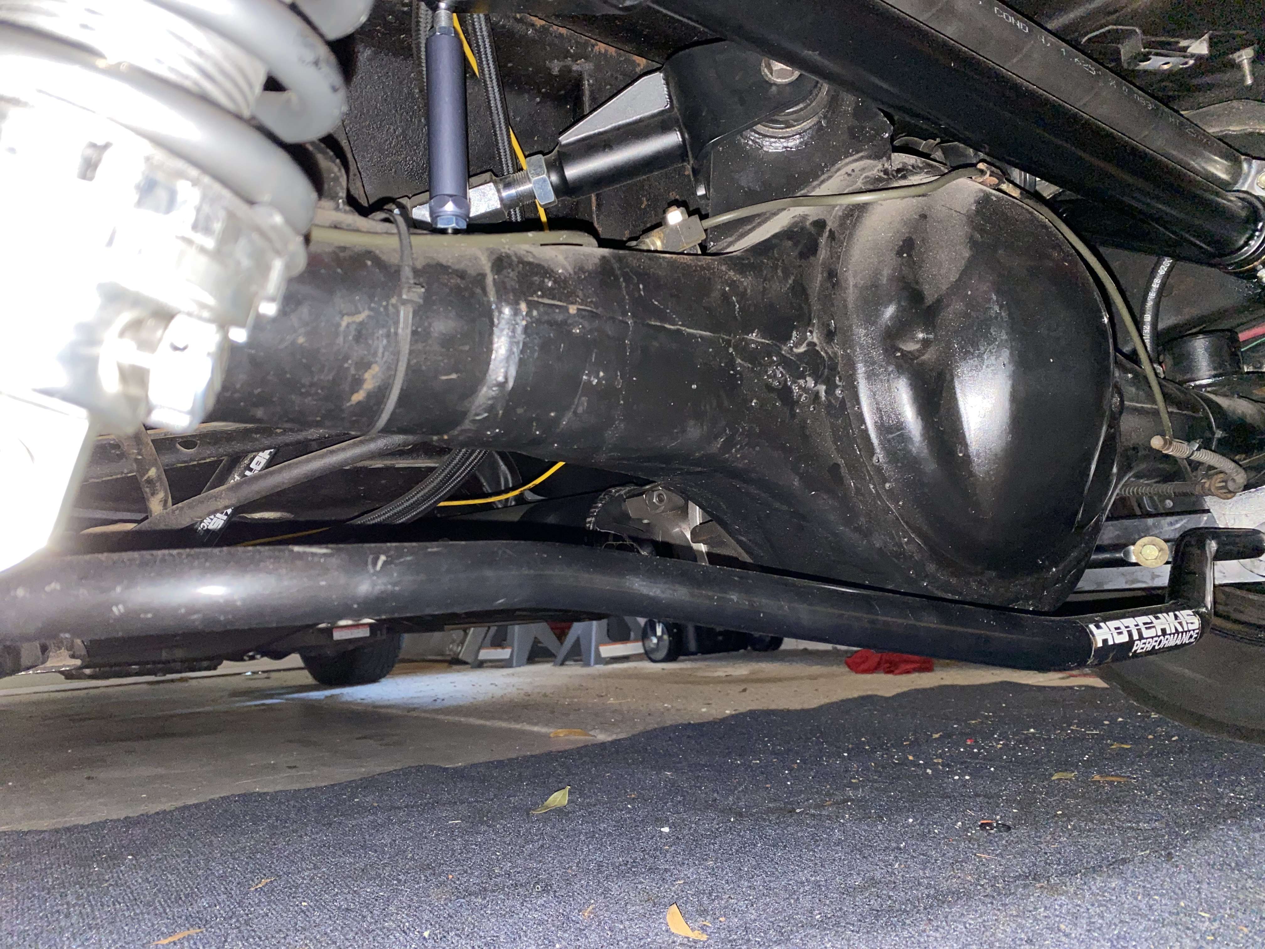

I think the axle culprit is the housing not being braced. My dads Caprice makes more power, goes faster, is slightly lighter though and is also on 35 spline axles without issue. His Ford 9” is from QP though, internally and externally braced.
Mine has no additional bracing, just a stock axle cut to gbody width:

Progress update (sad car is sad):
Added drain:
Had to move the old filler and patch:
For the back brace to sit correctly:
Built a jig to keep axle happy while welding:
Moving around to keep the local heat minimal:
Filling the gap:
Fill port:
Fill added and smoothed out:
Adding internal gussets next:
Internal gussets done:
Not as pretty as I had hoped, but the angles were weird and couldn’t get all the contamination out.
Couple more gussets and I’ll be done:
Pretty happy how it turned out. Should be good enough for what I’m doing with the car 👌🏻
