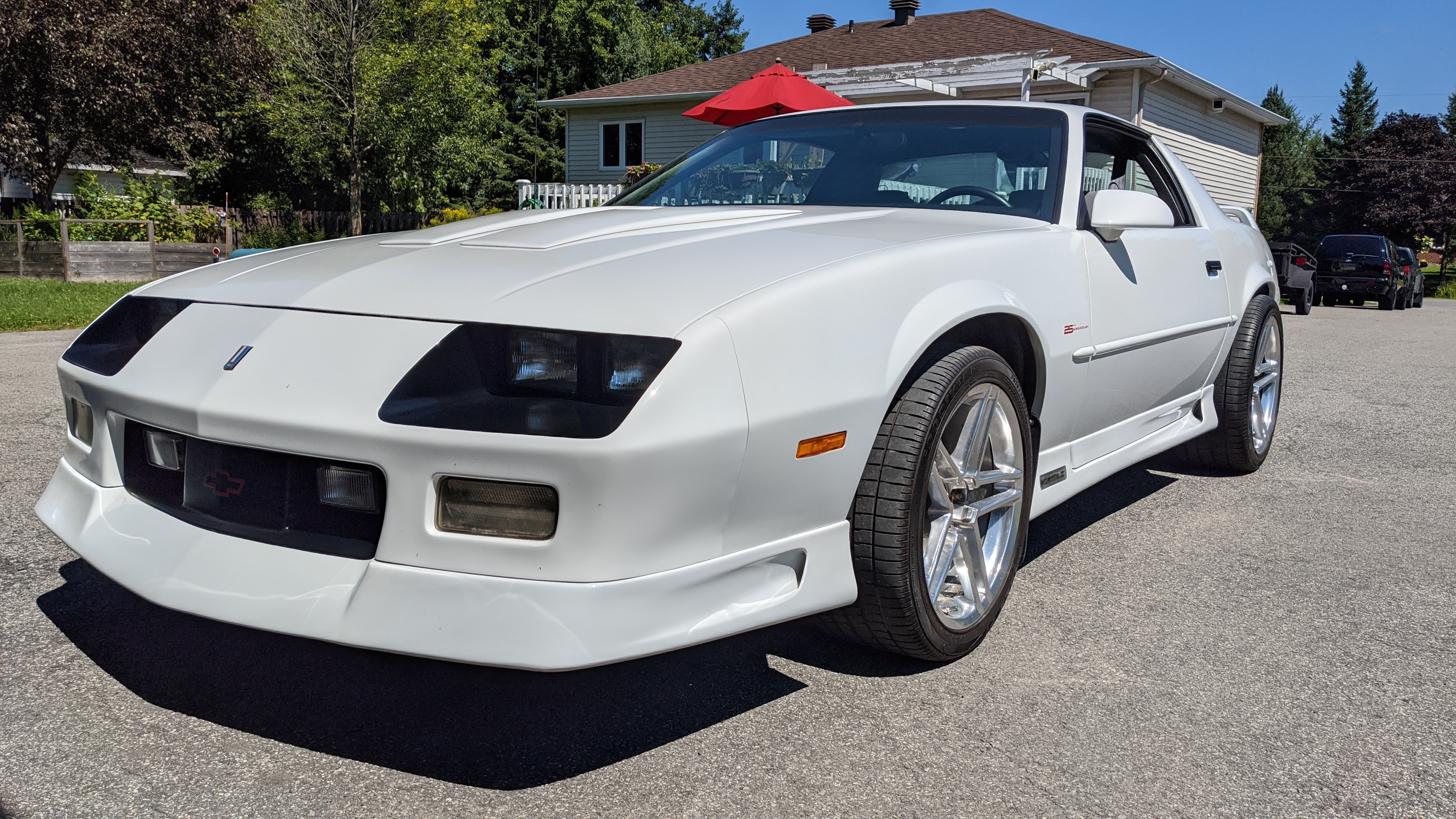

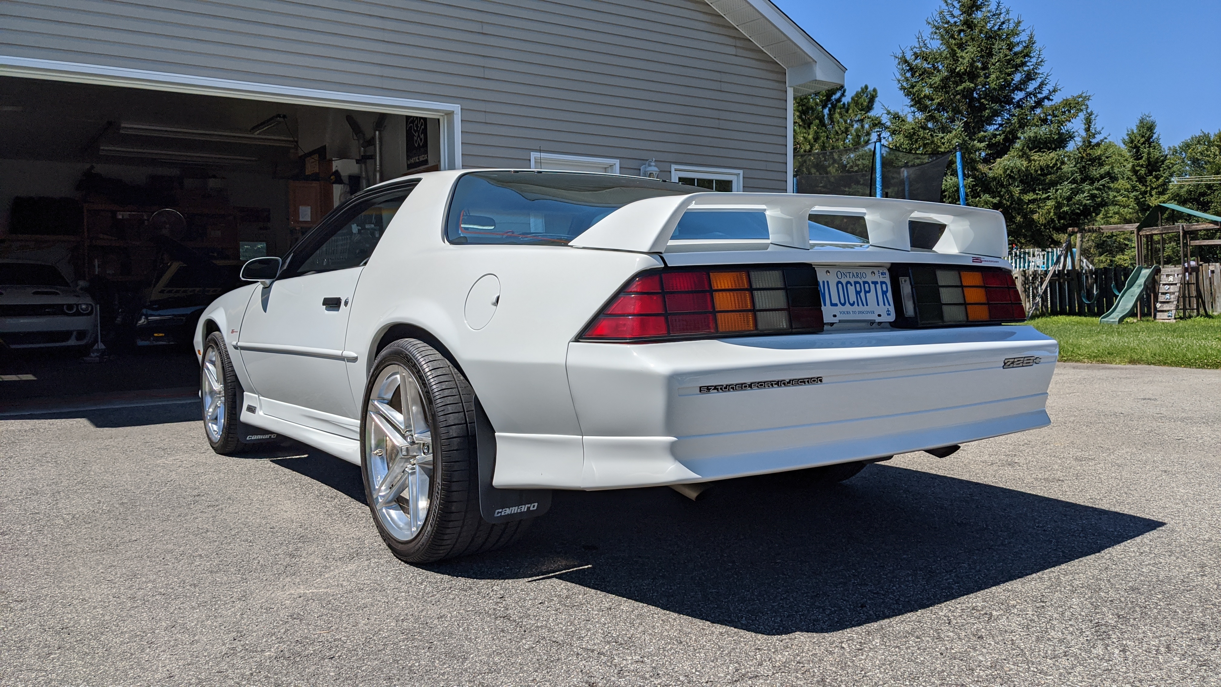

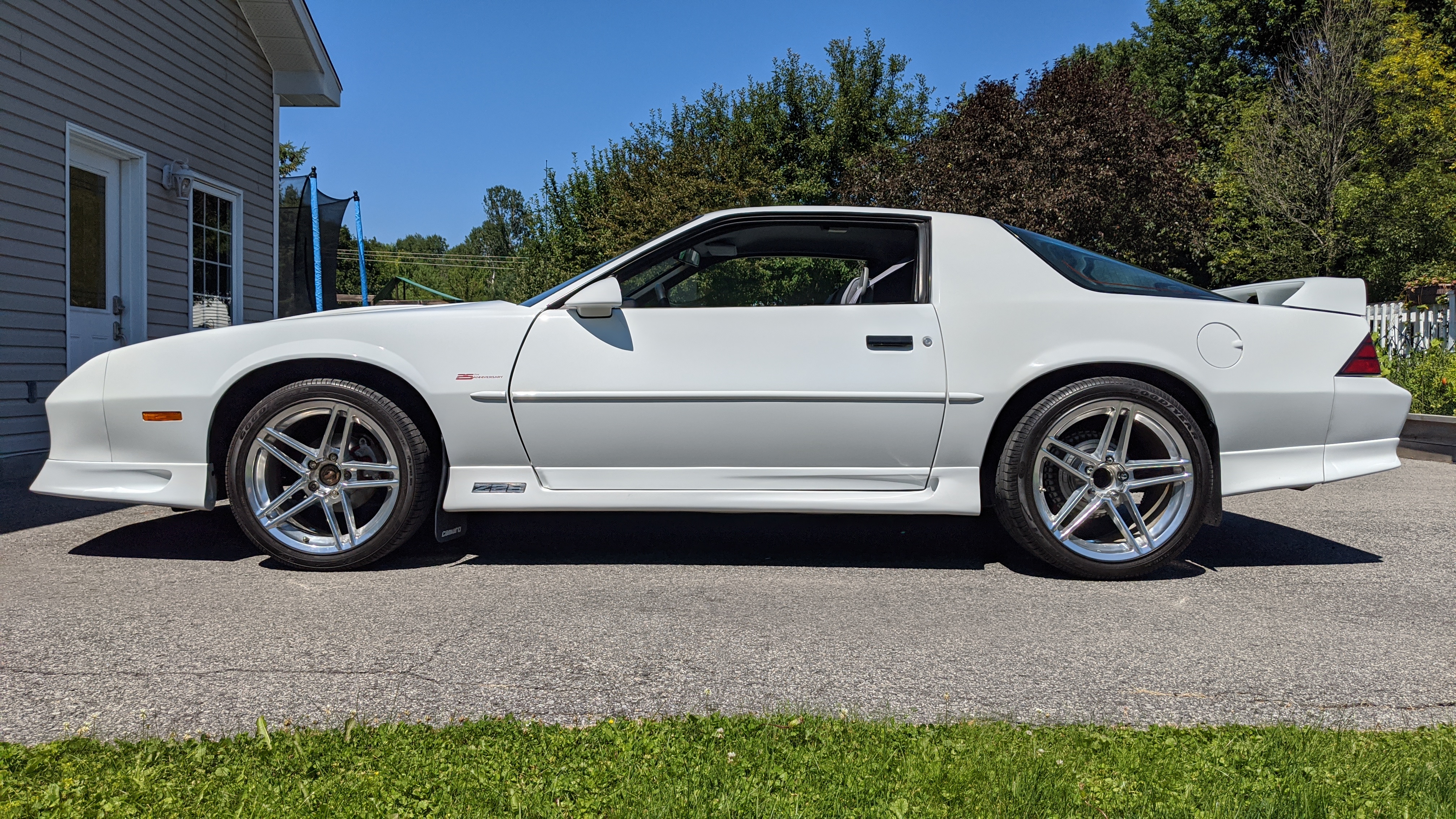

Popped the 1.5" adapter up front, and gave the back inner wheel wells a few love taps with the BFH. Rolled it around and got the suspension to settle.
View attachment 154607View attachment 154608View attachment 154609
Going to go with Bridgestone S007As in the stock Z06 sizes - they will run narrower than these GYs and have rounded shoulders.
The current plan is to go with a Watts link to centre the differential (eliminates the PHB and brace). Set of adjustable roto joint lowers and some relocation brackets. Moog 5664s up front, and something equally aggressive out back; stock sway bars will be plenty. Still leaning towards Koni yellows.
Even with this it is going to be a game of millimeters.
I have an 85IROC with 5664 up front and Koni adjustables all around. Car handles nice and not too harsh on the road. Also have a tubular K-member with tubular A-arms that has a drop in the spring bucket. Out back if you need a little drop (can't tell from your pic), I took out the spring isolator and slid heater hose over the top rung of the springs. You get about 3/4" drop from it, actually going to use the spacers in my 85MCSS with same Camaro rear springs.
BTW nice clean car, don't find too many like that anymore!
