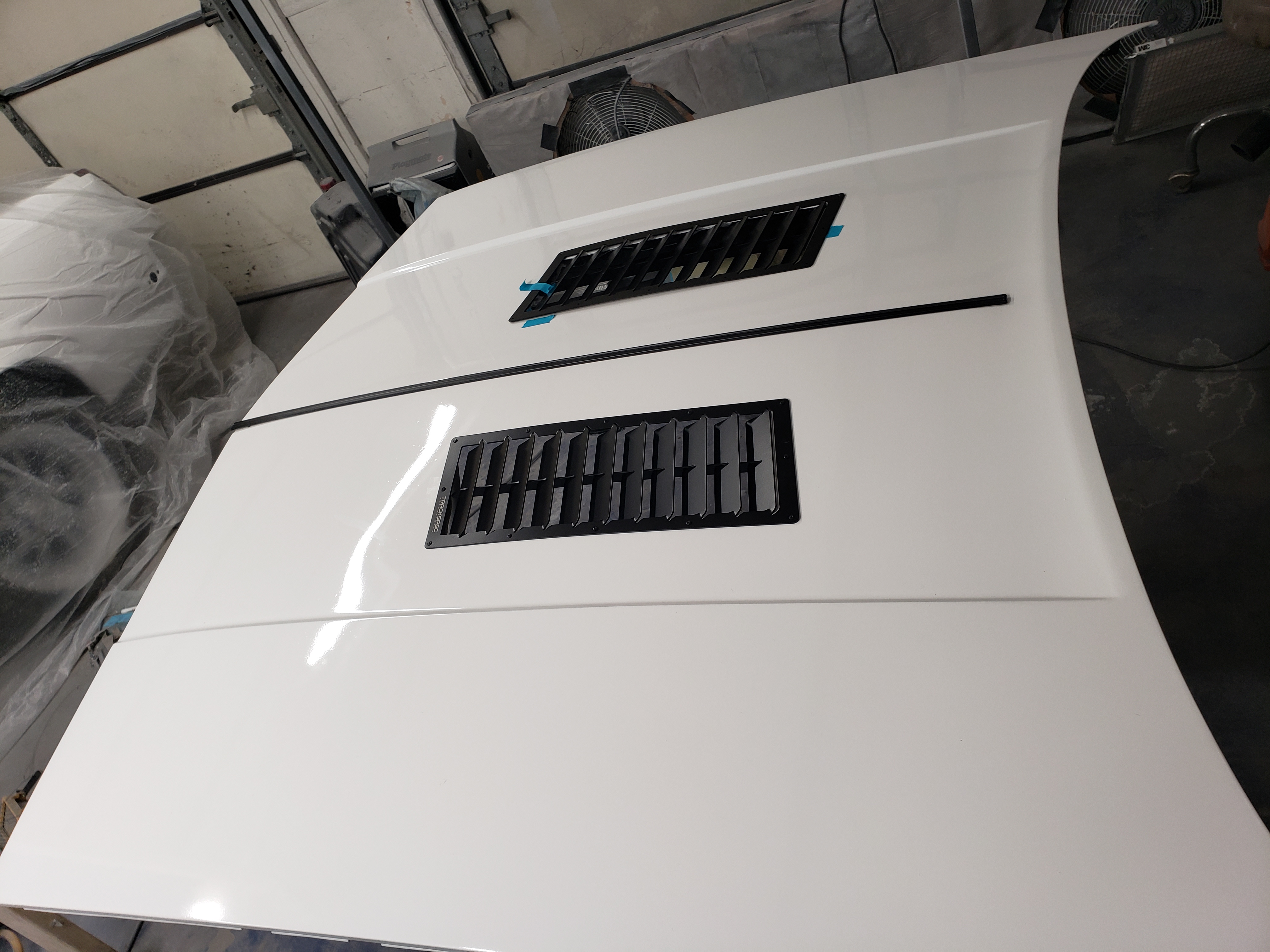

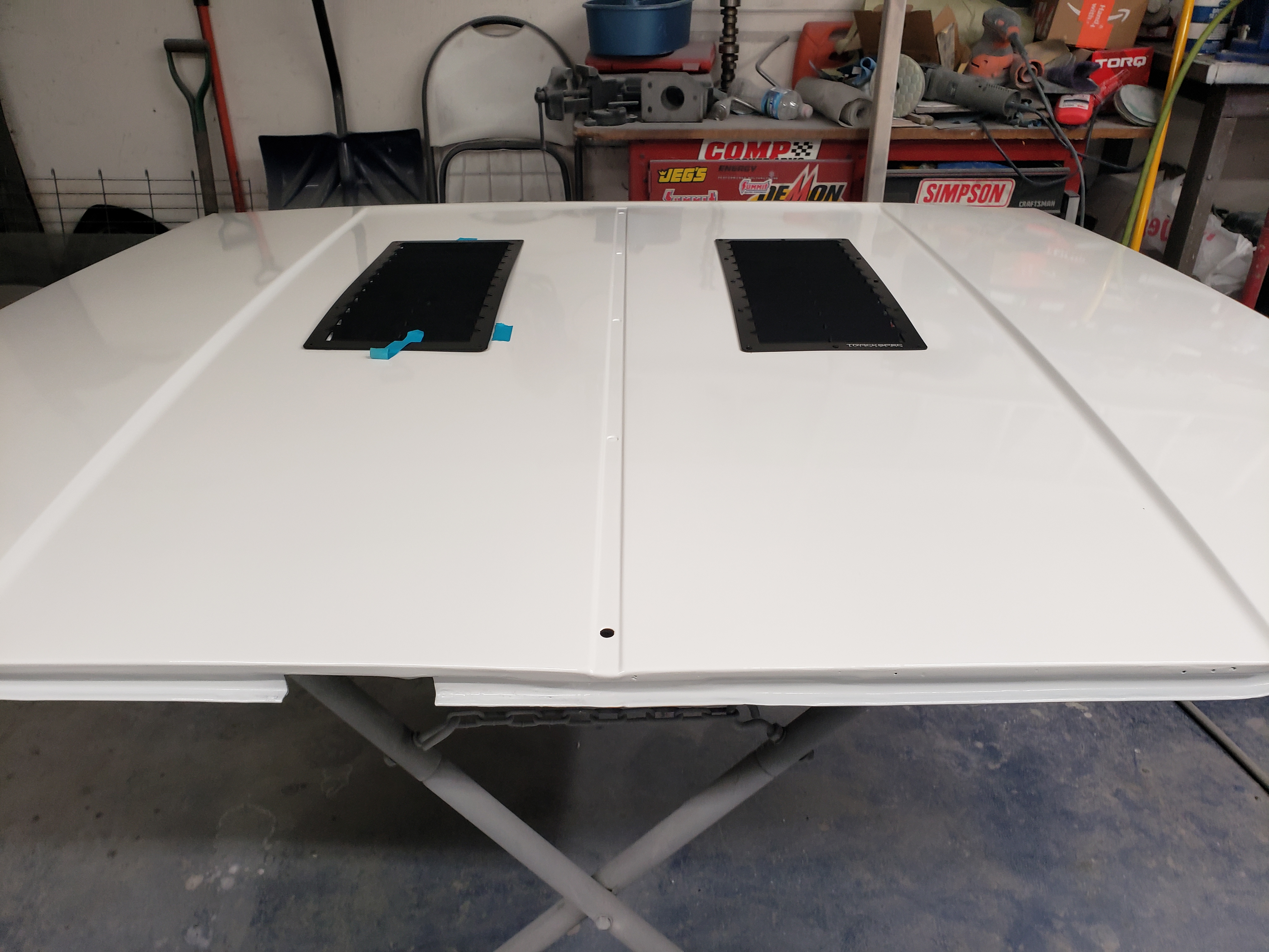

Placed hood spear just to see what she looks like. In your opinion is this too much? As in should I paint spear white or run with it as is? I think it looks pretty good but I am not one known for great taste.
it's already black,i'd leave it for now,it's a small part,you can always pull it off,change it later on.when the car's all assembled and all the trims on,it may take on a different look.looking good Tony.it'll be a car before you know it.
Looking sharp Tony!
I’m digging those hood vents far more than I thought I would. I don’t hate the spear being black, but I think it would be a little more understated if it was white. As Chris said, I’d run it as-is for a bit to see how you like it, and then change it later down the road if you don’t.
How much bright and black trim will you have on the whole car? Im thinking leave it.
Looking sharp Tony!

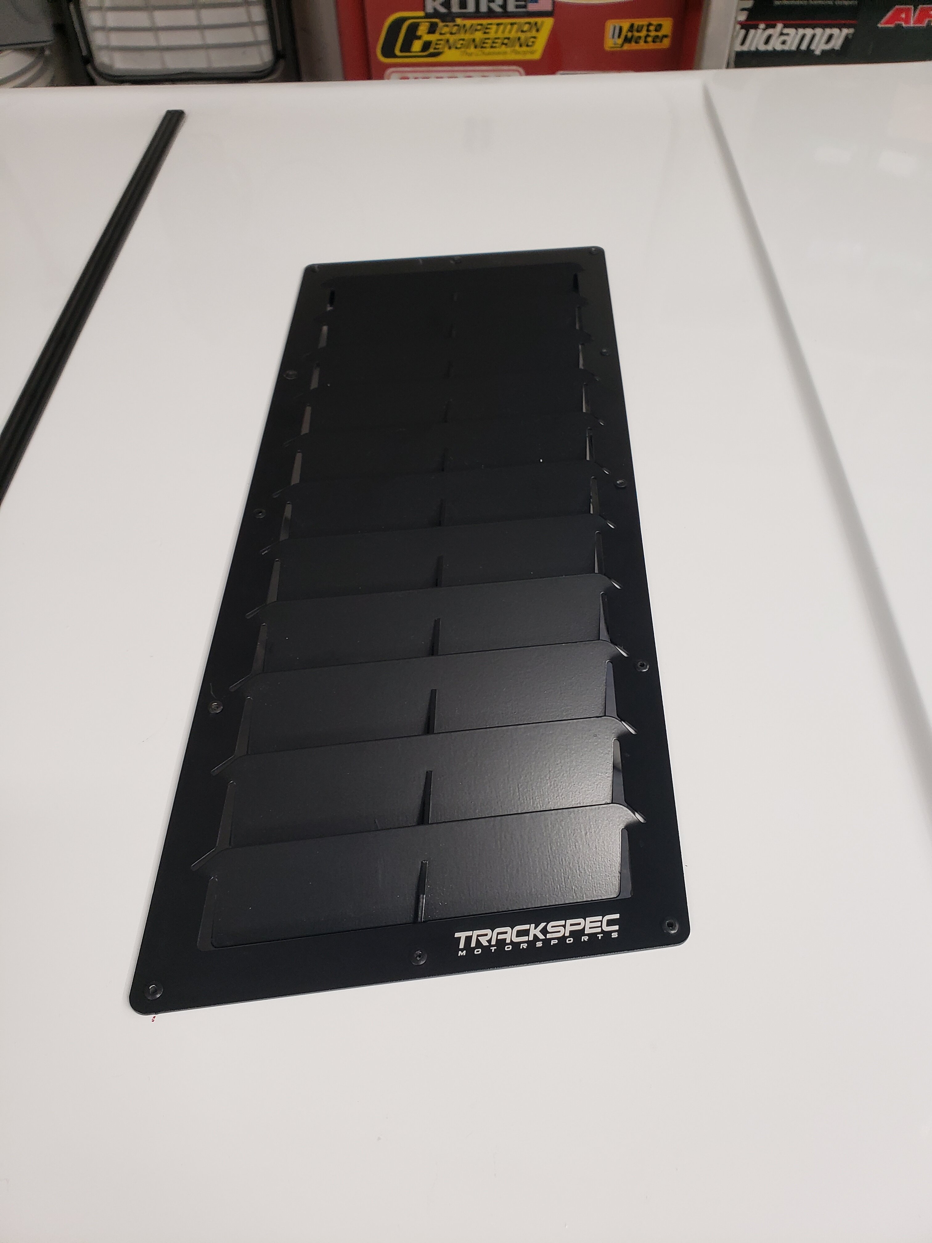

Thanks guys. Questions about mounting the spear. I'm getting new spring studs with rubber grommets to mount it as old ones were trash. There was a plastic strip that ran length of trim that crumbled when removed. That i cannot find. What would you guys recommend to replace it ??? I'm guessing i can trim foam adhesive to fit and send it.
Yeah that would work. I've got plastic you could use to make one. Thinnest is 1/4" though which I think may be too thick
Appreciate it but agree that is too thick. I'll mock up with foam and see if it'll work. The old plastic strip was paper thin. Much thinner than windshield trim stuff.
Maybe just thick mil Visqueen?
that was there just to keep from chafing the paint,you can use anything from paper gasket to a super thin strip of rubber.i aquired a 1/16" sheet of rubber(somewhere)and i've used it for things like that.
