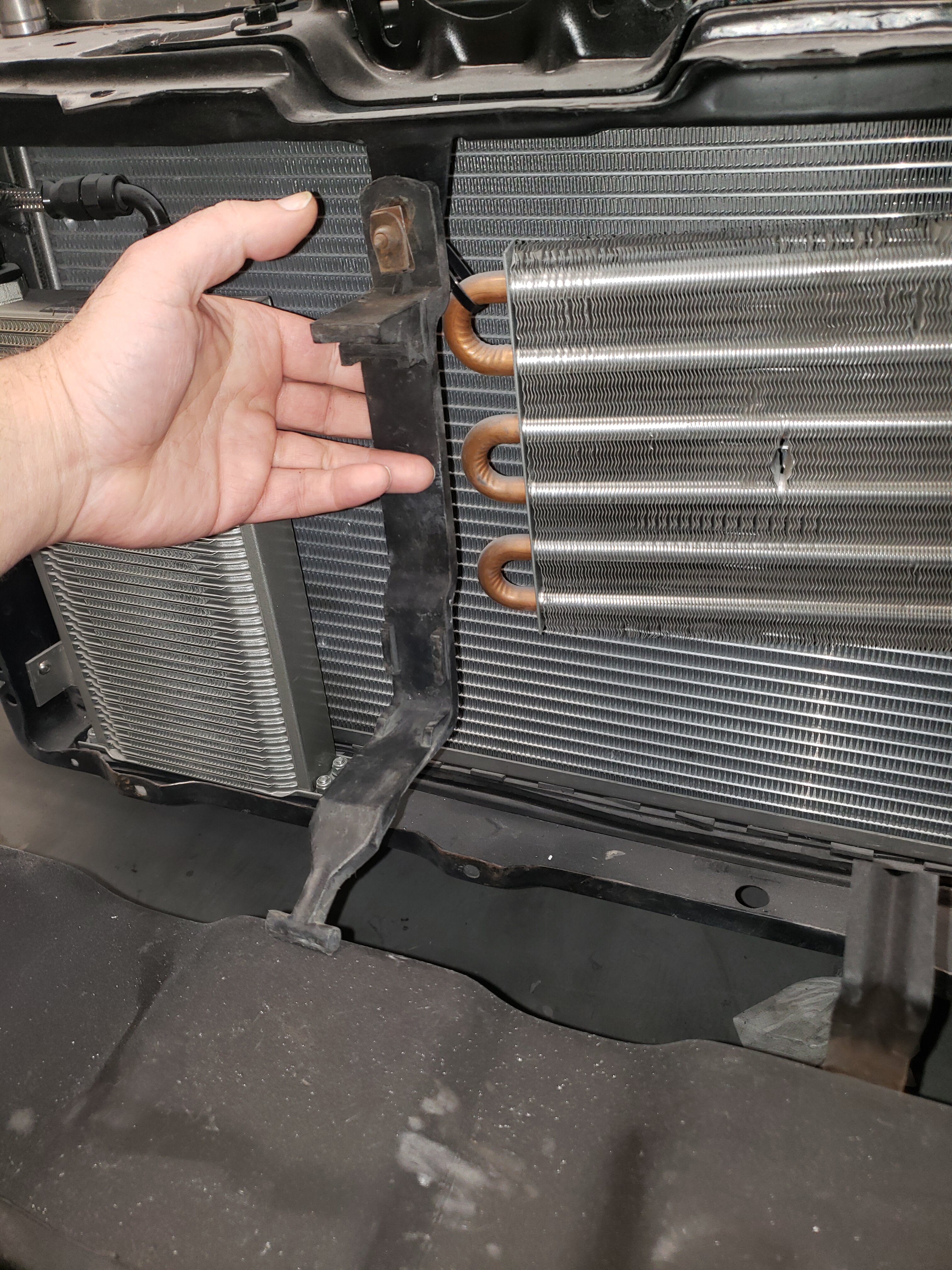

The metal bracket that is in your second picture goes where the plastic battery hold down is bolted at. The hole that his higher is for the stud on the header panel and the lower one goes to the core support or vise versa. In the picture you are holding it wrong and should be turned to where the bolts holes face to the front and rear of the car.I've searched to no avail. Does anyone have a picture of where these two parts go? It's been six years since I removed them and I can't find my original pictures. I'm sure I can eventually figure it out but if someone can explain it would save me some time. Thanks!
View attachment 232239 View attachment 232240
Yes sir I figured it out and thanks for verification.The metal bracket that is in your second picture goes where the plastic battery hold down is bolted at. The hole that his higher is for the stud on the header panel and the lower one goes to the core support or vise versa. In the picture you are holding it wrong and should be turned to where the bolts holes face to the front and rear of the car.
