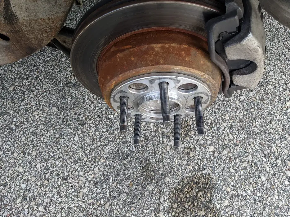

I also noticed even though my lugs were tight I'm starting to bend the studs over. These are morosso 12mm press in, I need to pull the rotor off and see if they are bending the axle flange, the stud itself or what??? These axles also have provisions for 1/2-20 screw in studs which I'll probably swap to. I wanted to keep 12mm to match my fronts but apparently I am beyond that point. They also make 14mm studs, I need to see what will fit my Year1 and 15x10 steelies.

HOLY JMOLY Batman! This is upgrade time. No matter what you find, a Set of Moser or Strange axles with 1/2" studs, as wingnutks, mentioned would be money well spent. You had to be close to a mess with this.

Yeah these are Moser 30 spline axles that are drilled for 7/16-M12 press in or 1/2-20 screw in studs.
I think I am going to drop a set of 1/2 screw in them. I am surprised to see they are bent over like that, I am honestly pretty attentive to checking them every 2-3 passes. They don't ever loosen up & although I don't use a torque wrench I do use a breaker bar that's 2ft long which I have mind-calibrated my brain to know where ~90ftlb is. I think spec on a M12 lug is 80-90ftlb. Regardless, it's not enough. I need more torque to gain more clamp load apparently.
I am going to check break away torque on the lugs with my electronic torque wrench tonight and see where I am, I expect to be enough. I run that 1/4" alum spacer to get the wheel away from the frame a bit so it doesn't rub on launch. I don't think that's causing that much of a problem as there is no indentation due to the clamp load
I can run up to 120ftlb on a 1/2-20 so I might need to look at that & carry my electronic torque wrench set to 120 next time.
Math bomb incoming..... I was accused of being an overthinker by one of the sponsor/professional performance shop/tuners at Drag Weekend. He's totally right.
An M12 to 90ftlb gets 11,500 lb of axial clamp, x5 = 57,500lb of clamp load. Coeff. of fric of clean steel on aluminum is .61 so there is 35k lb of clamp load on each wheel or 70k for both wheels.
A 1.57 60ft gets 1.33G
And the car weighs 3800lb (rough guess) so there is 5050lb of force that is see between the tires and the road. At a 28" tire, that's 14" radius so there is 5900ftlb of torque at the axle. 5900ftlb at 4.75 diameter bolt circle, or 2.375" radius is 30,000 lb.
Basically, for a 3800lb car to 60ft in 1.57s, there has to be 30,000lb of clamp load between the wheel and tire at 4.75" bolt circle to prevent the wheel from spinning on the rotor. I should have 70,000lb of total clamp load BUT that's for both wheels. If at any point only one wheel is taking 100% of the load which is possible, each wheel only has the capability of holding 35,000lb.
So the math checks out. A 1/2" stud @ 120ftlb gets 20% more clamp load which gets each wheel up to 43,000lb of clamp load. 1.43 safety factor instead of 1.16.
A 1/2" stud has something like a proof strength of 20klb so I could run it up to 140ftlb if need be. Should be fine on a steel wheel.

I was thinking maybe it just bent the axle flange locally but nope, the studs are bent. They were about 80ftlb checked with my digi torque wrench.
1/2-20 screw in studs incoming
Where u using conical lug nuts?
100ftlbs too much on a 12mm stud
