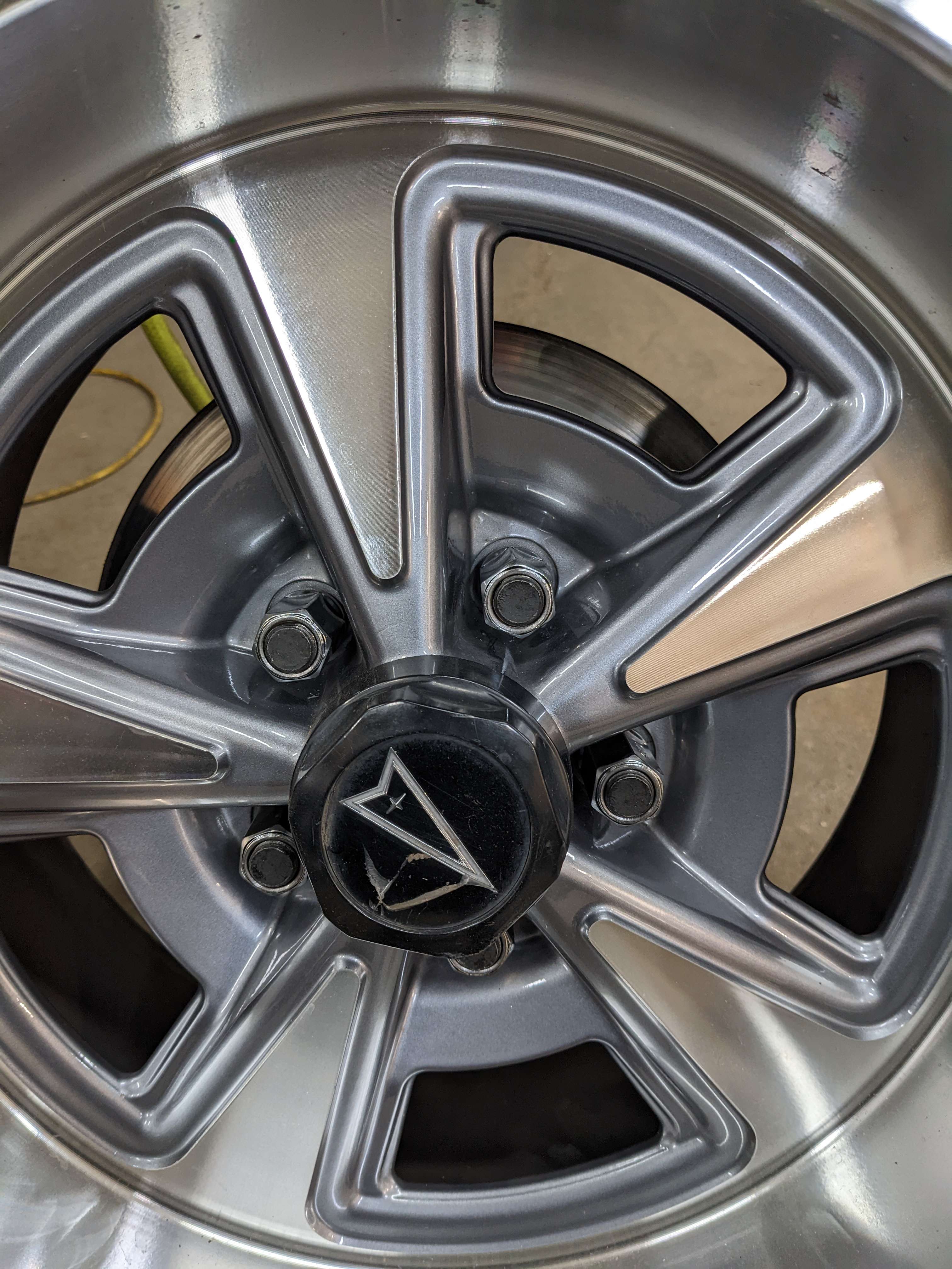

Drilled & tapped 5/8 holes into my new sacrificial torque twisters
They fit. I wish I would have went 1/2-20 Because I did have to drill these out one size and they're snug to get in, but it's done
But it's done, good to drive for another few weeks.
I think this car is going to the in laws for storage again for the winter and the cutlass is going to get a trans and efi upgrade.
What lug nuts are those? I'm having a hard time finding conical nuts for 5/8 studs are arent huge
I had the same problem. These use a 7/8 socket
Gorilla Automotive 76158HT
That seems to be about as small as they get I was looking at the Moroso 46340, which also uses a 7/8 socket.
