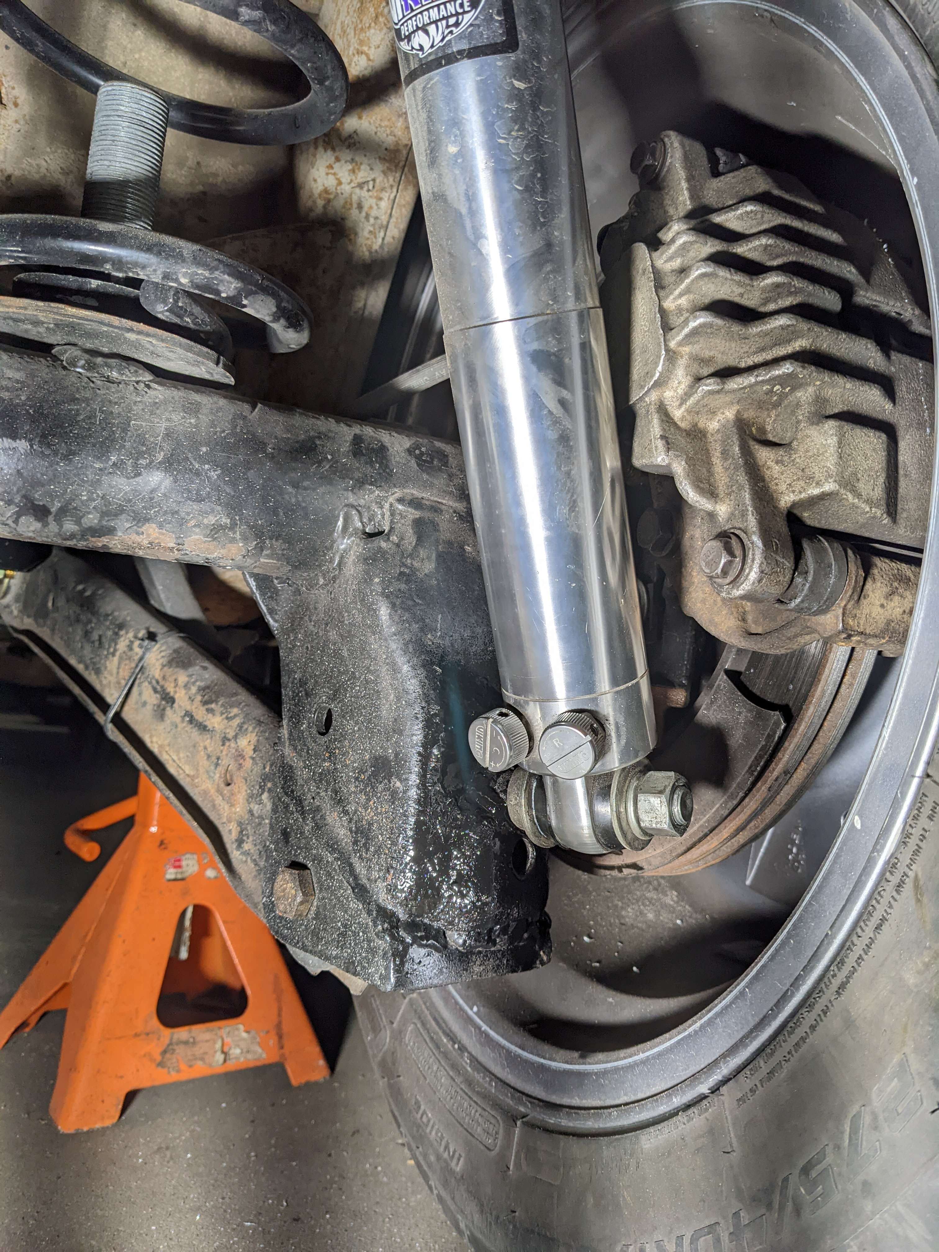

So you think that the shock is hitting full extension? It looks like it might be. Now you’ve got me thinking.
Oh, I've spent many a minute watching the videos.
Honestly, I don't know if it's hitting full extension. I am pretty sure when I raced at BIR in Sept for T&T when the shocks were loose I did. Since I've tightened it up, I don't know. Not sure how to check without a travel sensor. I have an Oring on the rod of the shock that can tell me if it's bottoming out as it just moves the Oring to whatever the most retracted position is, but I don't have a method to determine how much extension i'll get.
Checking the travel actually came from my post on the FB drag race suspension group. The guy that owns the Grub Worm T56 camaro that runs mid 6's said to check that and it totally made sense. He has like 6" of separation travel which is obviously a different, much more serious setup than mine.
I paid for 7" of shock travel, I am going to use it!!!
