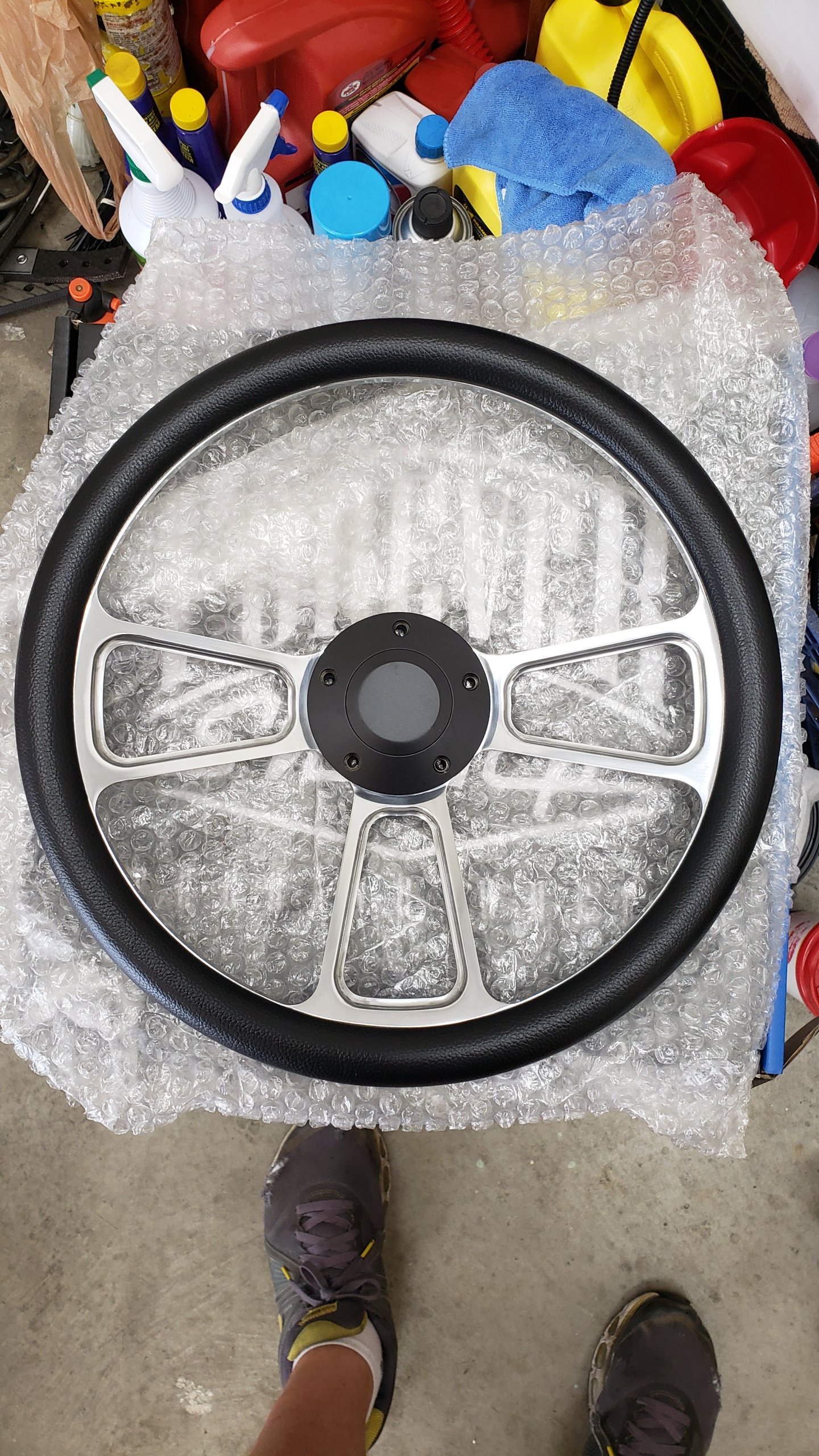

Got my new steering wheel in today. Gotta customize it a bit, should be cool looking when done. On another note, can't get the Cutlass to stay running yet. Been doing some reading to see what other changes need to be made.

Very nice. Grant ???
