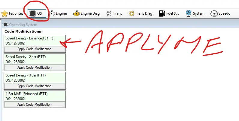

Damn shame I didn't travel with my tuning laptop so I cannot send you my segment swapped P01 tune. Fortunately I do have HP Tuners on this unit. The following is from memory...
Do this:
View attachment 121164View attachment 121165
Or do this and it will default to SD:

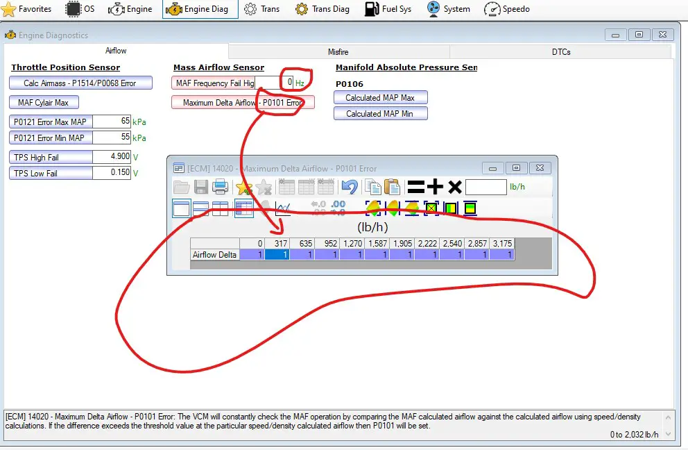

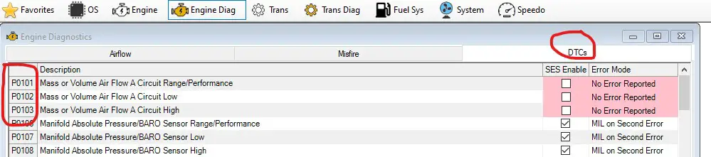

Here is some of the process: https://forum.hptuners.com/showthread.php?48010-MAF-properly-disabled-for-Sd-tuning
