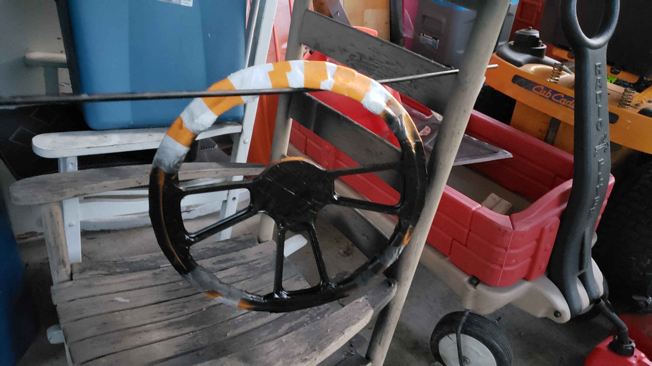

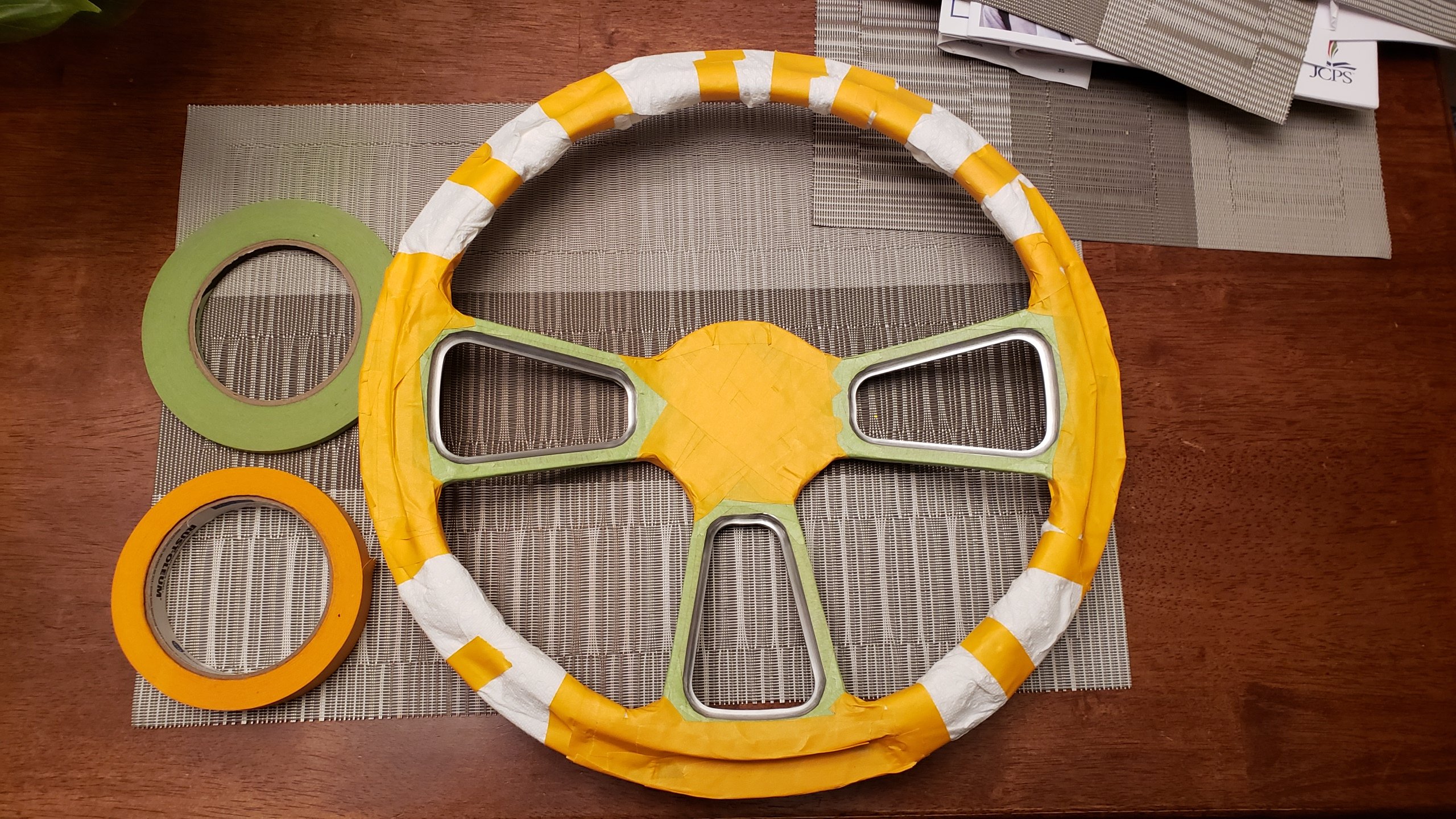

I did a quick masking job at first so I could scuff the areas to be painted with a red scotch brite pad as Donovan recommended it. Unmasked, wiped down real good, then remasked with better 3M tape to ensure crisp lines. Yes, that's paper towels...had it on hand so it got used. I hit the areas with Bulldog just to ensure adhesion, then several good coats of SEM trim black.
View attachment 121240View attachment 121241

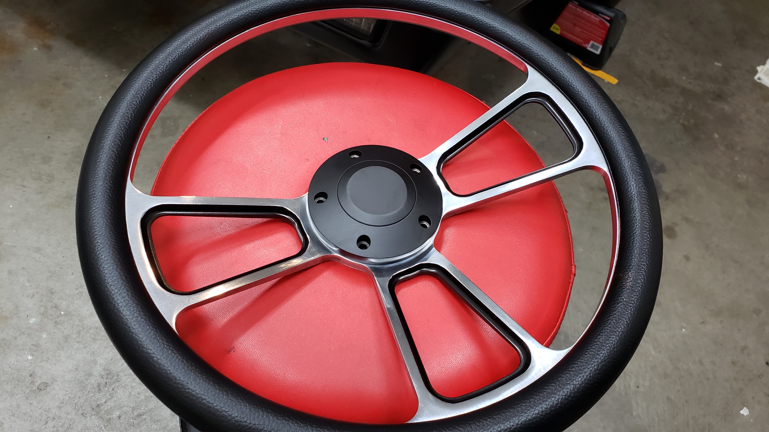

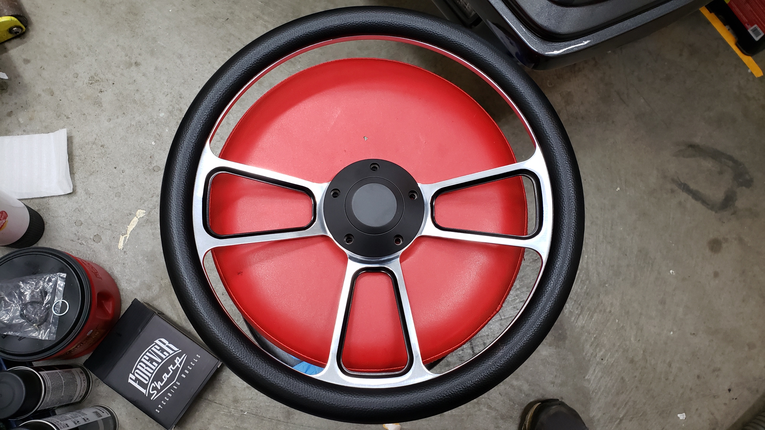

Gotta admit, masking/unmasking sucked, but the subtle mod is just what I was looking for. The wheel is now 80% done, I have one more thing to get done next week, then I'll mount it up! Let me know what y'all think.
Oh yeah, pics....View attachment 121242View attachment 121243
