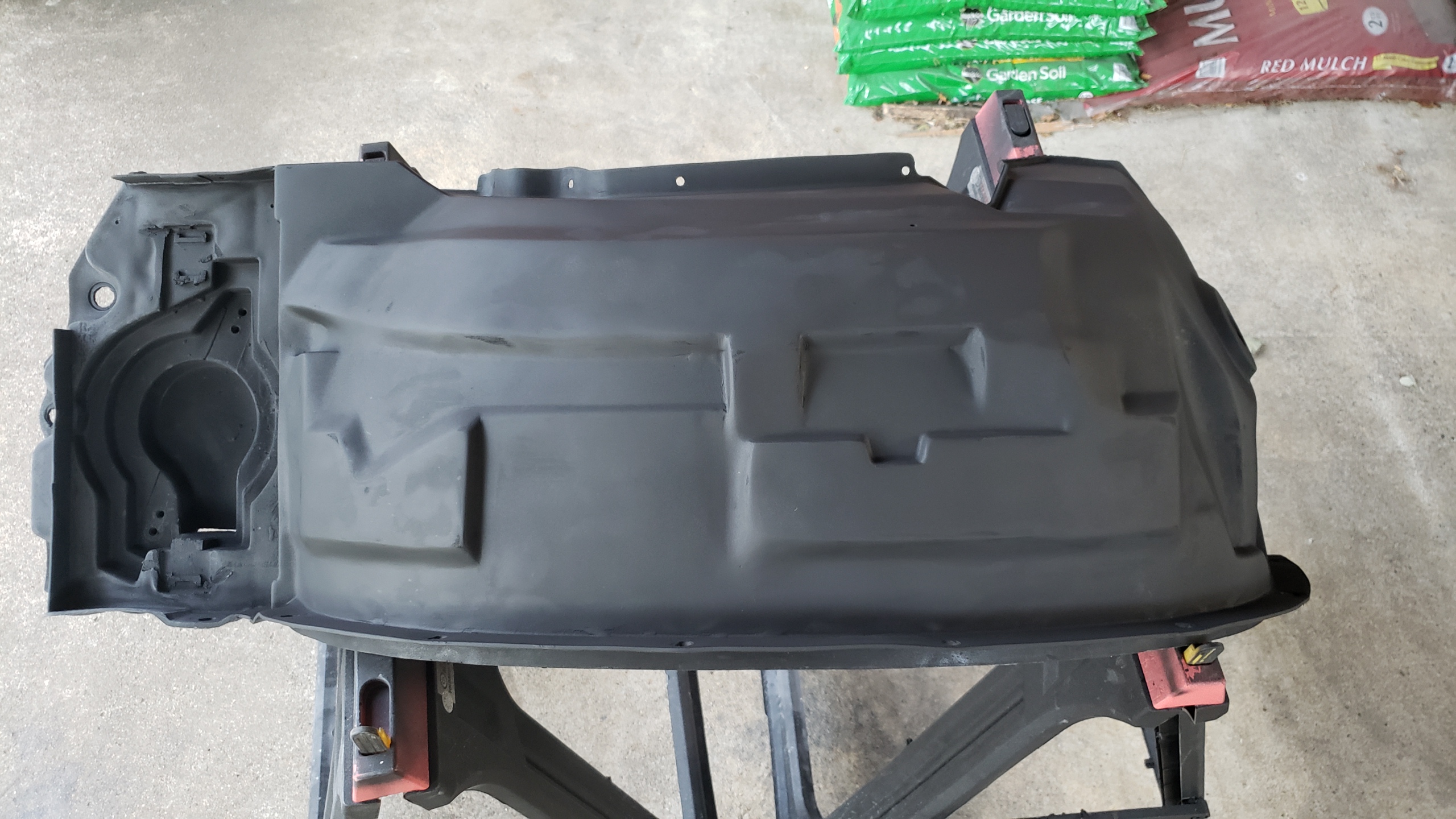

Those wheel wells look really nice, im going to have to keep that in mind when i go to do mine. Its the details that really make or break a build. I admit it seems that i put a lot of effort into a build but it never quite turns out as nice as i would hope. Probably from overlooking some of those little details. Nice job!
Been sanding away on the driver side wheelwell. Finished up sanding the bodywork earlier, and with a little daylight left I wiped it down with wax and grease remover after cleaning prior. Noticed I didn't have much high build primer left, but gave it a shot anyways. Managed to get one thin coat on and ran outta paint dangit! I'll pickup another can and try to finish priming tomorrow if time permits. Then back to sanding from 220 to 600.View attachment 124136
