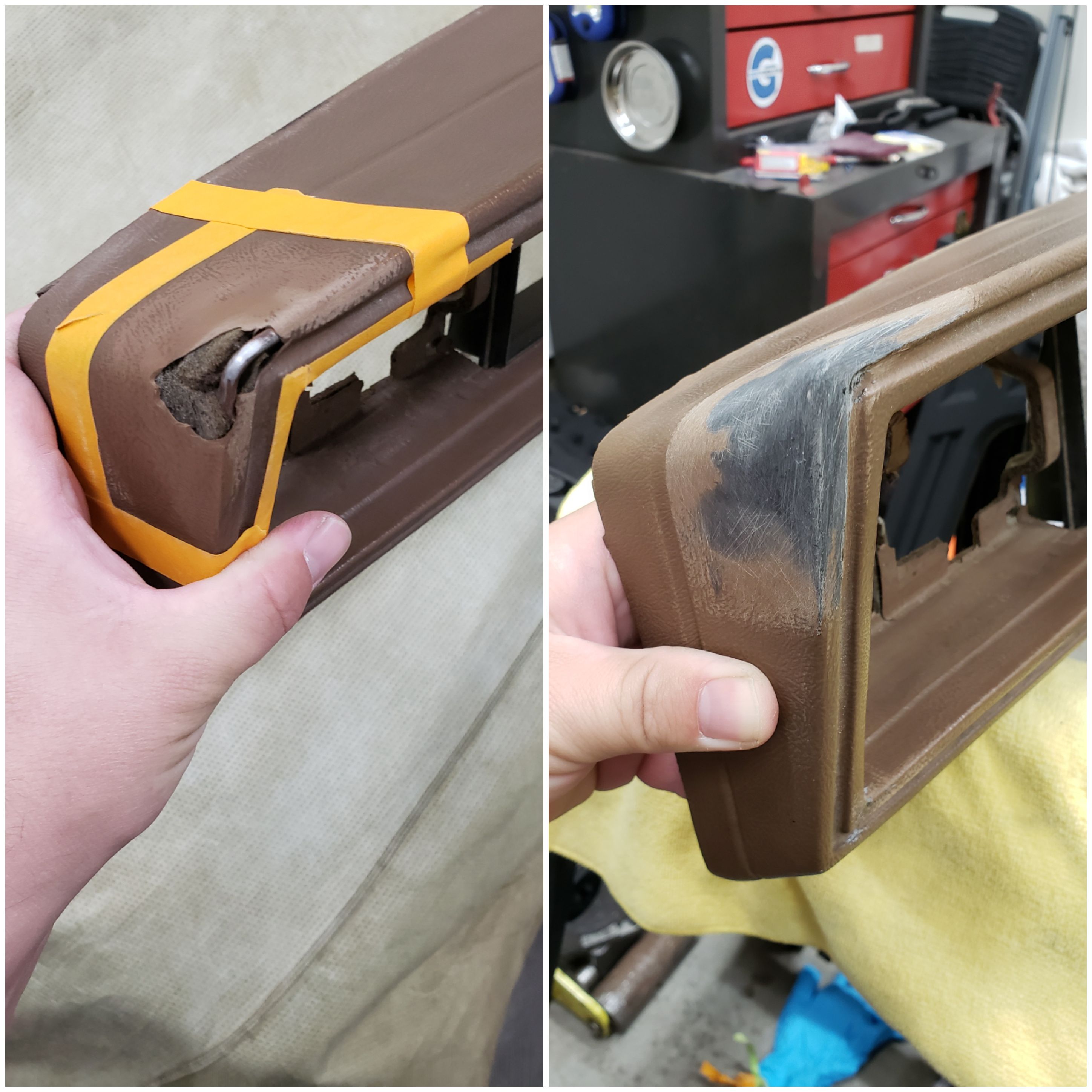

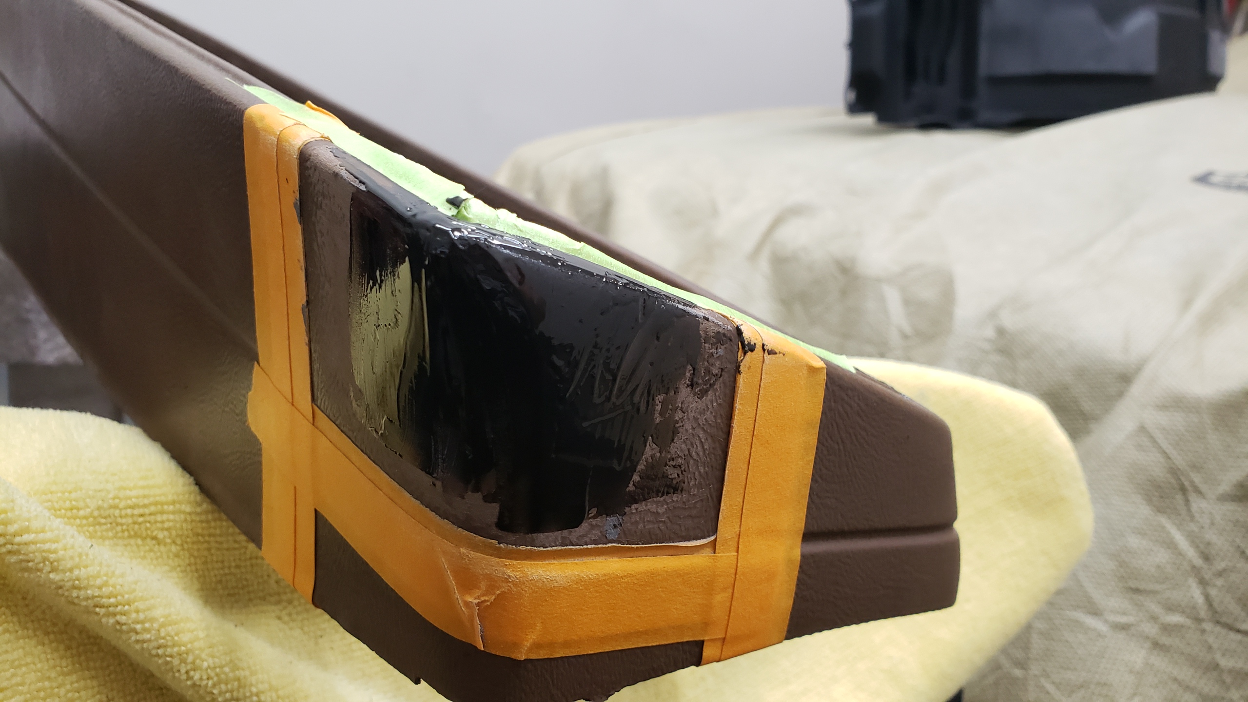

Been a decent few days. As most know I started the dash repair due to brittle cracking and such. The 3M bumper repair 2 part epoxy is legit for the job...shout out to Turna for sorta Guinea piggin it on his dash.
After several thin layers, block sanded with 80, I laid down another last night. I really was whooped, but Donovan helped motivate me to get it done a d I'm thankful for that. I let it cure until I got home earlier, then went to work again with 80, 180, and 220. It looks awesome in person, and I'll work on priming the area next. Here is a before/current to show the improvement....

I didn't even know a dash could be repaired like that.... Awesome work ! And once you get those skins for the seats I definitely have to know the costs involved
Me either years back. Yet again, this forum provided a good result. Turna used the same method on his dash, so I figured why the heck not! The first layer I laid down had mesh on top of it to help strengthen. Even if it doesn't come out perfect, it's gonna look 100x better than before! I have an idea for getting the grain texture back, but I'll wait until I can make it work or not to share the results.
