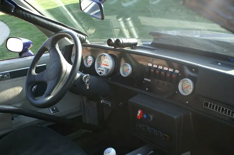

As far as fitting the tach in, I was thinking of doing something like this:View attachment 44123
I didnt need stainless, just knew they wont rust. I like that cluster idea that is pretty clean.
Your lines look good. I might still do them.
I'm definately gonna do something like that dash so I can fit my tach in there.
