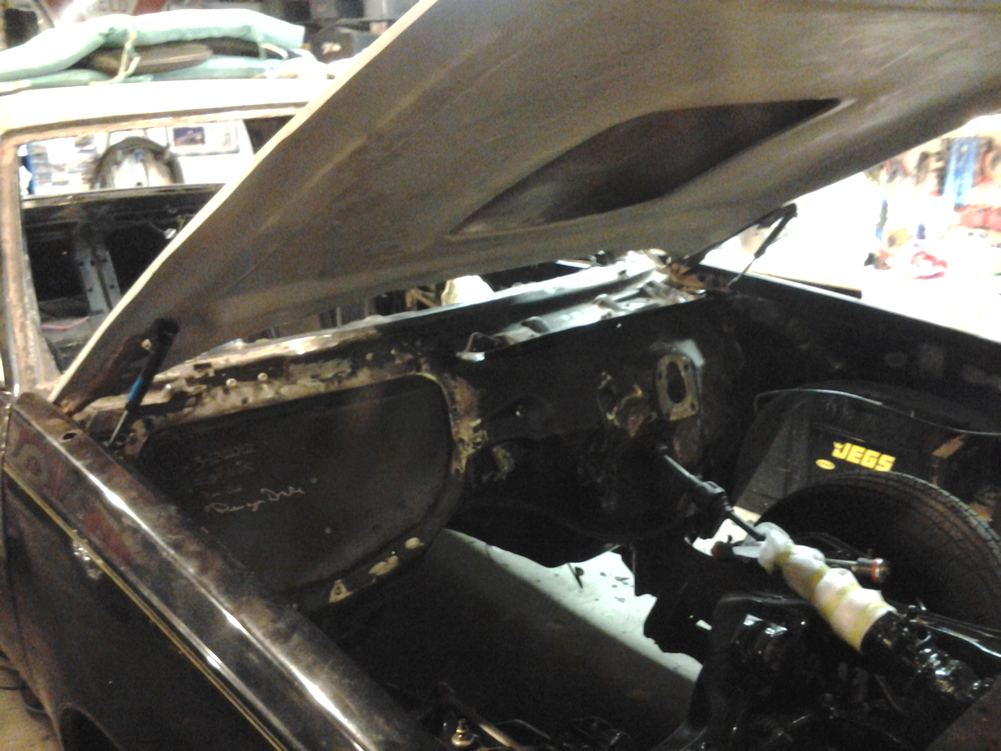

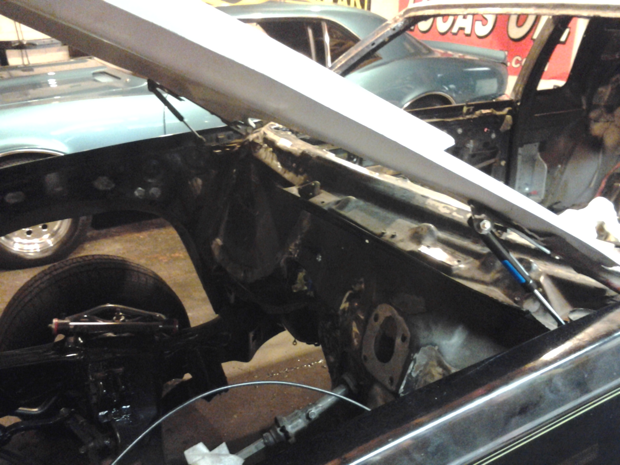

I should be outside stripping the trim to be repolished, but hell i work in the heat everyday and need a little inside time too! I've been going through old build pics and will start posting a few at a time.
I always disliked the factory hood hinges and wanted to go with a GN style strut setup instead. However, since the olds hood or inner fender doesn't have the provision for this i had to get creative. With the help of a malibu site, some simple measuring and the right parts i was able to make it work! My brother n law and myself took the separate strut mount from the regal style hinge and welded it to the main upper hinge, then got the right ball studs with metric threads and gas struts with the correct length, psi rating to work with a glass hood, and voila!! I think it looks way cleaner than factory springs and they work just as intended.

Land speed record gears, lol. Where is that hood from?
I got the hood from up22 out of California but i would not recommend them...the quality is not the best....there are alot of rough, unfinished edges that other brands take care of, no provision for a hood spring but Jim (liquid8) showed me a cheap solution for that. Damn bolt on glass hoods cost too much to buy another, too late to ship back for full refund so my bodyguy is doing his best to spruce it up!
I always disliked the factory hood hinges and wanted to go with a GN style strut setup instead. However, since the olds hood or inner fender doesn't have the provision for this i had to get creative. With the help of a malibu site, some simple measuring and the right parts i was able to make it work! My brother n law and myself took the separate strut mount from the regal style hinge and welded it to the main upper hinge, then got the right ball studs with metric threads and gas struts with the correct length, psi rating to work with a glass hood, and voila!! I think it looks way cleaner than factory springs and they work just as intended. View attachment 53142 View attachment 53143 View attachment 53144
Always been thankful that my Regal has struts, and they still hold the hood up! Yeah, it won't hold it up halfway but if you go over 3/4 to full it will stay open even in winter.
Sweet, i looked into getting some regal inner fenders but price was stupid when all i needed was the stud to mount the lower part of the strut and mine were in great shape. I tried making a bolt work and even bought some regal struts wrapped in carbon fiber but it just wouldn't work! I still have those struts brand new in the package if you know anybody that has a regal with a glass hood....they aren't strong enough for a steel hood.
Will do. And to add to the convo what was a pain in the *ss for me is that mine use those dumb little shoulder bolts that are a weird thread and are 30$ for four. And BOY do they break easily.
