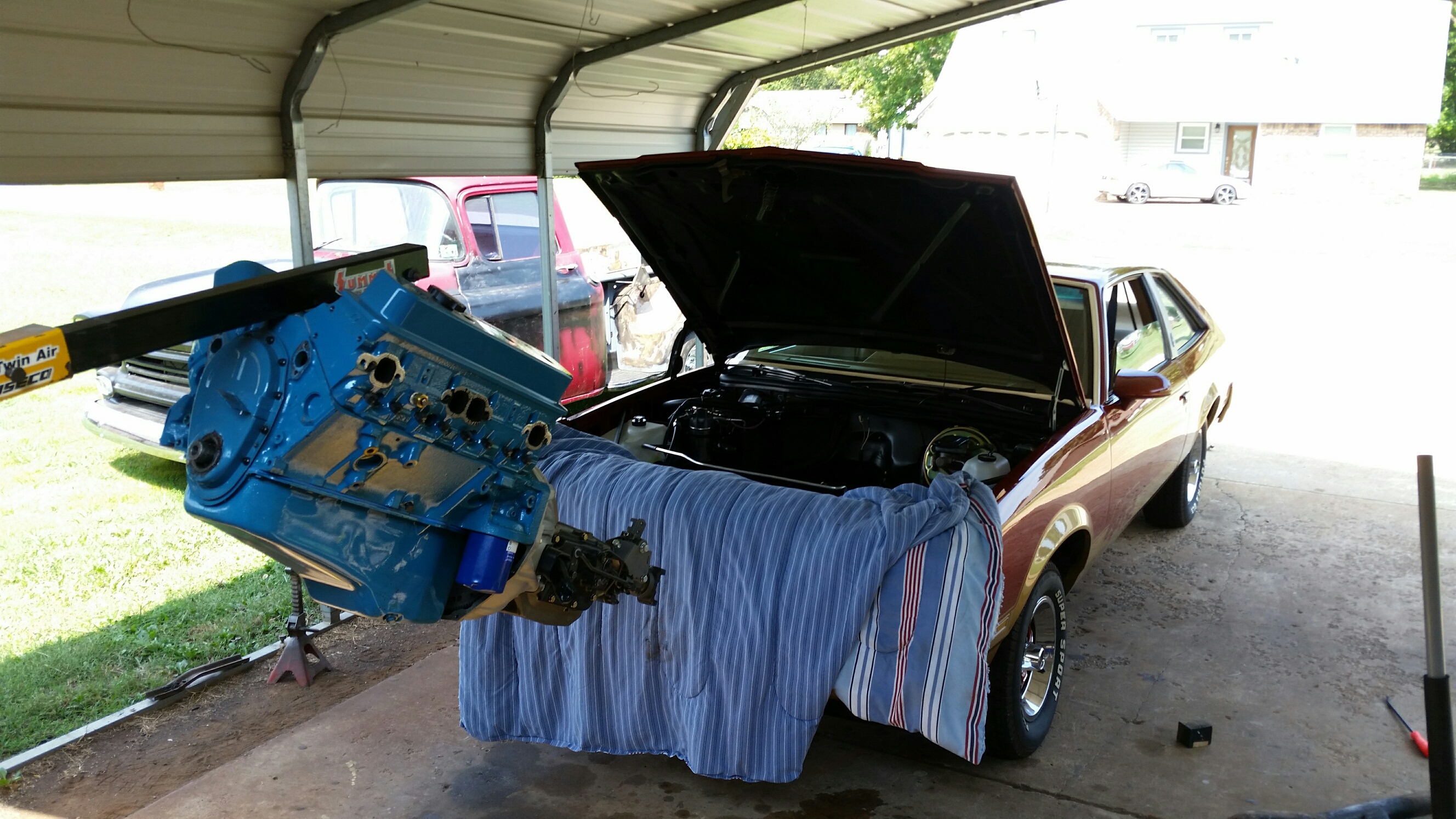

I got most of the top and front of engine torn down and found my intermittent overheating issues. The machine shop obviously did not get the rusty clumps out of the block. This is twice now with this engine. My thermostat was clotted up with it. The radiator is clotted and it looks, smells, and feels like oil traces in the coolant passages. The water is not milky though. So I think the rust clumps from this engine have clogged the radiator and performance thermostat. This engine will never go back into any of my vehicles. So whomever had the engine before me that ran straight water has ruined it. I'll have this engine out before noon. Then the El Camino engine is getting pulled. I tracked my new 4 row radiator and it's supposed to be here tomorrow

Out at 12:01. I have the trans and flywheel removed and the engine stripped of everything needed for the other engine. Eating lunch right now and the El Camino is getting pulled to the front. I'll have it removed in a few hours. My plan is to have the engine/trans in tomorrow by noon and hooked up

Here's the deal, I got the 350 from the El Camino, stripped down, cleaned, put in a new rear main seal, timing cover gasket, one piece oil pan gasket, balancer seal, painted blue, and just shot on some urethane high solids clear. That Goodwrench 350 from the El Camino is very clean inside. The cool part was it already had a pilot bushing and it looks new. The paint was flaking off the timing chain cover and oil pan. I used Aircraft stripper on them before the resealing and gasketing. I am beat down. Every muscle in my body is cramping and my arthritis is raging in my back and hands. I'm gonna whip this mother #$%^&* though, you watch 😵
