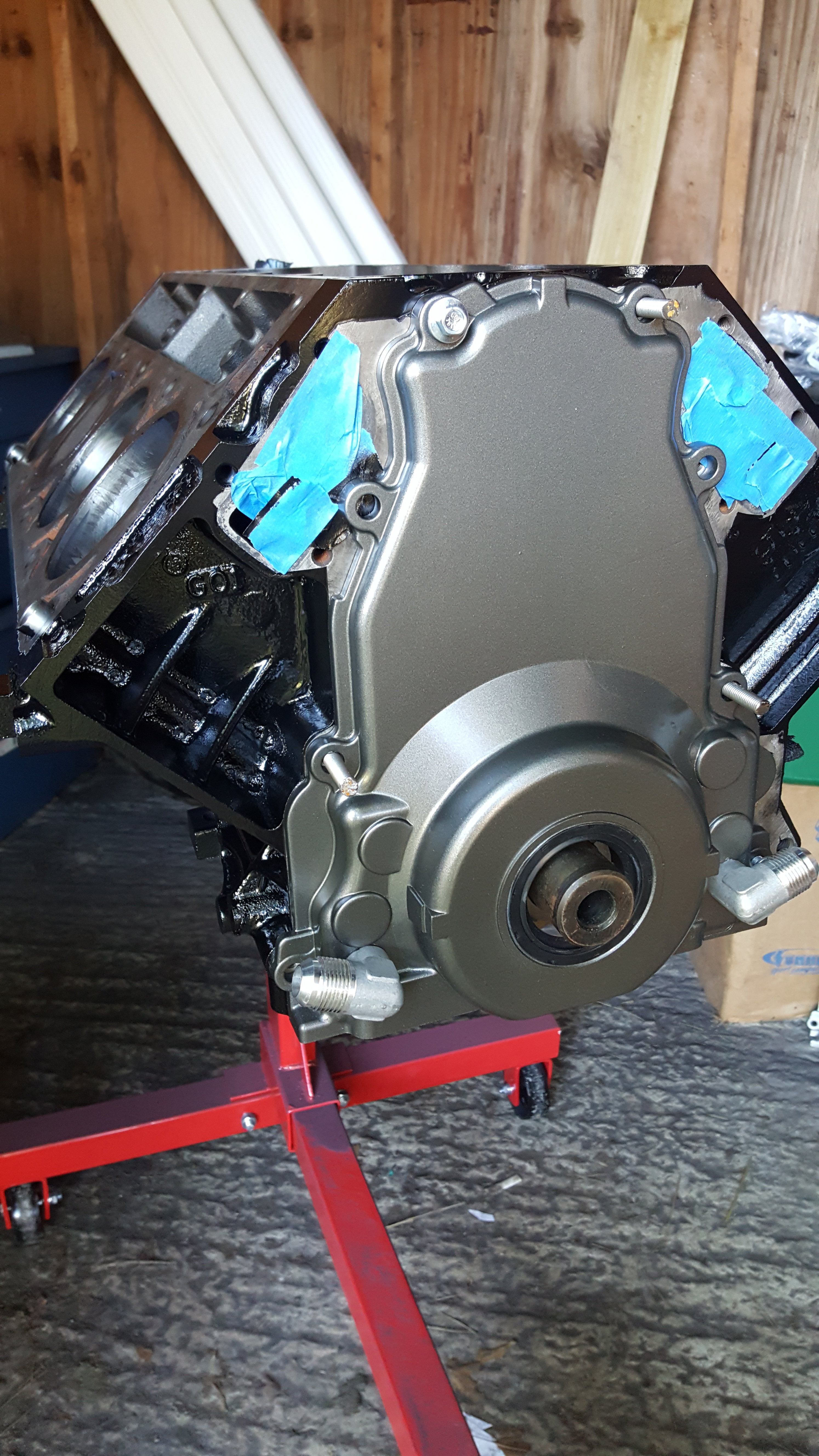

That's for sure Jack!!!! That's why i converted to this 5.3 to put in the cutlass. Jared...sorry in advance for the thread jack!
Jared,
You can't beat the new generation LS engines. They are an entirely different animal compared to the first generation small blocks. The beauty of those are that it's so easy to squeeze horsepower out of them. Let's face it, it's newer technology. They're much more efficient.
A friend of mine is helping a friend put a 5.3 into an '80's Caprice. When they pulled the heads off to do an inspection, he said there was not a single ridge present, plus the bores were completely round...and this is a 150,000 mile engine... Hard to beat. I'd be happy to have a 5.3 in my crate.
I agree Jack. They have a lot of inherent advantages. I didn't go with an LS in my for a few reasons. One being cost and the other being that I had already done an LS swap in Sean's car. Another being that I already have a warmed up LS in my daily driver. Finally, I wanted to build my car mostly like what I wanted at the end of high school. The car I couldn't have then. A G Body with a warmed up carbureted 350 and a five speed stick.
That's for sure Jack!!!! That's why i converted to this 5.3 to put in the cutlass. Jared...sorry in advance for the thread jack!View attachment 67440
No hijack here. Friends are welcome in this thread.
