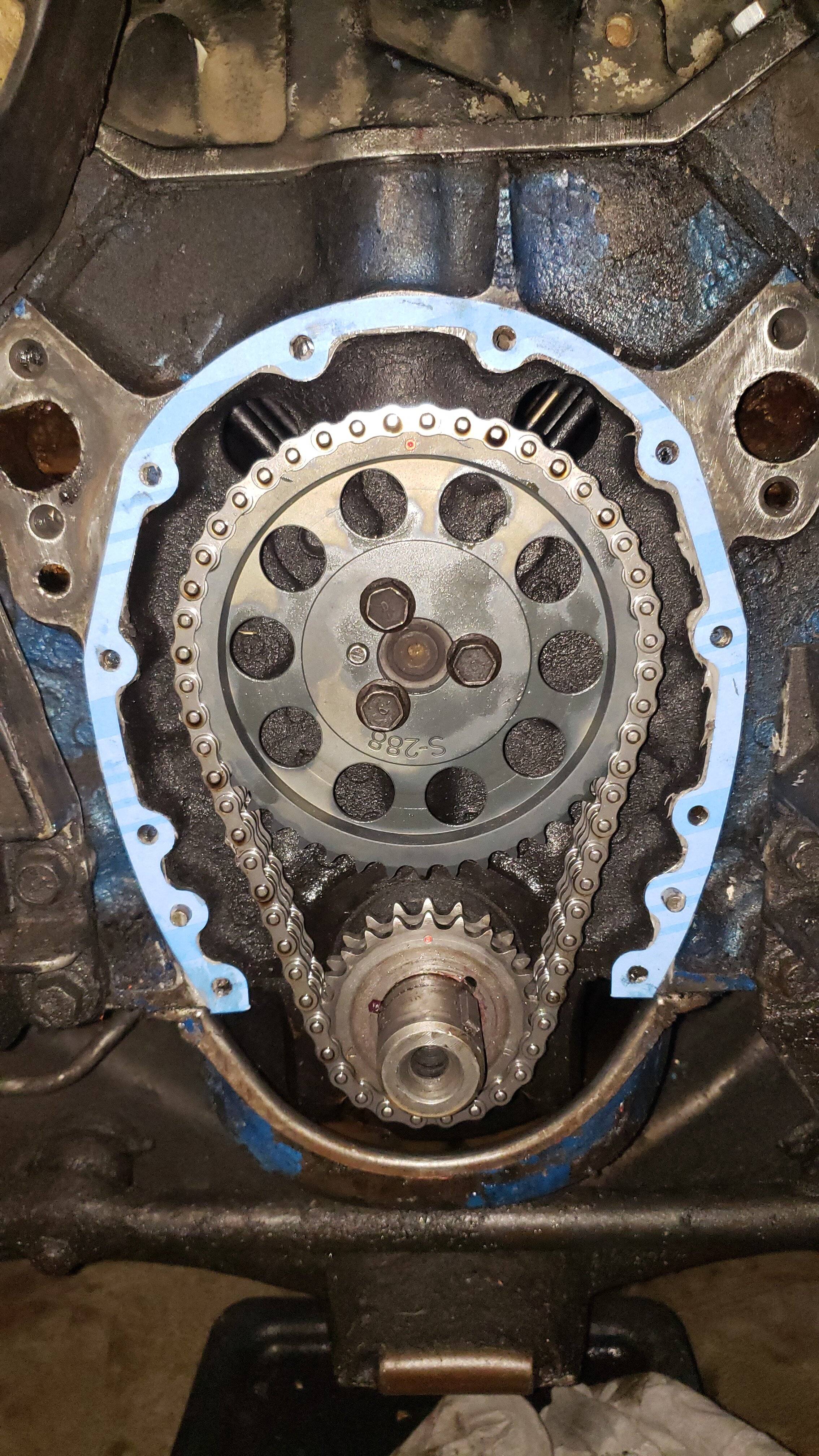

Ok, now it's almost been 24 hrs since the rubber gasket was glued to the timing cover.
Should be completely dry within a few hours (4:30)...
Ok, I know I asked about using silicone/RTV to "glue/stick" the timing cover/engine block gasket for ease of installing the timing cover.
What kind of RTV should I use ?
I have automotive black oil resistant and automotive red hi temp ?
Black RTV gasket stuff should be fine for sealing the tin to the block. Make sure to put some @ the area mentioned internally across the spot welded lip on the lower bottom of the cover. A nice clean thin bead spread w/your finger tip does it. Just smooth it over basically. You dont need an excessive amount.
Timing cover gasket is "glued" on with grey RTV that came with the timing cover gasket kit...
Waiting for it to dry for a couple of hours before I go and install the timing cover...

I would suggest double checking that. Based on what I’ve read on the sealer instructions the last time I put this stuff together you should assemble before it’s 100% cured. That way it flexes as you bolt on the cover and seals properly.

Black or red, honestly anything high temp.
Agreed x2.
At the minimum, sealant on & where it needs to be w/the hardware snugged into place so the 'seal' area is compressed to a nice flat surface. Then come back in a bit & tighten things to completion.
Prob works either way but that's how I usually do mine.

I hate to be the guy that brings this up but are you 10000% sure the leak was coming from the cover ? Reason I ask is the manifold gasket on the right side of the picture looks a little wet.
One of the reasons I suggested cleaning the entire front of that motor. Lots of 'wet' coverage there. Things need to be cleaned up as much as possible to help ID trouble spots.
