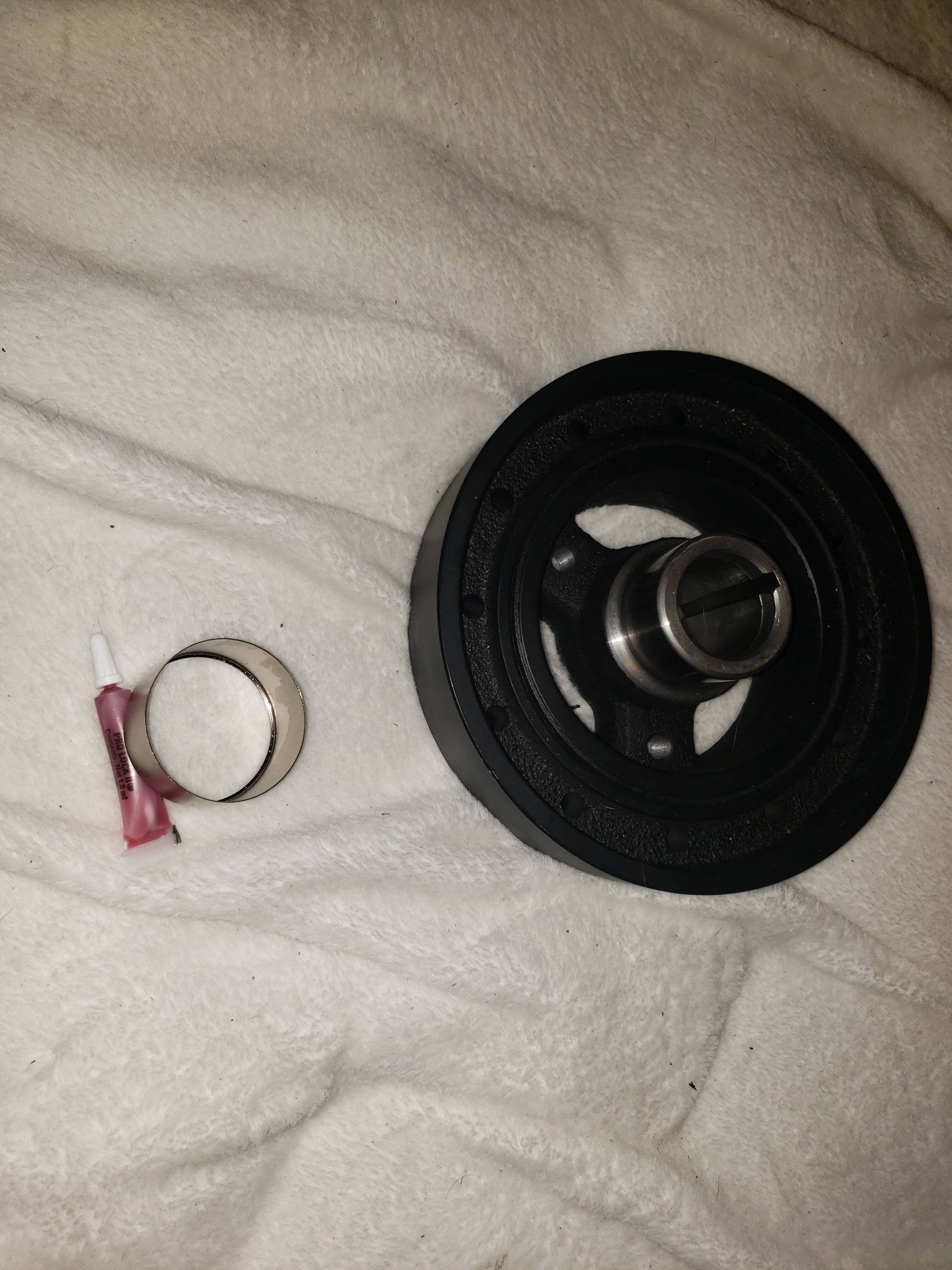

Harmonic Balancer Sleeve ... Needs to be pressed on...
Comes with lock tight so I know grease can't be used to lube it up.
Don't have a propane torch to heat it up and swell it...heard of an oven alternative though..
I have a hammer and a block of wood, is that good enough to get this sleeve on the harmonic balancer shaft ?

View attachment 192934View attachment 192935
Or because I have a new balancer, this "repair sleeve" isn't needed ?
Why do you need a repair sleeve for the balancer ? You have a new cover with a new seal. Didnt you buy a new balancer ? You put a little grease in the balancer so when it gets pressed back into the cover it wont screw up the seal on the cover. Use anti seize on the balancer bolt and torque it to 60-65 ft lbs
It came with the timing cover gasket kit, I didn't know what it was...
But now I'm reading it's a "repair sleeve" for old balancers being reused with worn grooves...
Just getting clarity of what it was used for and how to put it on if need be.
If you have a new balancer you don't need the repair sleeve it's only needed if you are using your old harmonic balancer and it has a groove worn into it from the timing cover seal
