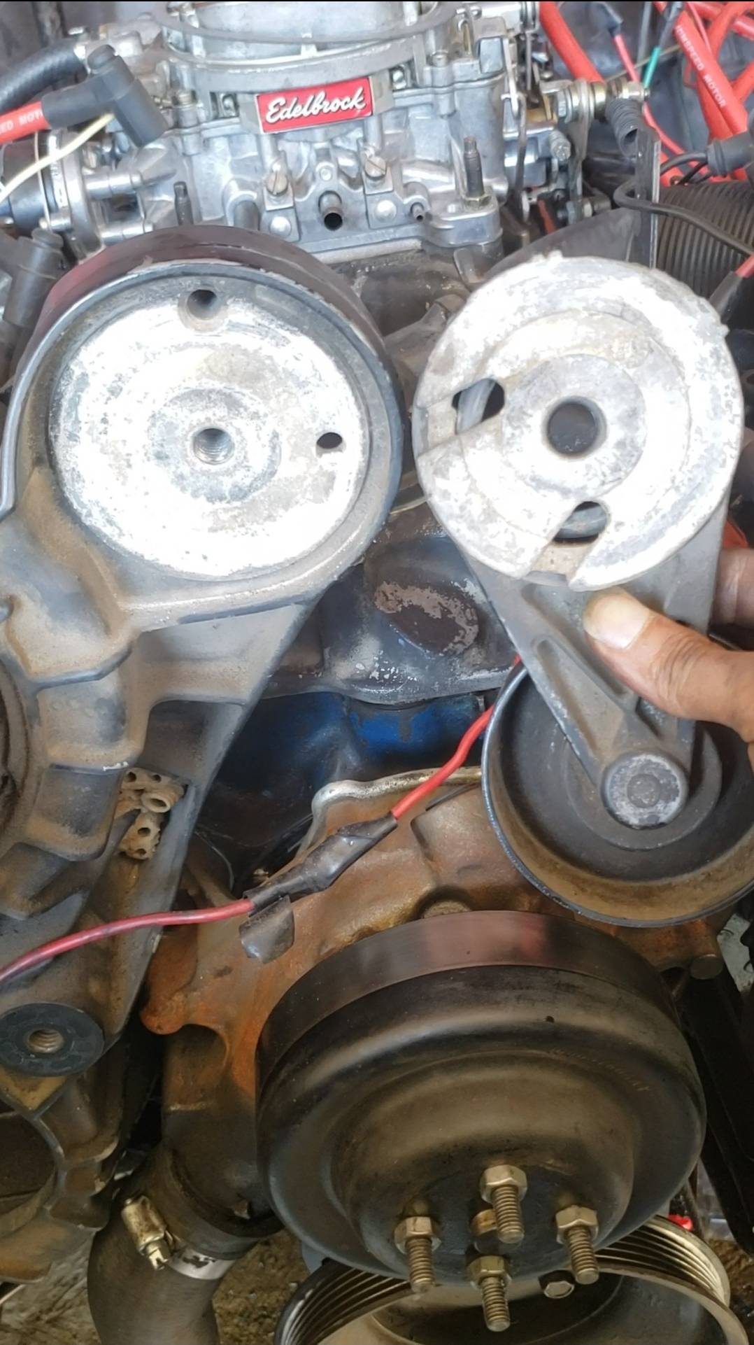

Red Arrow in photo below.
Looking at your pictures a few pages back the brackets for the serpentine set up are in those holes in the front of the engine.
The point of attachment you had on the fuel pump block off plate is perfectly fine, Just make sure there the cable end and the block off plate are free of paint.

I don't remember breaking that when I took it off...
How was it working with the dowel pin broke ?
Doesn’t matter, to be honest really you can use a different belt and not use the tensioner.
