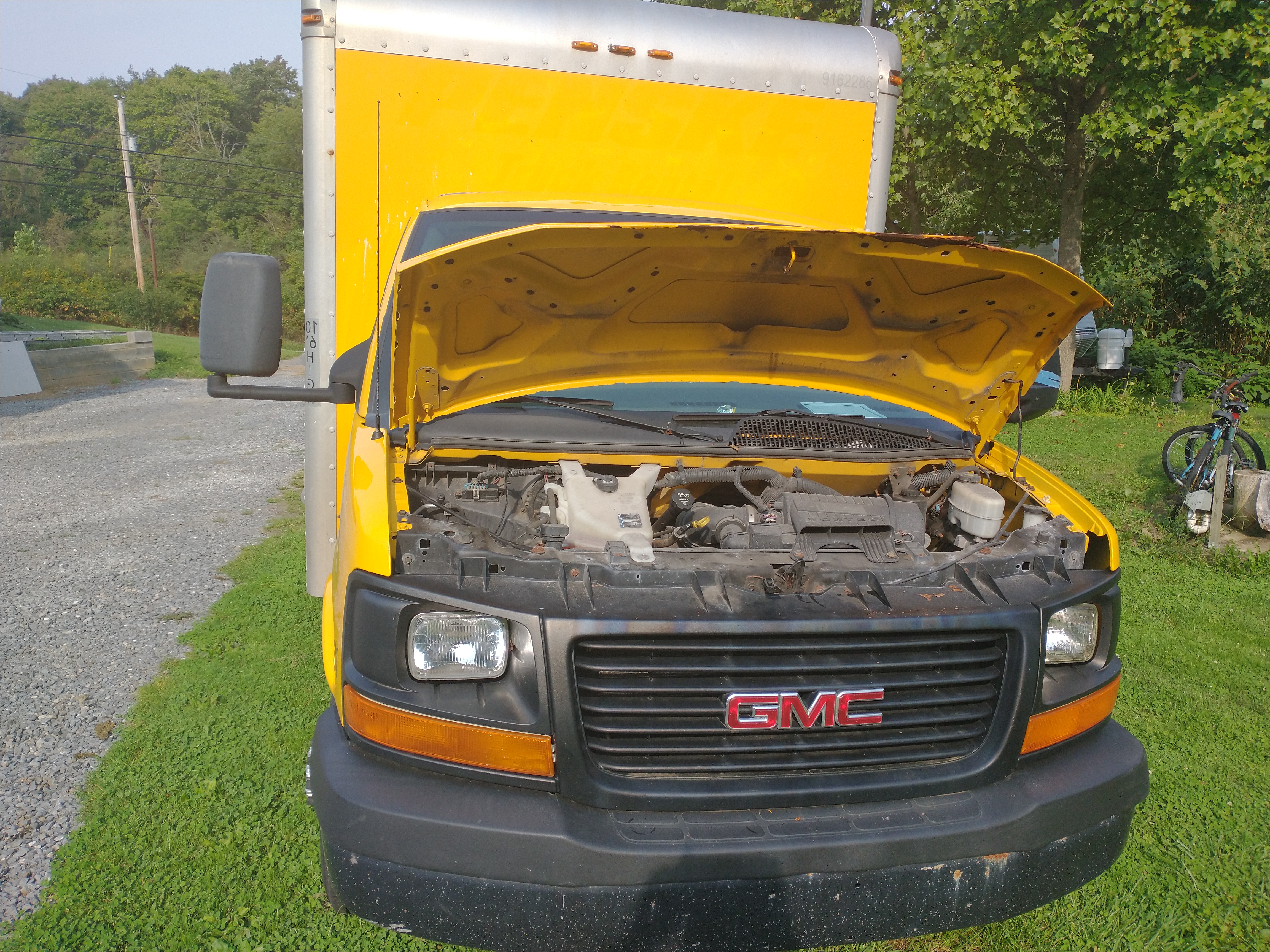

On the Donor did you pull the whole rad support out? I'm pulling a 6.0/4l80 from one of our old service trucks at work but I'm trying to avoid pulling the whole front off.

If it is an express/Savana, I don't see any easy way to remove the engine. The biggest problem is that the engine sits under the firewall.
Before:
There is barely room for a cherry picker under the firewall. I cut the firewall to make room.
You can see what I removed to get it out. It'll make you work for it.

That’s how we always did them when pulled unit. I just never tried pulling them separate. I work on it in between jobs. Hopefully have it out by Friday.
