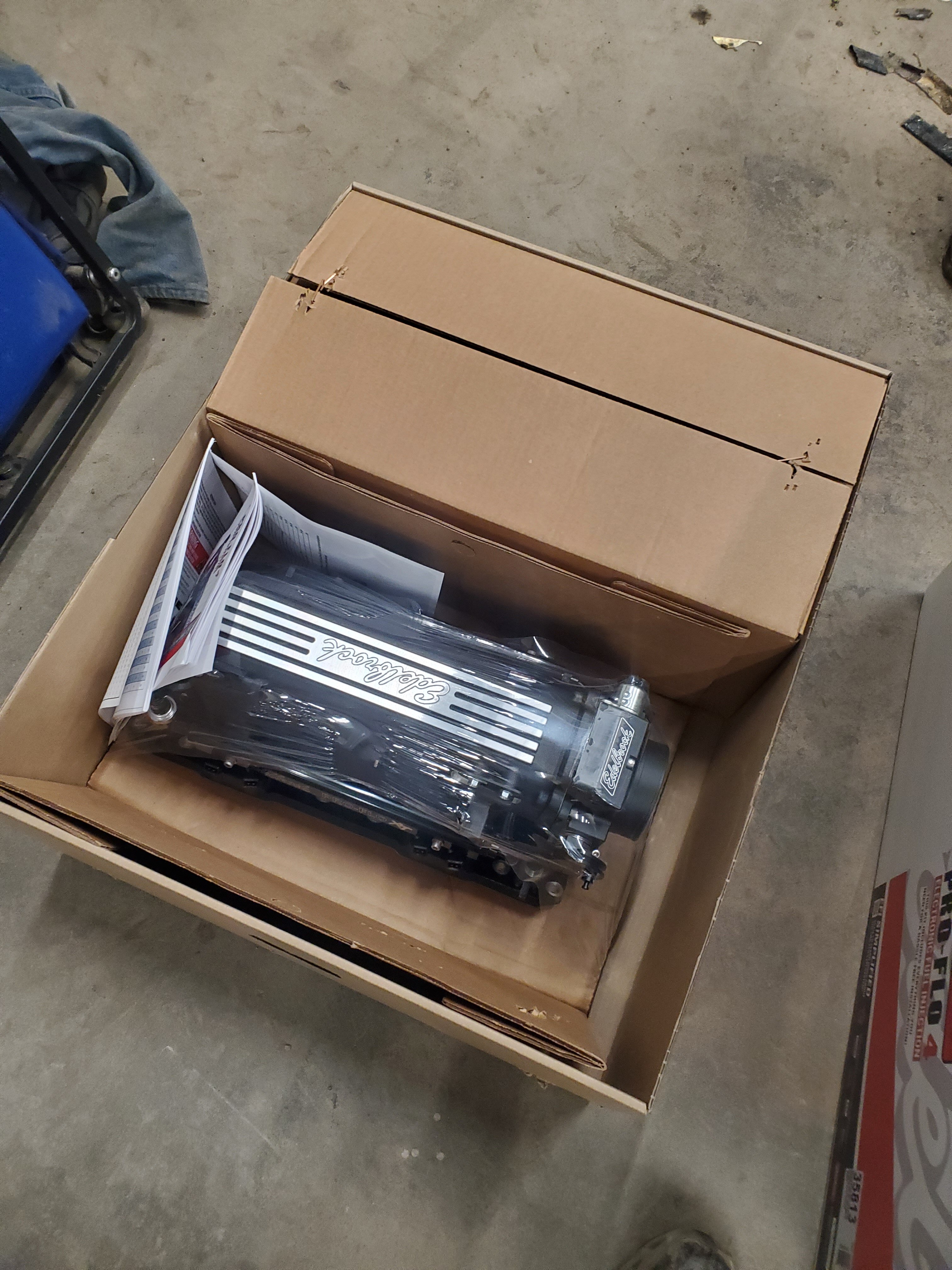

Been watching for months and the price dipped so I finally got it

Hell yeah. You gonna tuck it under a stock hood?

Yea they're not really that tall. Had a knock off one same dimensions in my cutlass sbc before I switched to single plane with a Victor Jr. AND 1" spacer on both. The rpm air gap is really not taller than a regular high rise dual plane. The bottom of the intake V's in to the lifter valley so sitting on a flat surface it appears way taller than a regular intake sitting flat on the exhaust xover. Mounted on the engine though I think it may be .25" taller or so at the carb mounting base. Either way I use a drop base filter with a 3" element and filter top so all good. On my cutlass I had to modify the filter base to fit the float adjustments on the holley carb but that was without the .25" filter riser with the Victor Jr. and 1" spacer. I'll try and get some comparison pics.
