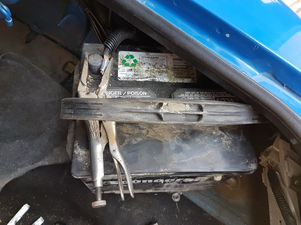

After check out and walk the 25 feet from from the door to my car and I notice the trunk is popped... not good. I put my parts in the trunk and notice my battery has been stolen. My 4.5 year old, $89 new, probably worth about $25, now battry. ****ing ghetto hoodrats. Don't they know people get shot in Texas for crap like that?
My AAA card in my wallet expired May 26 and I didn't have the new one. I see the store manager coming out the front door and ask if there is a security camera. He says yes and no. There is security camera on the roof of the store and it is pointing directly at my car..but its fake... nice. He tells me to go inside and see if he has a battery on the shelf that will work. I grab the smallest one.
I carry the battery out to the car and notice they ripped the battery out of the car, taking most of the positive terminal with them. Great.
I dig in my tool bag (good thing I took the whole bag in the yard) and find some vice grips and clamp the cable to the post:
I laid the spare tire up against the battery as my new hold down, the miata started on the first crank and I GTFO the hood as quickly as 1.6L would allow.
Instead of cleaning the 2+2, I spent 3 hours making new hold down brackets that work with my new, 2" larger battery and I made the miata style hold down fake. The battery is now held in place with GM style Toe clamps (that are hidden under the Miata style straps).
Good luck stealing this one, F-ing hoodrats.

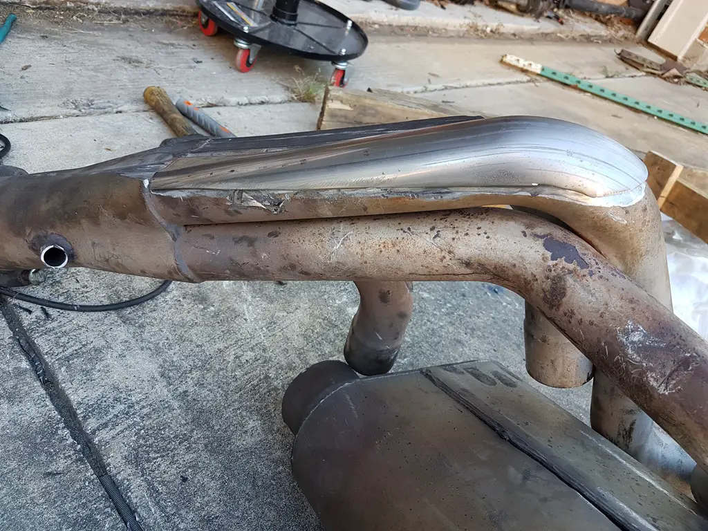

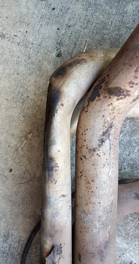

Last week I bought the $75 Harbor Freight 3 ton jack and today I put it to the ultimate test... can you take off the passenger side Hooker Super Comp big block big header on a 502 with a wide sump road racing pan with a $75 jack?
The answer is yes. You have to take out the starter, of course, but if you get the car high enough, the header rotates 180 degrees and magically comes out.

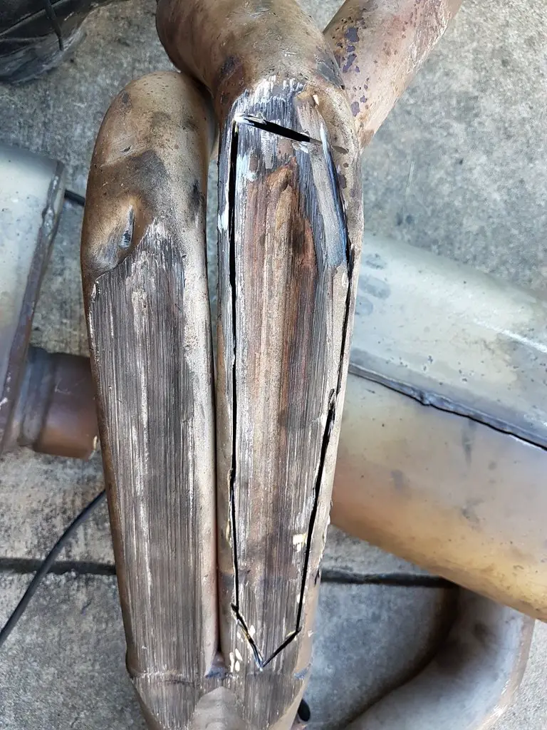

The reason the header had to come out was years of jumping paved over prehistoric sand dunes @145 mph in the Nebraska sandhills has taken its toll on my headers and the 2" pipes are crushed down to about 1" and I need to patch them and put on a skid plate - the old skid plate we welded on years ago is long gone.
I cut out the flats ...
And then opened them up and cleaned up and removed the external aluminide coating in the weld areas.

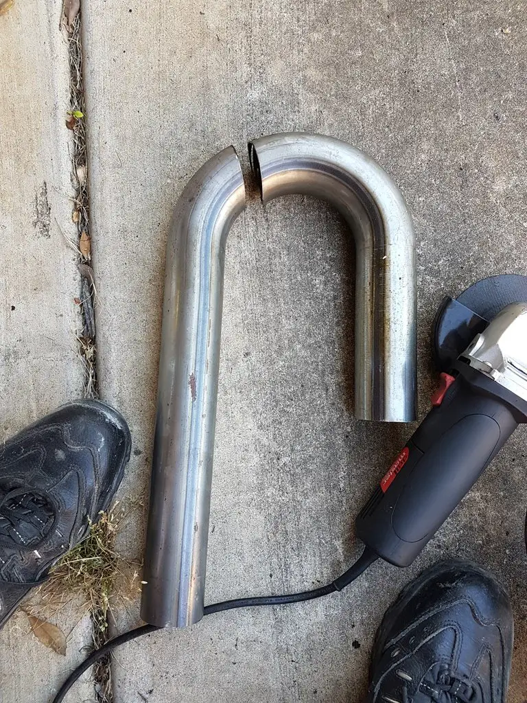

Summit has 2" mandrel bends for about $15, So I ordered some for patch material.
View attachment 68239 View attachment 68240 View attachment 68241

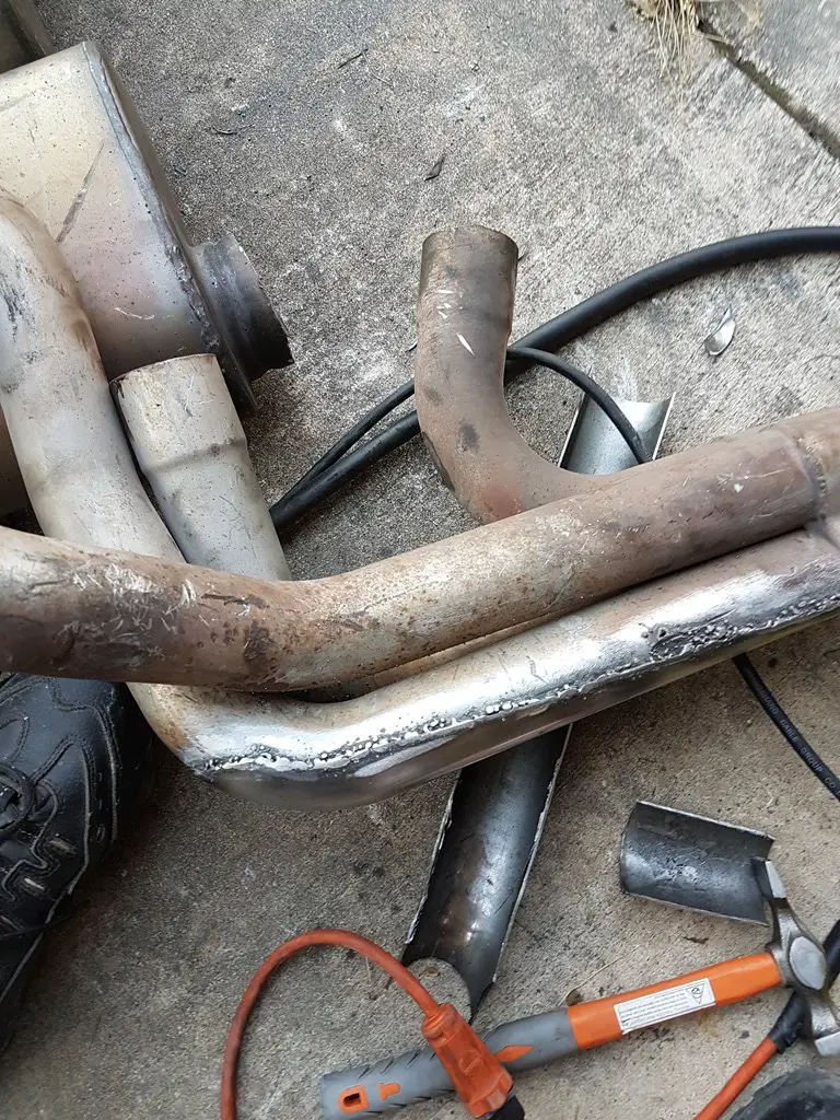

Then I fit it and welded it into place with my $89 Harbor freight mig welder:
Now I have to do the other tube and put on skid plate doublers while I wait for the new mufflers to arrive from Summit.
