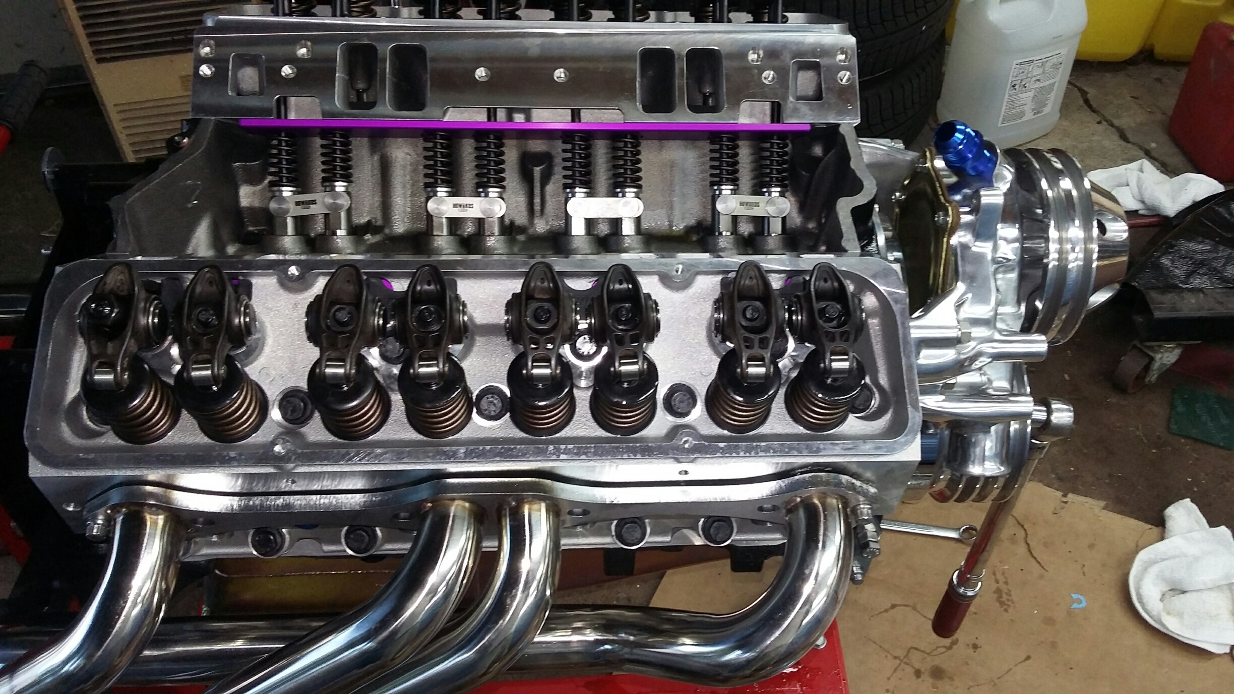

I installed the rev kit in the 355 and test fit the headers for spark plug and wire clearance.
Guess I'm dumb. What's a "rev kit"?
The "rev kit" is designed to increase engine RPM and prolong roller tappet bearing life by pre-loading the roller tappets to the cam lobe
The pre-load springs are held in place by lightweight aluminum retaining bars (purple) which install beneath the cylinder head and has aluminum spring cups that sit on top of the lifter.
Rev kits also keep the lifters in the their bore in case of a failure which is the main reason I installed it plus I already had the kit sitting here from a previous project.
I learned something new. Thanks for taking the time to explain that. Engine looks great, by the way.
