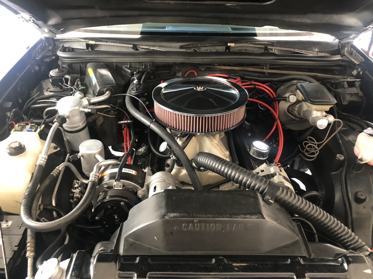

Got the AC working today for the first time in 20 years! Air conditioning is my favorite invention of all time and I didn’t feel like sweating on those original velour seats! Went smoother than I thought, thanks in part to a lot of help and info from this forum! Converting to 134a and some rewiring, and it blows ice cold now.
i thought I’d have trouble with the idle dropping too low when the compressor kicked in (running a Holley 4150), but it barely dropped 100 rpm. I heard of way worse.
im sure you could still rig up a qjet idle kickup solenoid.

Does the Quadrajet Solenoid work differently than the Holley Solenoid?
We have a Holley solenoid on Dad's Galaxie. It isn't strong enough to push the idle up itself but if you roll off the throttle while it is engaged, it doesn't let the throttle return to idle. I'm not sure how the Q-jet solenoid works. My car doesn't run yet but the solenoid on my carb is a stock Q-jet peice. My carb is from a truck but was custom built/tuned for my combination.
