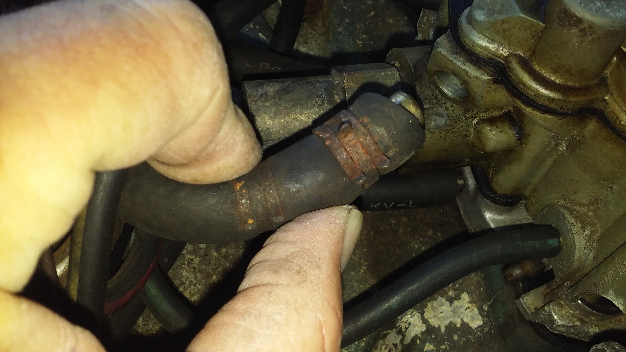

Found my vacuum leak.
Last year, on the day we put it away into winter storage it started running bad. Low power, put your foot in it to go up a hill and it'd die, sometimes even stall out.
Pretty sure I knew what it was, and had all winter to think about it.
So, I confirmed my suspicions this morning after driving it 20 miles to get the new inspection sticker
Hose fitting to the charcoal canister line had pulled out of the carb body.
That sucked😉
Is there supposed to be vacuum at the bowl vent?

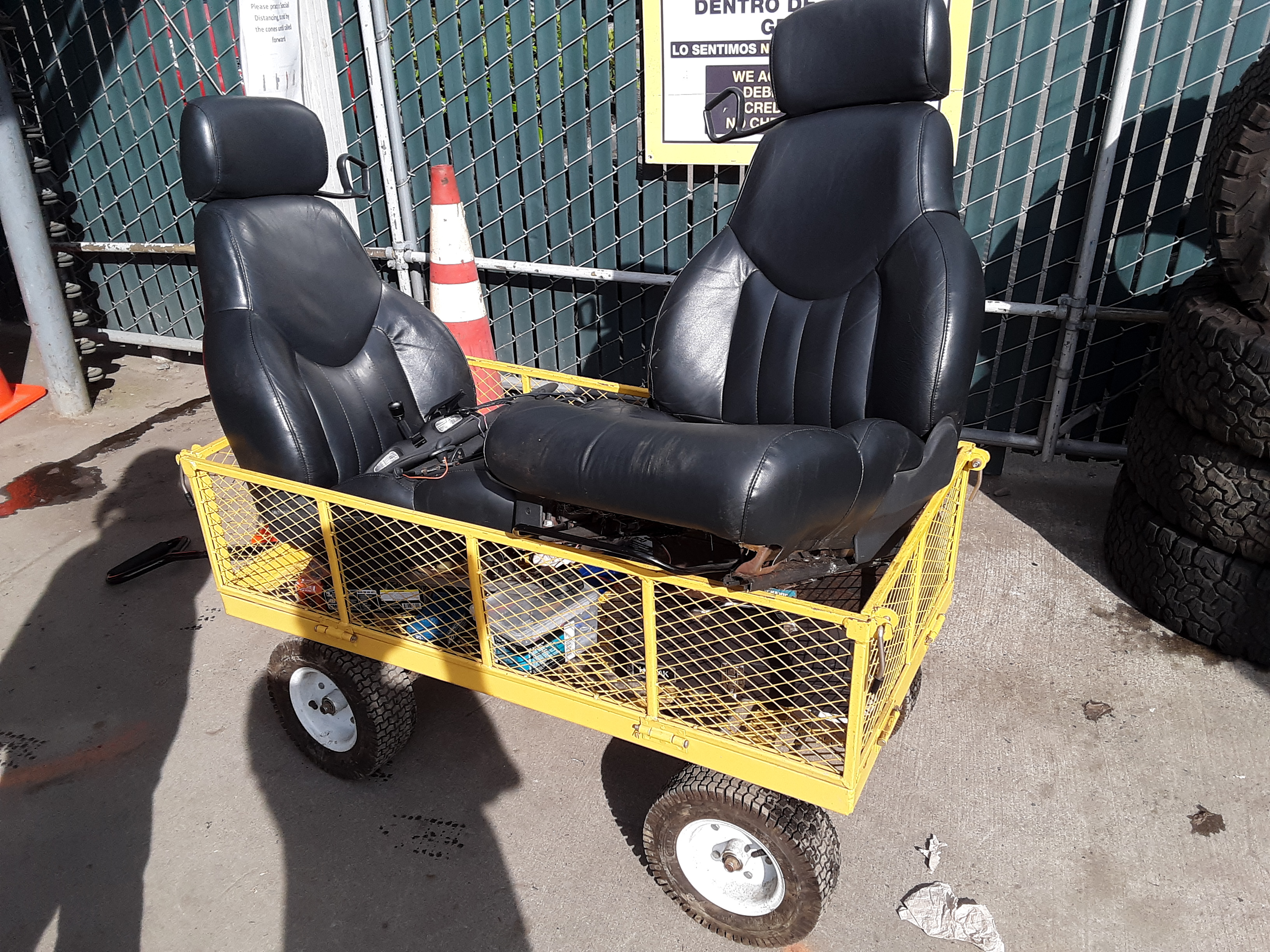

Spent the day at the JY looking for useful upgrade items. Picked up 2 pr of power mirror motors. First pair from a Buick LaSaber, the second pair from a Cadillac which also has mirror heat.
The mirror motors only cost $5.49 pr.
My next score is a very nice pair of bucket seats (driver side w/power) in an acceptable dark gray color (the rest of my interior is black), from a '97 Cutlass. Before leaving the Cutlass, I also got the lighted/mirrored sunvisors, dome light w/maplights, rearview mirror w/reading lights, and the SPDT rocker switch for the sun/moon roof (just because I like switches).
The Cutlass parts cost me a total of $160.12 tax included.
I am a happy man today!!!
