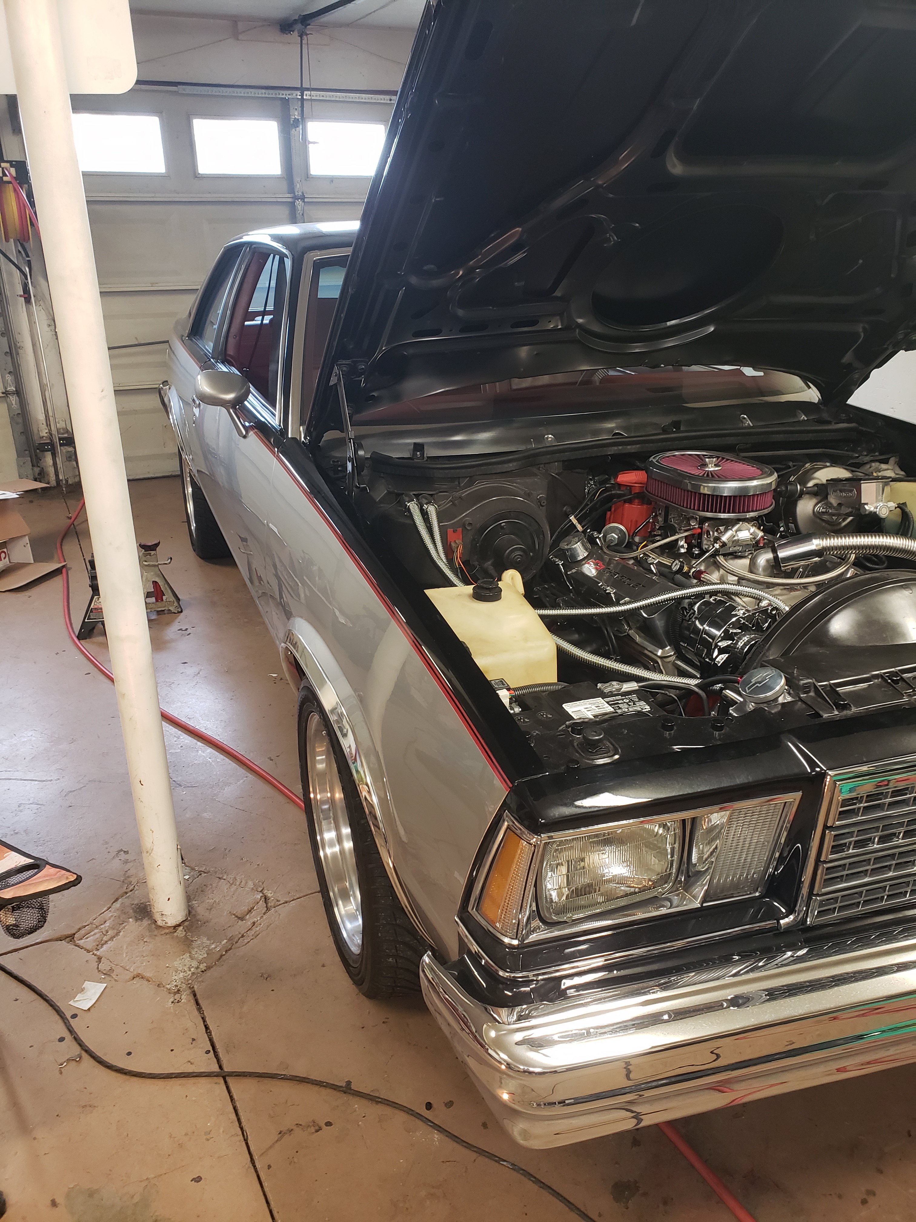

Got the TV cable changed, crossmember reattached, linkage hooked up, 4th gear pressure switch attached, reinstalled and retimed distributor, changed carburetor base gasket for higher quality one, and have been idling it in gear while feeding it ATF like it is going out of style.
I still need to fiddle with the linkages to get the throttle to return to idle easier and a band clamp for the cut in the exhaust, but it is just about ready for a spin.
Said screw the neighbors and took the car for a spin, open exhaust and all. I have all 4 gears and they seem to work correctly. I haven't got the torque converter lockup connected yet, but I have all the parts ready. I will definitely be driving with the GPS speedometer for a while as the speedometer is way off.
The only weird thing is the shifter linkage is not using the full range of the column shifter. Park is in the correct spot, but Drive is showing between R and N on the column display and L1 is showing between D and 2. I always thought that when doing this conversion, everything lined up normally but you didn't have enough shifter throw to access L1. Perhaps the Cadillac shifter arm on the transmission is shorter than a regular one?
I am almost wondering if I want to hook up the lockup at all, since with the 2.41 rear ratio and the 0.67 overdrive ratio, I will end up doing about 1200 RPM at 60 MPH. This engine has torque for days, but that is a little bit much.
